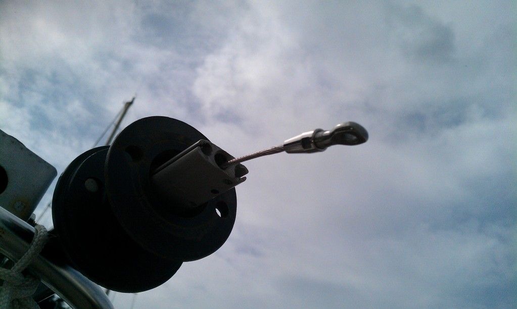

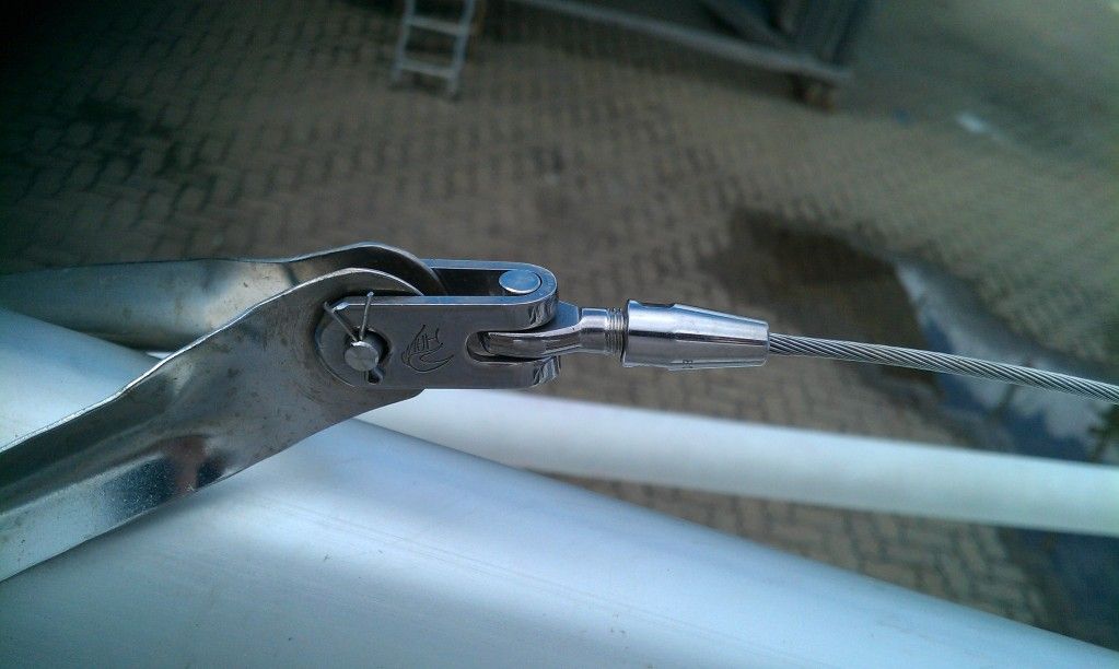

Ok, as promised some pictures and info on the swageless fittings.
I've used 3mm 1x19 316 grade stainless steel wire and the 3mm swageless fittings by Petersen (Hi-Mod). I've never swaged nor have I done any standing rigging before. I have no access to swaging tools. I choose Hi-Mod because a) they were the best priced b)they are made in this country and are not some cheap Chinese import c) they at least in theory are 100 % re-usable d) they do not need sealing with silicone e) because I read some good reviews in other sailing forums and f) ... probably the most important ... they actually make all the fittings that I needed for 3 mm wire.
On the mast end my headstay was fixed with a bolt through a thimble. CDI (and some on this forum) do not recommend this. I've now changed this as per the CDI manual to a toggle fitting.
The other end of the stay terminates in an eye fitting. This will connect on to the fork of the bottle screw inside my furling cup.
The swageless terminals themselves do not fit through the luff extrusion. So I first connected one terminal onto the wire, pushed the wire through the luff extrusion and then fixed the other terminal. The furling drum itself then will be fixed with another toggle.

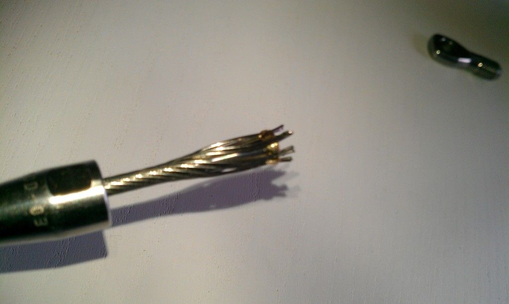

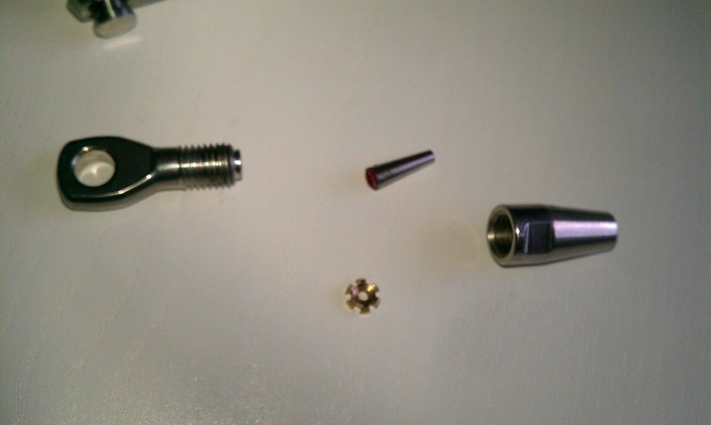

Now about the swageless fittings:
I've followed basically the instructions by Hi-Mod on the Hayn link : http://www.youtube.com/watch?v=sb4swA3xguQ
Now, my wire is much smaller and my fingers felt sooo much more like sausages when I fitted these. Look at how small the cone and crown are here :
Took me a while to get the idea :| ... The pictures I've got here are btw from when I started assembling my second forestay at home.

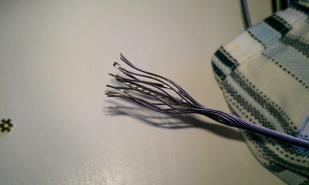

So you untwist the strands of the wire and the fix the cone and crown over it:
Close the fitting, twist the strands together at the same time. You will then have to fiddle a pair of strands into each of the notches of the crown - ehm did I mention this was very fiddly :cry:
Close everything together, open it up and when you are 100 % sure everything is ok put some thread lock onto the thread of the fitting and NOT inside the fitting (cause you won't be able to undo it ... taught myself a lesson there). Petersen states not to overtighten the fittings.
The end product looks good, can be opened up, inspected and re-used.

When I went on my 3 year cruise from Cape Cod thru the Carribean on my Alberg 35. I upgraded all standing rigging . one wire size greater, Stay-Lock connections that is much like yours or Norseman. Rail down 35-80 degrees in 40 ft. seas for 3 days proves there strength.
Best advantage is you can change fittings at sea. (I didn't have to)
Your toggle connection at head looks good but a rotating pin would be much better, have the same at lower.(The pin and Eye will wear if you are a down to the Rail type)

DaveB wrote:Your toggle connection at head looks good but a rotating pin would be much better, have the same at lower.(The pin and Eye will wear if you are a down to the Rail type)
Thanks Dave, I'll see to that !
