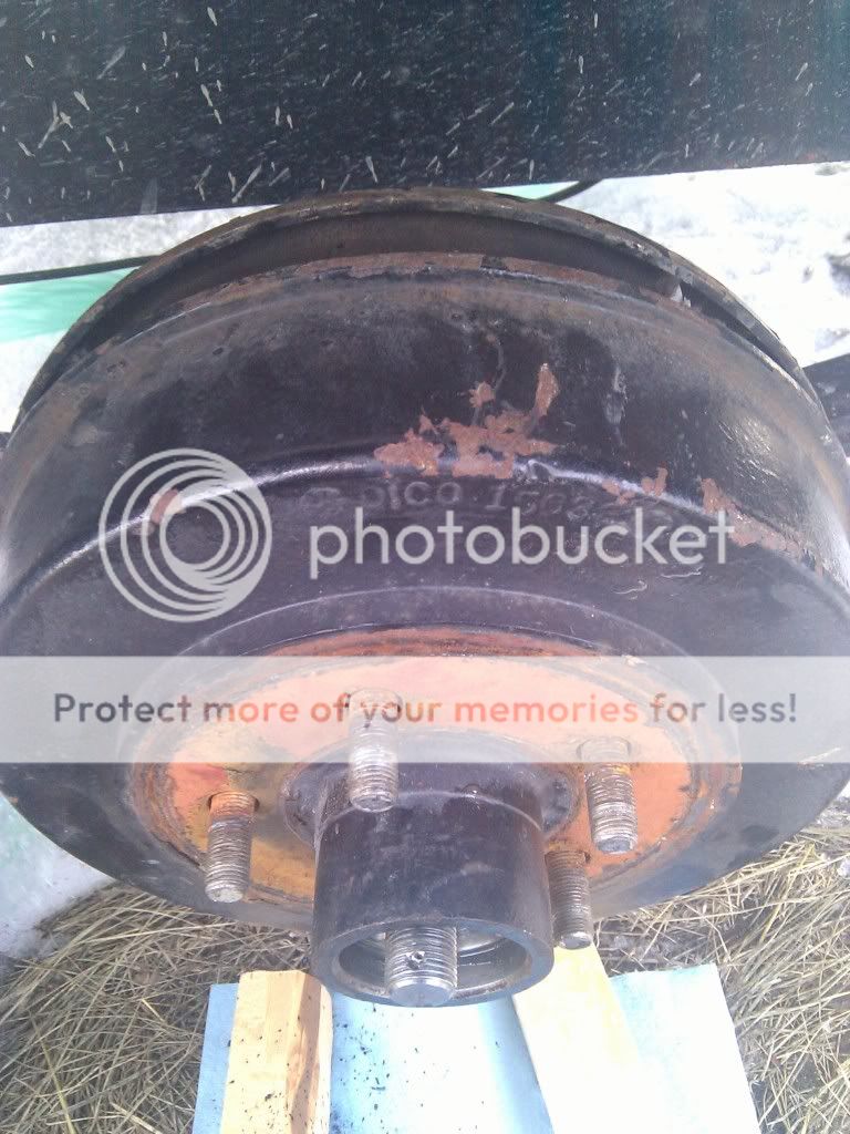

okay first to post some photos
1)
2)
3)
hopefully you can see how the drum is partially off, and the nuts at the rear.

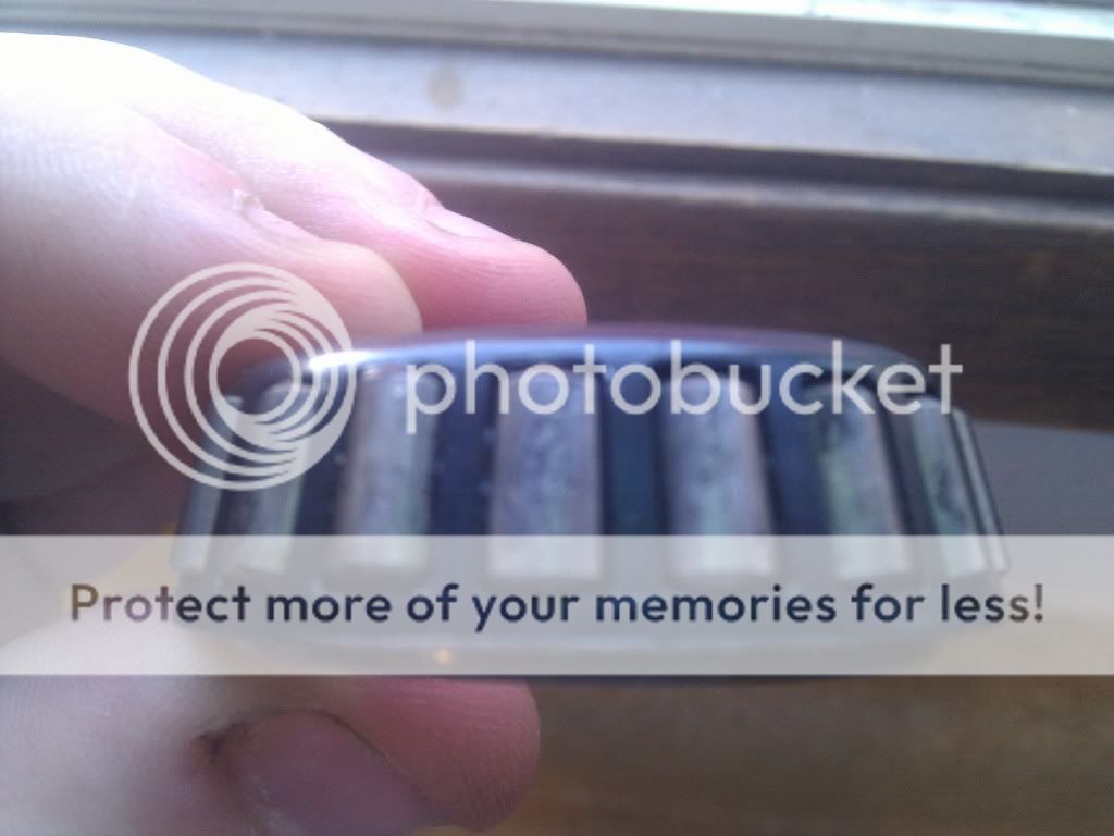

2) I think my bearings are shot, my first look at them , they appeared to have some stress cracks, and fatigue. Assuming I need to replace them. Can anyone tell me, or link a part number or something for the replacement bearing? As mentioned above, I do plan to switch over to disk brakes, I still need the bearing though right, the disk brake assembly will not have them?

If the drum isn't coming off, check to see that the shoes aren't tilting and binding, or that some spring got jammed in there. The bearings should come right off. If the nuts don't come off, your cheater bar isn't long enough (hope you're using good quality 1/2" drive parts, though). Those bolts or studs just aren't that big.
Edit: Oops! Just noticed those are bolts, not studs. I guess you'll have to get that drum off first, if the bolt is turning.

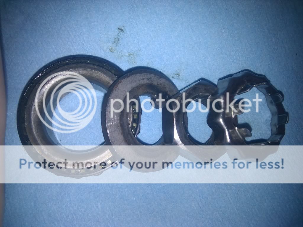

For future reference, I wanted to post 2 more photos. 1 that shows the bearing, washer (that I am told not all trailers use) and the castle nut. In this case the castle nut is a normal nut with a "add on" part to it, I have not seen this in any other videos online or anything , it is usually a single case piece. The second photo (best I could take) is of the bearing. there is some "burnt" grease on it. some of the rolls are stiff, and there is one that looks cracked. They are fairly cheap to replace, so I intend to get new ones.
bearing - washer - nut - "castle"

the split pin goes through the castellations once you adjusted the bearing which therefore stops the bearing nut turning, Keeping precise adjustment and secure, as opposed to a straight forward nut and split pin.

Your bearing picture is showing the classic darkening of heat failure, if the photo is accurately representing its look! Bearings go from looking fine to complete failure really quickly, though. I had one go from running cool to completely destroyed in 2 hours. See "trailering on a wing (nut) and a prayer" thread.....
