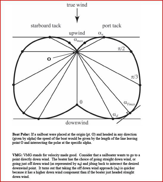

Another thing to consider is if you don't have a spinnaker is to sail about 45 deg off of DDW. You will dramatically increase your speed. If you look at your polars its the fastest point downwind. You will have a much easier time keeping the sails full. Also you trade off more distance over ground but increase your total distance against time.

Danny, like Scott said change your angle to the wind. The reason the saill flops is because you are probably going as fast as you can with the wind behind you. If you are running truly down wind, when you reach the speed of the wind there is nothing else left to fill the sail. As soon as it flops, you slow down, and it fills again. If you change coarse so that the wind can allow your sails to become airfoils then you can go faster than the wind, and you won't stall your sails.

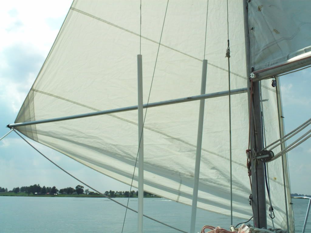

Any thoughts about using a whisker pole with the genoa?

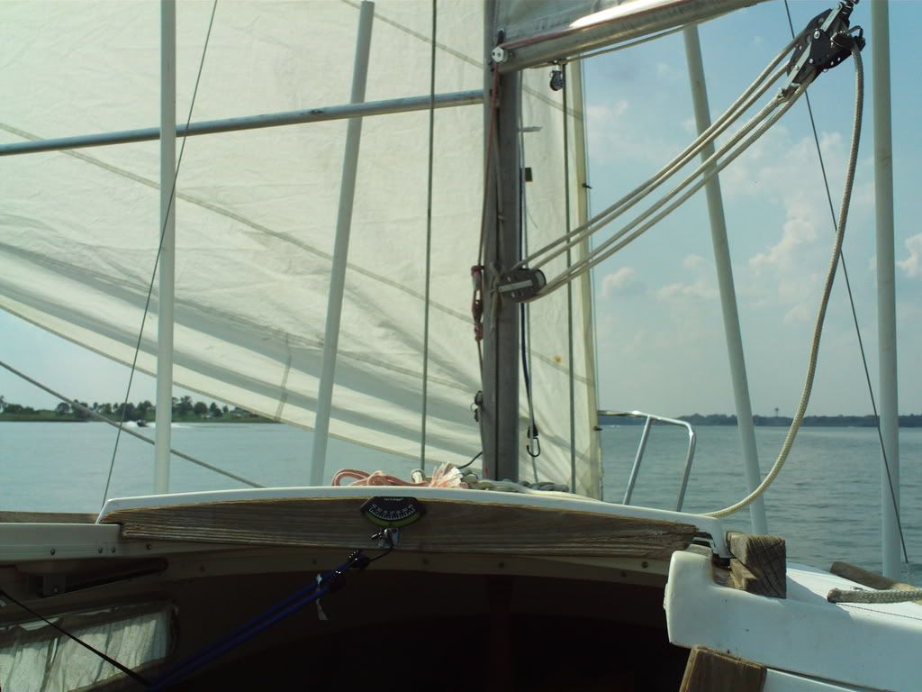

We as well as many here do it all the time. Its a great way to keep it out and not have to be perfect on your course to keep it on the right side of the boat.Any thoughts about using a whisker pole with the genoa?
This is in super light winds
However: if you are coming through a narrows, I would not have it poled out. You are far too likely to encounter a wind shift/ shore effect or wind eddy. A sudden shift could easily back wind your jib and cause you some embarrassment or worse a collapsed pole or even worse contact with a jetty or the shore or another boat.

Thank you very much Scott.
'preciate the photos. How is it rigged to the mast?

Scott,
Do you have any photos of how the whisker pole is attached to your mast? Did you buy this or make this?

Thanks. Went on-line and it seems like whisker poles must be made out of gold and platinum or some exotic deep space metal. Unbelievably expensive.

Try your local chandlery. They may have a used one that will do the job. Or try making your own. There are instructions on the web here. Google it and see what comes up. Some have made them out of telescoping man-helpers, like the ones used for rolling out paint in high spots.c130king wrote:Thanks. Went on-line and it seems like whisker poles must be made out of gold and platinum or some exotic deep space metal. Unbelievably expensive.

When we had the mac we used or telescoping boat hook as a jib pole
