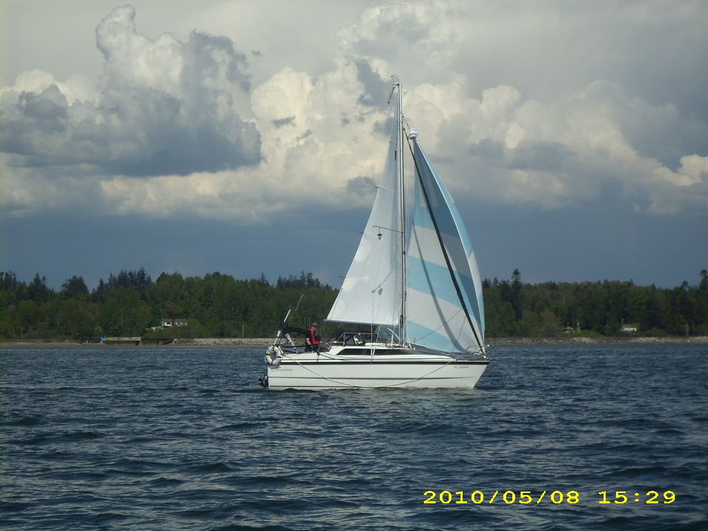

This photo below was during a Regatta, and we knew there were no gybes on the light-air downwind leg so we just ran one working-sheet to reduce line fouling.
This photo is of our 150% Gennaker with 75' sheet, notice starboard lazy-sheet is almost in the water.

We have a 150% genoa with black uv strip on a CDI-2 roller furling system, also have 3 light air spinnakers (Asymmetrical, Symmetrical, Gennaker)
- Dacron genoa can be reefed (roller furled) to any size and then sheeted to inboard T-tracks, to balance our X in winds up to about 25knots, after that everything including the sea state gets a bit much for our lite Mac and then motor-sail with double-reefed main for stability.
- I don't not use the symmetrical as much anymore because I am short crewed lots of the time and there we run 4 lines for this type of sail. (topping lift and down-haul for 8-12’ pole, lazy sheet and working sheet, we don't use guys).
- Our Asymmetrical is made of 3/4 ripstop nylon and is good to about 15 knots max, draws well to a little forward of a beam reach, any more forward of that and we set the gennaker.
- Our Gennaker is 3/4 ripstop nylon, same 150% size as the genoa and almost the same shape. gennaker cut is very flat (almost like the genoa) so we take almost the same angles as genoa right up to close hauled in wind max to about 15 knots, then we set the dacron genoa. Notice the windex on the masttop in this photo, of the gennaker and you can see how close to the wind we are, and could still tighten the luff (raise halyard or tack down) to point a little higher.
