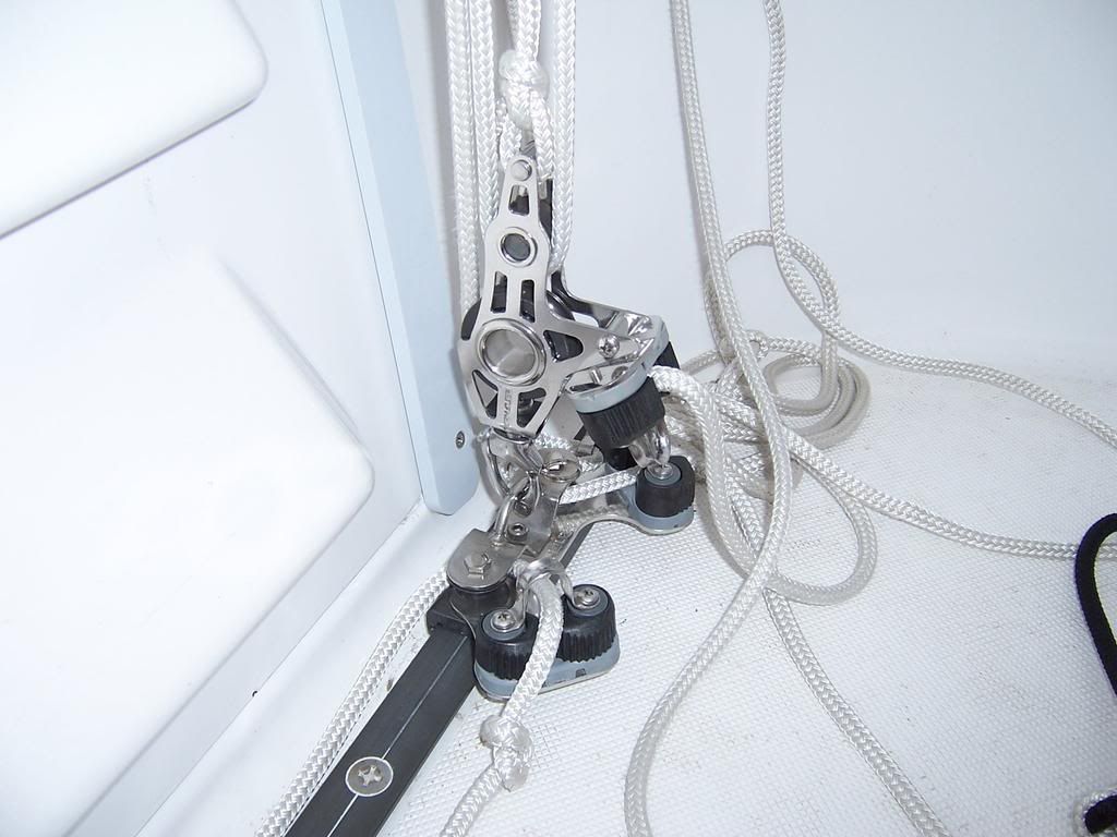

Do you mean at the Head of the sail, or the slugs to the eye's in the leading edge of the sail. If it's the Shackle, he's a pic of one to the left of my furlur.....
... and another one holding my mainsheet control to the traveler...
