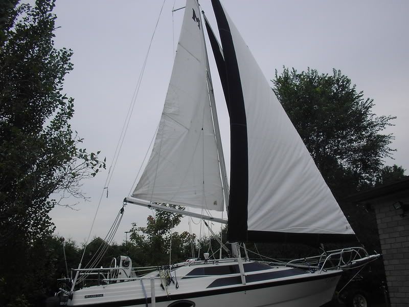

StackPack with Lazy Jack
After 4 Years of trying various combinations of Sail Management.
I like the Combination of a StackPack with stiff internal battens, used with a simple Lazy Jack system.
One Big/Long Zipper on top of the Stack-Pack, remove the Front Cover, and Point her into the Wind... Then hoist away. Works Great.
Main Sail has full Horizontal Battens
Easy to Drop , or Reef....Point her into the Wind, Reef or Drop. The Stackpack, makes it Easy to singlehand... No Flopping over the Boom.
Only: downside is the cost: unless you have access to a Sailrite Sewing Machine & the Time & Ability to engineer the same.
Happy Sailing 2008
Jack

I can't imagine single-handing (which is pretty much what I do the most) without the Lazy Jacks. Yes my battens will sometimes catch, in fact it probably happens 50% of the time I hoist the main, but it literally takes 20 seconds or less to correct. I lock the halyard in the clam cleat, reach up and grab the leech of the sail, and then pull down to pop the batten out from under the LJ. Works every time.
PO installed the system. It was originally just one long line ran through some blocks and fairleads. And when the LJ was "down" so that I could pull it all forward to enable it to go inside the sail cover the line was the perfect length. But to "raise" the LJs so that they were up in the working position I had to pull about 25' of line out the end of my boom to tighten the LJs. Thus I was sailing around with a big wad/coil of line hanging on the end of my boom. Seemed like a pain.
So I modified the system. It is now not single line. The "main" parts of the LJ is now 2 lines with small caribiners (from Wal Mart) on each end that connect to small attachment points on the boom/mast. The "vertical" lines are simply tied on to the "main" lines and taken under the boom through a fairlead. A couple of wraps of duct tape on the "main" lines below the knots in the "vertical" lines keeps them from slipping down. To pull the LJ forward to put on the sail cover I simply have to open the caribiners and pull the whole thing forward. I do have a loop with a "taught line" knot to enable me to tighten or loosen the main line as necessary (which is very infrequent).
On Edit: Found a picture. The Black Lines are the "main lines". Up from the aft end of the boom, through small blocks which are the green circles (which are attached to lines attached to the sides of the mast), and then down to forward section of the boom. The red circles are the small caribiners (four in total...one at each end of each line). The blue lines are the vertical parts of the LJ. Each one is a single line tied on to the main and taken under the boom. The tape keeps them from slipping.
It's kind of "Boy Scoutish"...but that is what I know best so that is what I did. But it works and it was simple to modify. Can't really say how difficult to install it in the first place but I doubt it was that tough.
LJ's are a "must have" in my opinion.
