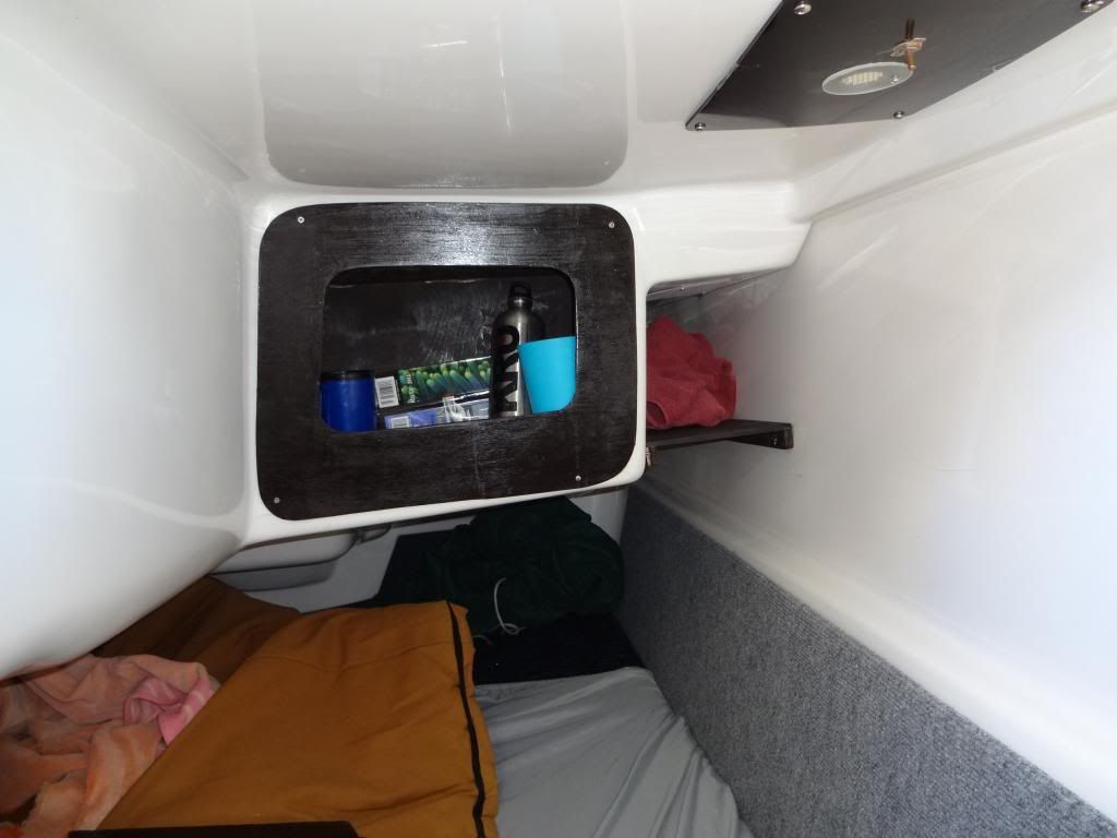

Re: Genoa Track Install Advice
My boat came with the white plastic covers under all the seats which I eliminated a while back.What did you use to close up the 5" hole? In my mind, I had thought of cutting into the liner with something more along the lines of a 1" hole to each of the bolts and covering up with plastic caps. I hadn't thought of the foam inside getting in the way.
The problem with small holes is that the track is about 20" up from the liner, so you need a steady hand and a very long extension. Basically you have to work by feel contorted sideways/upside down without getting your head stuck, and up to your armpit in a fiberglass hole in trying to reach all the bolts. Meanwhile hoping your partner is on the same one topside.
Here is a bit of a look inside from when I was working on it.
The upper two access holes are for the genoa track and additional dock cleats, one would probably be enough under a 24" track to reach all the bolts. The other hole was for a stern anchor mount which was just as much fun
The access holes covers are covered up by a shelf I added. The foam comes out through the factory black lexan covers.

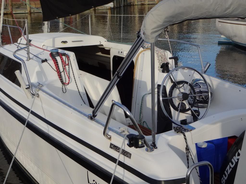

Seapup - not to change the subject, but what's going on with the two lights at the stern, neither of which are on the little square pad next to the rudder cleat the white stern light is normally found on an
