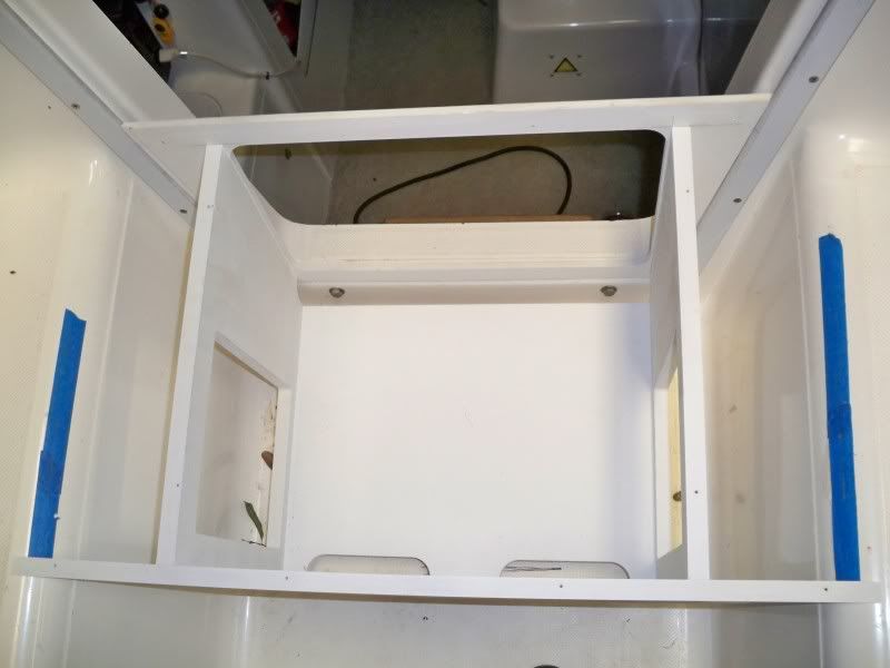

My wife conspired with Billy (XX) to have a second version of his AC mod made for our boat as an Anniversary/Father's Day present :)
Three 26Xers have been begging for over a year to get this mod, and we got the first CNC one ever made.
The easily removable AC box is made from a PVC material.
Entry and exit is the same as the 26M with the box in place (no additional hassle). The box also doubles as another seat.
We are going to add the smoke Plexiglas rear window panels (like Billy's) next week.

Contact "Billy" (Double Cross) on this forum. He is the brilliant designer and builder for this mod.
I know that at least two other locals are in the begging line. Maybe some of you can push him to build more.
We are extremely thrilled to own the second unit built. This unit drops in with NO holes or mounting of anykind.
By the way, getting in and out of the cabin seems to be about the same, but without the hassle of lifting the AC in and out.
The Plexiglas two piece rear window really adds to the openness when everything is closed and cooling.
Now we have AC, pressurized water, transom shower, head shower and new electric.
Victor

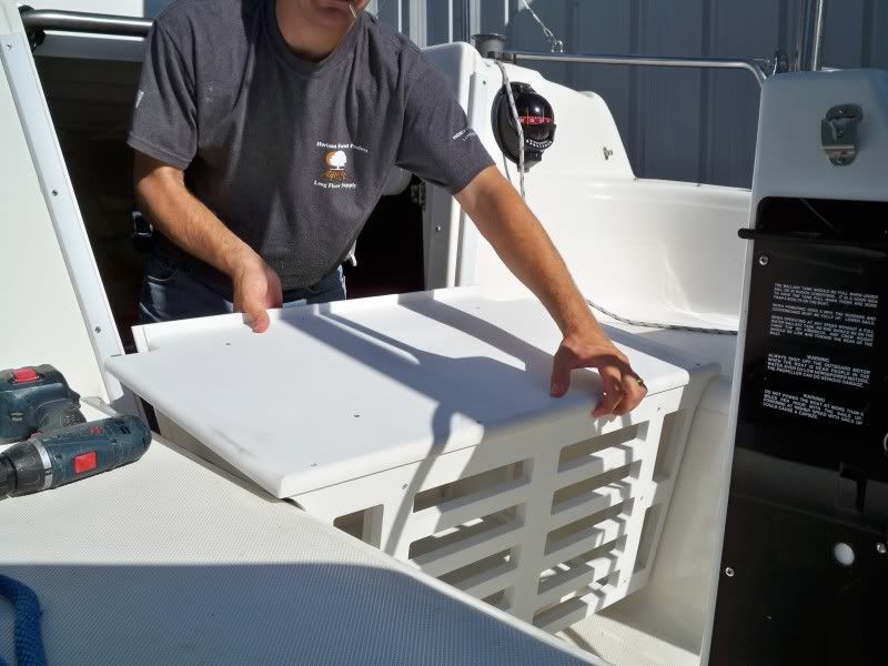

Vic, didn't know you were going to show it off like this. Glad you're happy with it. Thanks guys for the comments. Some of you may remember about a year ago, I built this mod with plywood & truckbed liner. After some inquiries from other X owners, and just for the experience, I worked with a friend measuring & calculating one for CNC. (Fiberglass molds just seemed too much trouble.) Then we decided to use PVC board & SS screws so almost anyone with a screwdriver could put it together. If the PVC board does everything it promises, this unit should outlast the a/c unit. (Then the a/c unit is tossed & another put in.) We designed the "box area" to accomodate almost any 5-6000 BTU window a/c. Seemed I couldn't stop there. Just had to make a hatchboard to complete the unit. It was a rewarding experience when it fitted. Rounded a couple of edges and it fell into place.
keith wrote:Thats just what we need here in aussie could you show a photo from the inside
or did you mean from inside the boat? Unlike the prototype, this unit has a floor with cutouts for drainage. The a/c could be hung from the top or set on the floor. Several ways to secure it.
Gazmn wrote:Well if you were considering going into business with this model - There'd be a lot of takers. [True entrepreneurship in the face of a lackluster economy.]
Including me - & I already made my own :wink:
Not really ready to go into this business yet. My housing business already limits my sailing time. Would consider making a few for forum members. But need to correspond with Heath. Wouldn't be right to commerialize on his property.
rick retiree wrote:Nice Mod! Very clever I'm guessing you installed approximately 5000 btu window unit. Does it handle your North Carolina heat/humidity ok? I was going to cut out opening in hatch door but this would be much better. How about making it portable and stow in V-berth where you would want the weight while underway. Wonder if my Honda EU2000 could handle it. Dang now I got another project.
I've used a 5000 BTU for a few years now (NC & Bahamas) and it will bring the temperature down so that one starts looking for covers to wrap with. While at anchor I use a Honda 2000 generator. Fill the tank at night and it runs until morning. Awaken very refreshed.
I tried portable a few years. Weight of the a/c & retained water from condensation just make it too much of a hassle. The bench top seemed to offer more rewards (uses) than something that stows below. Leaves room to store more stuff below. One can leave the whole unit at home & go back to the standard hatchboard anytime.

We get the PVC sheets from a building supply distributor. A lot of this stuff is being used in the housing market. The box is made from 3/4" and the face & hatchboard from 3/8" with the edges trimmed to fit the hatchboard rails. This is the brand we used http://www.komatrimboards.com/ Impressive stuff.
And I used it to replaced the backboard on my bb goal. So far no warpage or rot. :)
