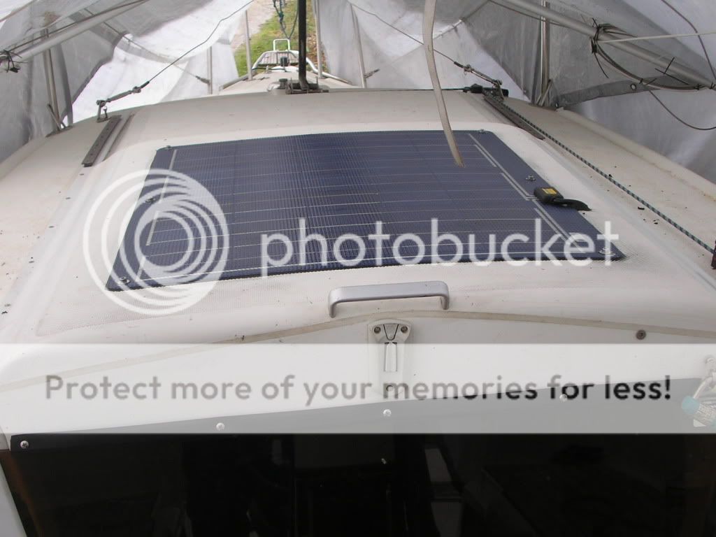

Here a picture of my solar panel to give You an idea about the size (and cost) of it:
It´s a really big one and covers almost the complete sliding hatch (80 x 65 cm- I can´t give You the tech. spec., in GE it says something about 272Wh/d on a sunny day)) . However I´m quite disappointed as far as the performance is concerned.
During a bright sunny day the generated electrical power is not sufficient to operate a Lawrance Plotter, a Raymarine ST40 Wind and a Raymarine SPX5 Auto Steering system. The SPX 5 reported "Low battery" after about 4 hours of operation. So don´t exspect to much!
I must say that the panel is mounted flat (curved) on the hatch and was partially covered by the main sail.
