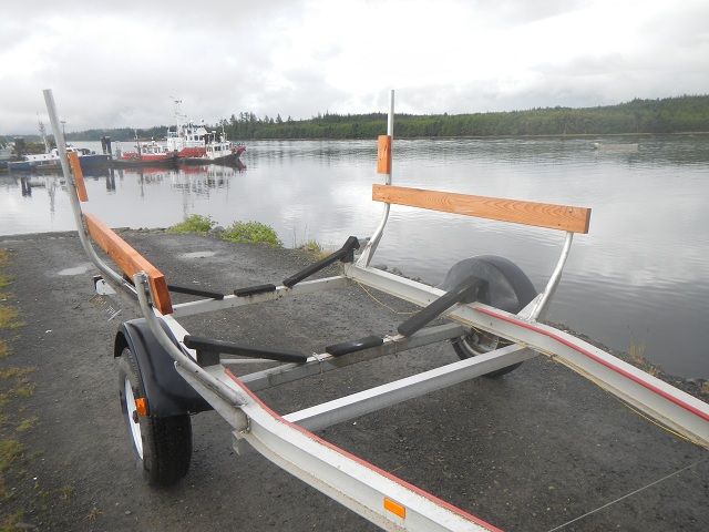

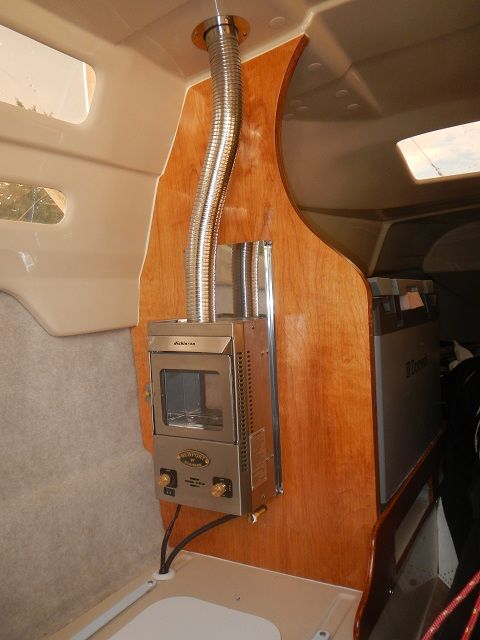

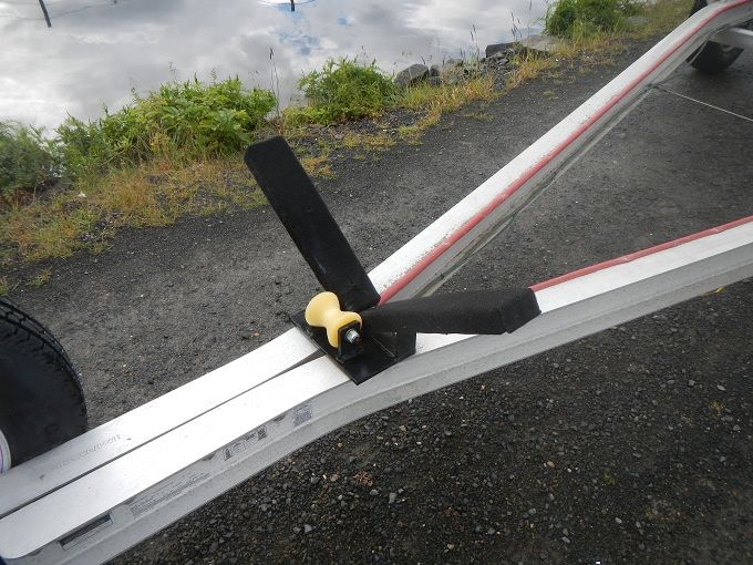

some of my latest mods.
1. new roller on trailer
2. side bunks, still need trhe carpeting stapled on.
3.propane heater on insulated bulkhead

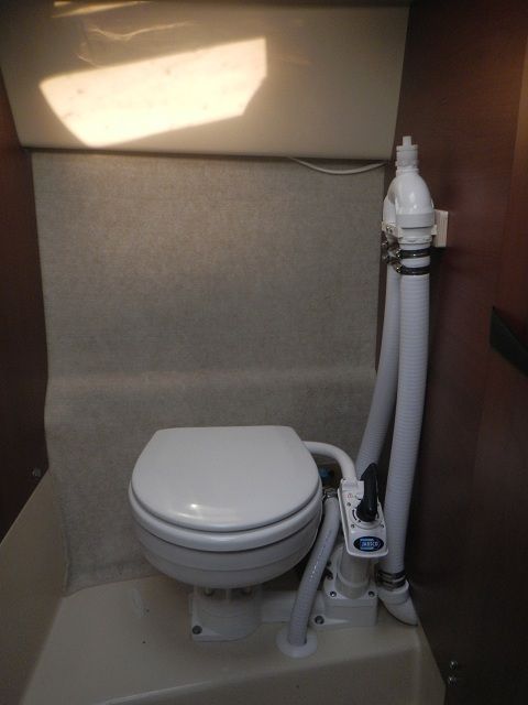

4.dometic 110 liter fridge- still to build the drawers that fit in the mounting platform
5.new head
will get more pics of all the plumbing to go with the head.
new rigid 15 gallon freshwater tank, for the galley
new rigid 7 gallon saltwater tank for the head and sink, both with deck fills
and a 5 gallon holding tank for the head with mascerator pump, and thru hull( above the water line!!).

nice work well thought out I must say the passage way bulkhead is a nice addition for ur heater also
