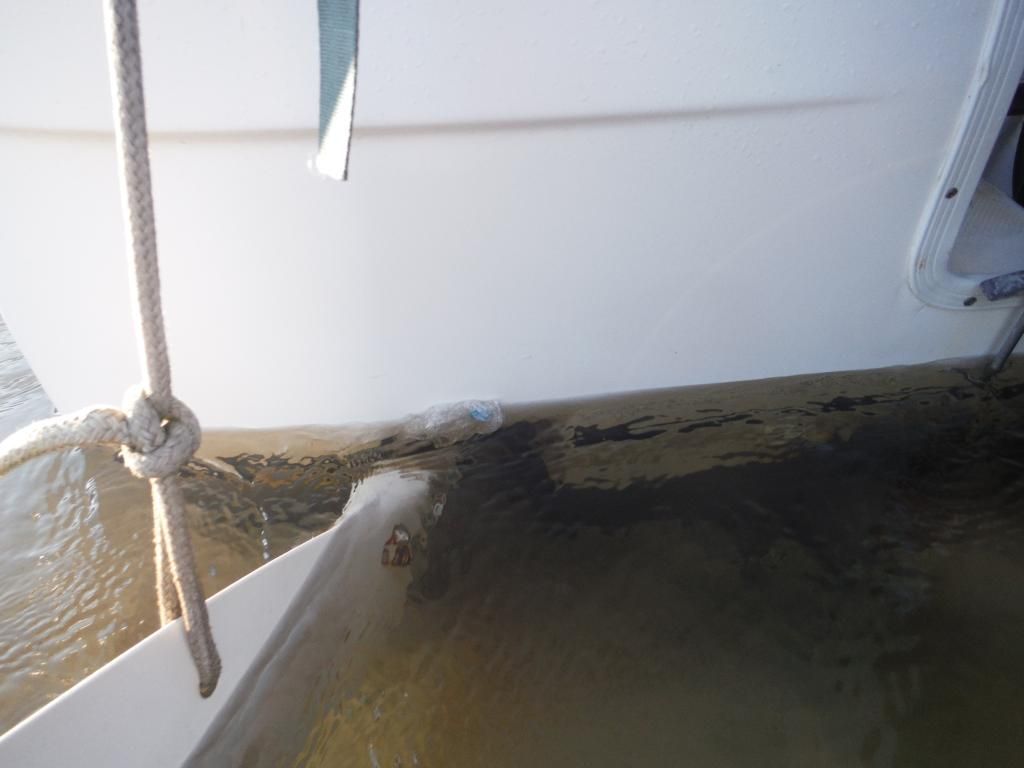

You guys with Ms that think you will never need a bilge pump, just be careful you don't get caught by a fast running tide when drying out on a bank where you have totally misjudged the angle, like I did on our last trip, or you may find yourself wishing you had one :!:
I was happily playing in the water with the kids, until I realized the rudder post dam drain holes were under water! In fact I don't have a photo from it, but the water got to the point where it was just about to go in where the motor steering rod enters the boat...
I quickly cut some little bits of the blue foam from the cockpit floor and stuffed them into some bits of a plastic bag and into the holes.
I dived in the boat and lifted the matress and boards to find probably a few hundred litres of water under the berth ( the rear of the matresses was just in the water - you can see one on the cabin top drying out in the first photo). For about an hour I used a large cup to fill up a bowl and passed it to the misses who dumped it in the cockpit :cry:
I sure wish I had a bilge pump! I do have a manual little pump
https://www.whitworths.com.au/main_item ... lutePage=1
that fits on my yabby pump (not sure what you call yabby pumps in the US/Canada)
It works reasonably well and moves a fair bit of water however it was too much of a pain to try and use in that confined space and the hose I have on it wasn't long enough anyway...
You don't need worry about this problem with the X, but to the guys with Ms who think you will never need a bilge pump, just make sure you don't get caught out by a fast running tide in a creek like I did here! :wink:
