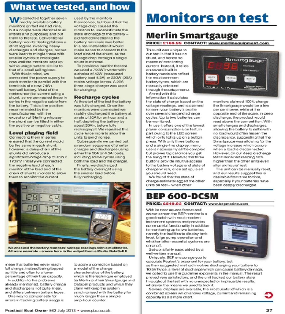

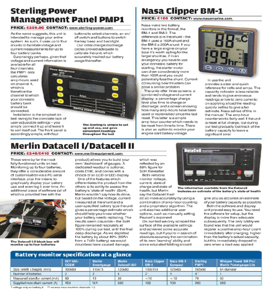

PBOs Take on them including the smartguage:

WHOA!! Okay seapup get the award for most info I could never understand - so did they ever make any conclusions? Did any of you smart guys read this stuff to see which one is the best for a factory stock 2 battery MAC setup?
Is there a link we need to read seapup? (Or is this all in some print mag?)
