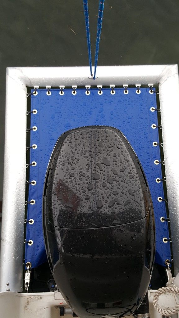

The following began with cutting and welding three mast sections along with the incorporation of 30 bolt-rope sliders for the tarp last fall. It wasn't until this spring that I began to buy the hinge and other necessary hardware as well as ,yet, drilling more holes through my transom.
http://i1121.photobucket.com/albums/l52 ... wsxelf.jpg
I made a cut-out template for the tarpaulin I wanted made and let the outfitter decide the stitching and reinforcing regimen. The material is high tech truck tarpaulin (cheaper than my first choice - sunbrella) which won't stretch and will take a large load. This was secured with 120lb uv proof ties (X30).
http://i1121.photobucket.com/albums/l52 ... mup6pn.jpg
http://i1121.photobucket.com/albums/l52 ... 7uass9.jpg

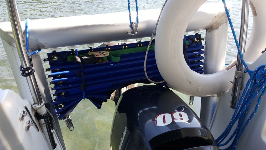

The act of finally lowering the frame adds the right amount of tension to the material though the photo doesn't have the inner clamps attached for holding the working shape. I'd designed the outboard cutout to allow stowing clearance for trailering or lowering with the engine already down.
http://i1121.photobucket.com/albums/l52 ... 6uoojq.jpg
http://i1121.photobucket.com/albums/l52 ... ptjtkd.jpg
http://i1121.photobucket.com/albums/l52 ... jedoyn.jpg
The one finalization I haven't arrived at yet concerns the simple pully and rope I added for the interim. I need either to get it swapped with good non-stretch (bouncy) synthetic material or go to a telescopic pole of some kind. I'm leaning towards the latter as long as I can lower the outboard end directly into the water for my Admiral to easily climb into the boat. She's a stroke survivor and the stock ladder is very difficult for her.

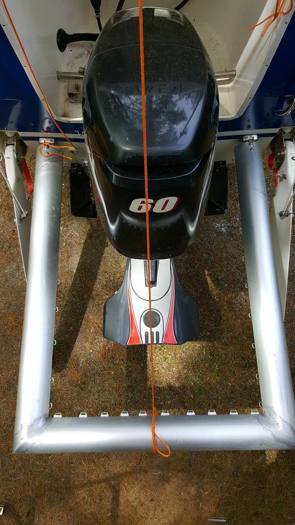

So I've now had a couple of separate uses of the system and have to regard the uphaul pulley attached to the mast arch as a fail because it flexes too much and would probably begin to bend if I pushed it too much. My workaround was running another line from that to the boom pulley attachment bracket on the boom end to keep the arch forward.
What I'm now wondering about is whether a V ended rod could be deployed on the underside of the platform to engage the lower end of the outboard to utilize its hydraulic system for supporting the platform as well as adjusting its position.
Would it be strong enough? :?
My instinct tells me it's pretty robust in order to be adjustable all the way up to WOT.
R.

Well, I've comitted to a salvaged u-shaped piece of stainless tube with a bow roller from Canadian Tire, that I just drilled out today. I figure , similar to your inputs, that the motor can at least position and hold the platform frame at the desired angle, without necessarily having the umpff to actually raise the loading through any subsequent angle change. I'm keeping my digits crossed that it can do both without me having to add my Admirals weight into the speculation pool.
:D
I need two basic positions, one dipped in the water and one out regardless of any in-between capabilities. I should have the final attachment hardware in a day or two and will put in some new pics once assembled. Also, there was a fail with me stepping on, and breaking two of my 120lb cable ties while at this years MMOR. I'm changing these to stainless ties that I discovered at Home Hardware. I also have to source some anti-skid tape to put on the very slippery wetted mast sections.
R.
