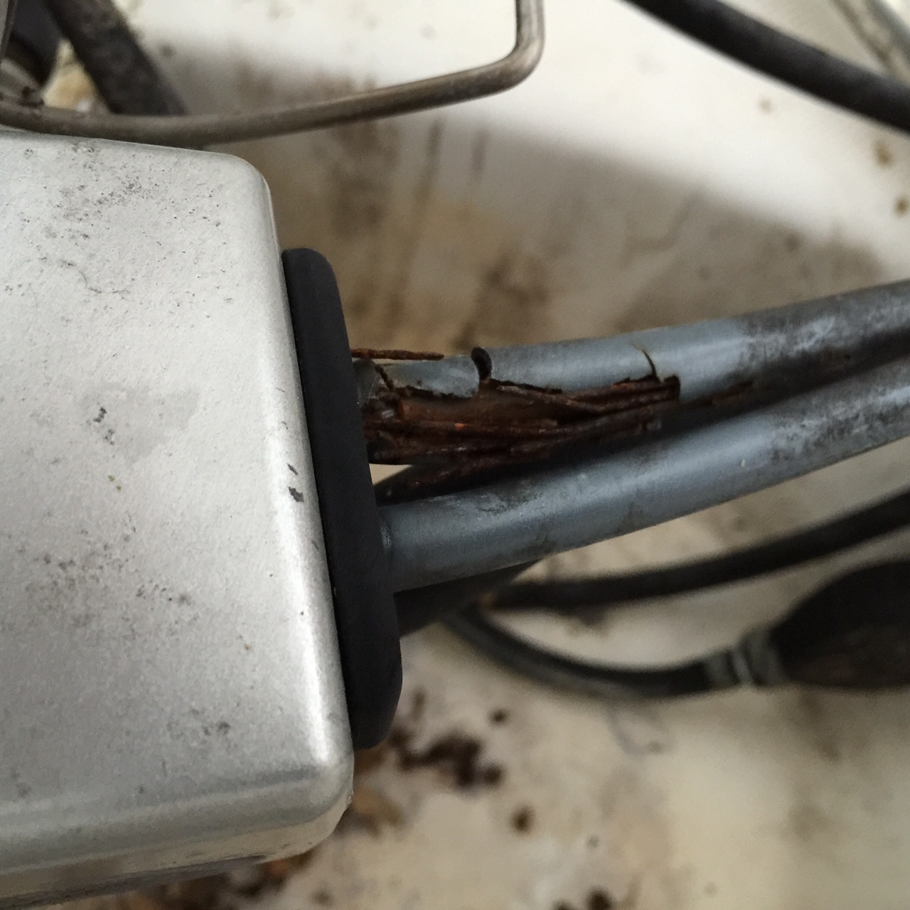

Just wanted to share to hopefully save the next guy some time since it appears these tend to get worn out a LOT, mine did!
No reverse = no bueno :!:
Ordered these cables from Amazon for my :macx: for $32.54 each.
Search = 15' SeaStar CC230xx 3300 Series Standard Control Cable with 10-32 Threaded Ends
Installed last weekend, fit great, work great.
I read through a lot of posts to figure out this part but wanted to share the Amazon info. Shipped in 2 days!
Hope is saves you some time searching the internet for parts!
