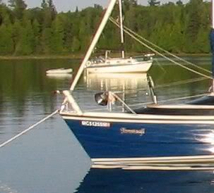

Does anyone use a Bulwagga anchor??
I've been very happy with mine for the past six seasons. Never dragged, and always set first try. Several owners stow them in a PVC pipe on the bow. You can see it in these pictures; the anchor just stores by dropping down into the pipe with the chain doubled up through the top also.
