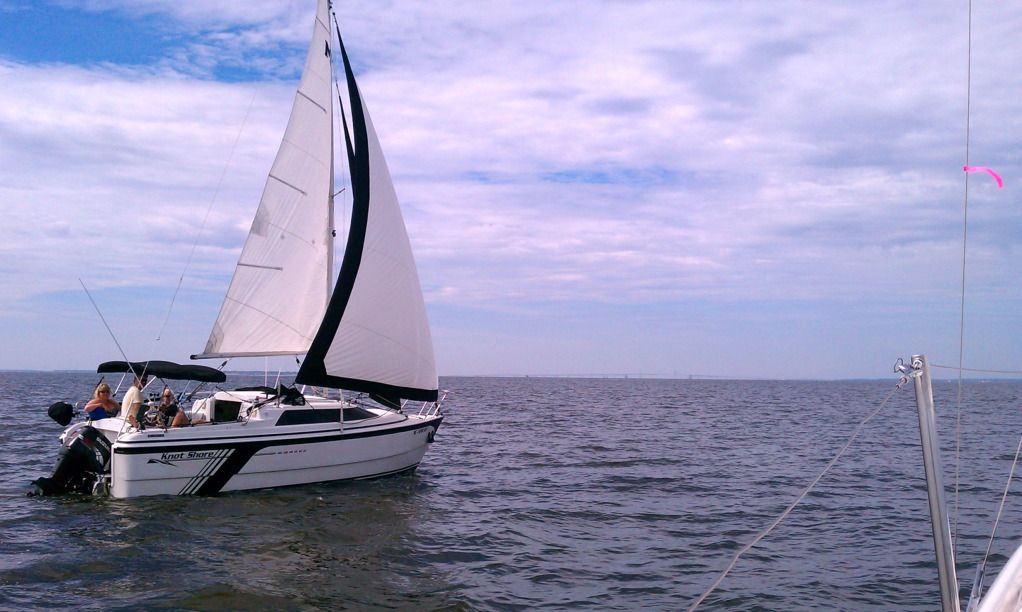

I still use New Glass2 every year (9 years now) and I am still very happy with it. It does a great job making the black look new and shiny again. It does not make the boat look yellow at all (see pic below from a couple of weeks ago). I use it on the top and bottom of the boat.
You just can't beat making the boat look new again less than 30 minutes and not break a sweat doing it!
Just this year I ordered their PreTreat to see how it worked taking the New Glass2 off... it was very easy... wipe on and hose off, it took it all off right back down to the orginal gel coat.

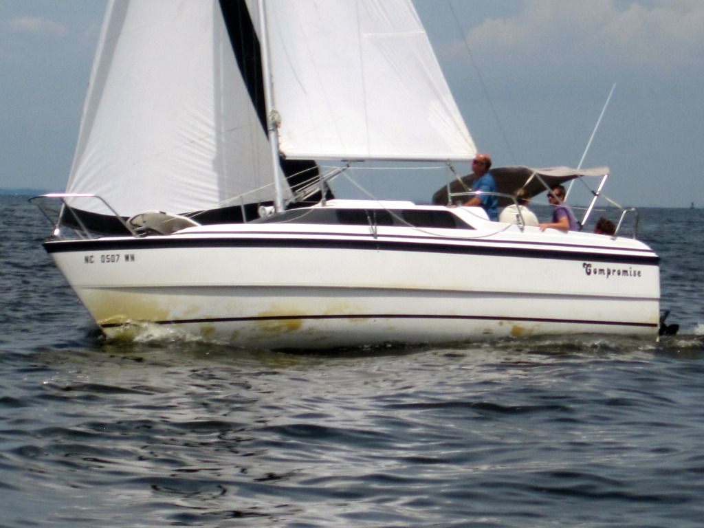

Erik snapped that picture just before we passed him, proving that even a bad PolyGlow job is faster than New Glass II
Seroiusly, avoid PolyGlow. Even the company that sold it to us now avoids using it on the topside of their personal boat.
Victor
Victor

You just used that on the stripes right? Or did you do the whole cabin top? Looks great
