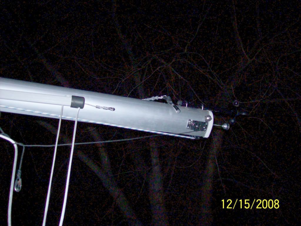

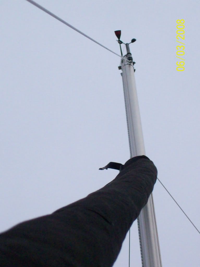

Do you have a picture of the top of the mast where it connects?

Post by Matt19020 » Mon Jan 07, 2013 8:56 pm
Boat...
Found some images...not great but you should get the general idea. If I find better pics I will post...

Thanks Captain Matt. I need to install that thing on my mast in the picture with the lable letter "A", right?
And what is that thing that letter "B" is pointing to? Is that a topping lift?
