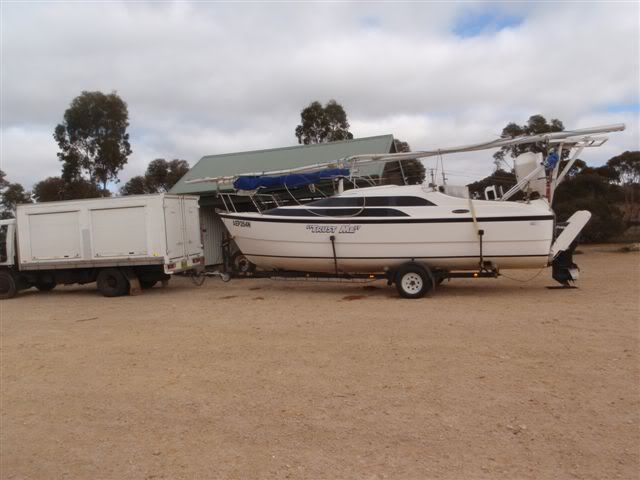

Boat for carrying the furler I think all most of us do is lay it along the mast and fit an extension out the front so there is no droop which can leave it permanently bent after a period in the sun.
We also carry the boom and all sail gear on the mast but that requires lifting the carry points and installing a support in the middle of the mast, this allows for much faster set up and the need to move the mast/spreaders sideways to clear the lifelines as they sit above the lines.
Re protection of your jib/gen we got a piece of sacrificial material down both the exposed edges, this has lasted 7 years now but this will probably be the last and it will need it replaced.
This photo shows the carry setup reasonably well with the support at the mast step, if you want close ops of the supports let me know and will take a photo of the off the boat.

Wow, you really do carry that mast up high Captain Boblee Sir. I will indeed make an extension as suggested but I think my lorrie is even taller than yours so I need to be careful about that. I think in your part of the world where the wallaby live they are very familiar with my tow vehicle? It’s a tall van called a Sprinter made by Mercedes? Anyways I don’t want the mast extension to make an unwanted visit into the rear of my van.
I’m going to start fabricating the extension as soon as the rain stops over here.

Hey Bob...your rig looks just like ours.....mast high enough for cockpit head room when on the road....front hatch able to be opened....also find the mast forms a pretty good tarp carrier....our shed is too full of sh~t to fit the boat in.We can even put our dodger and bimini up under the mast when in travel posi
