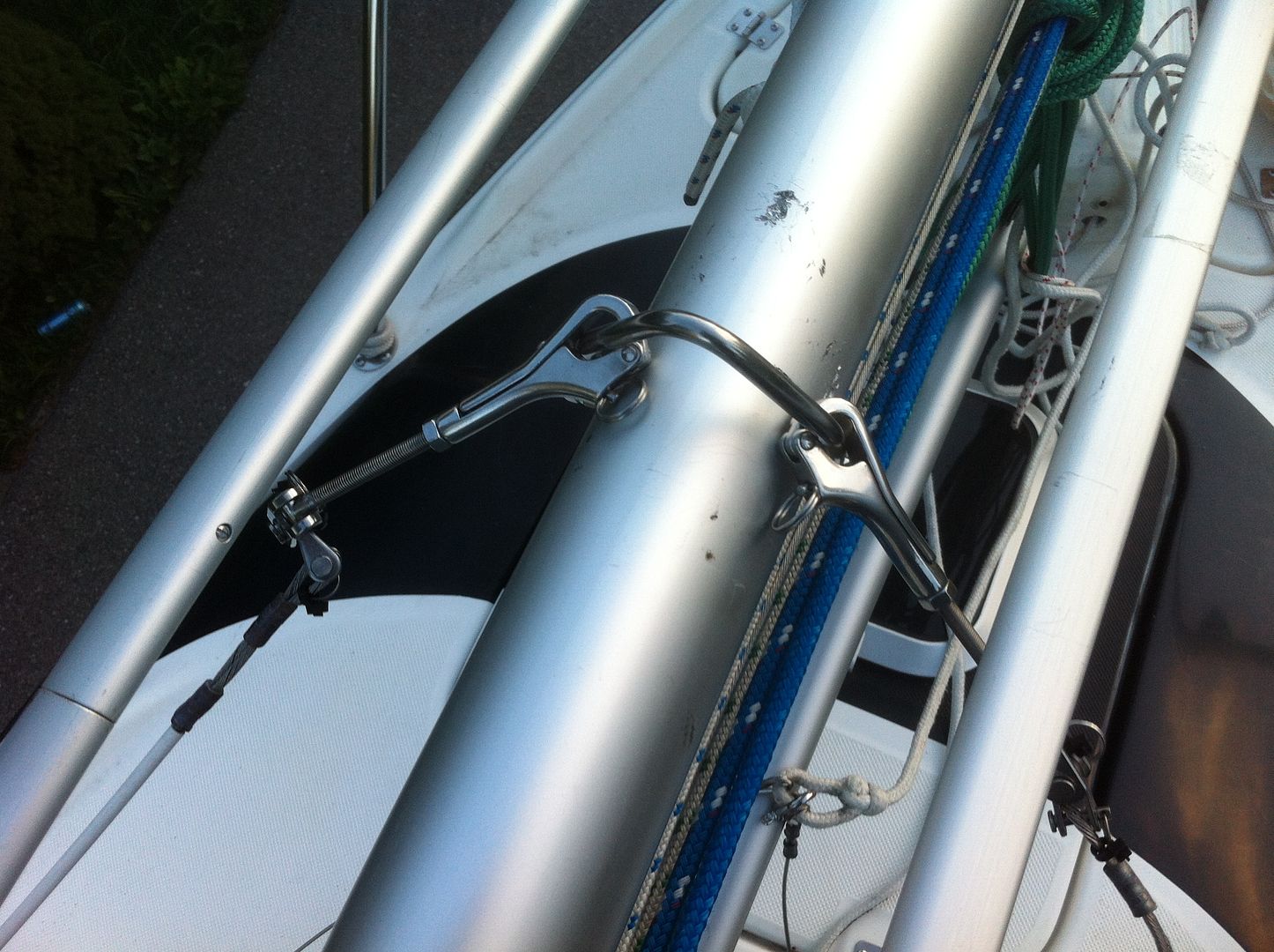

Re: Pelican hook for cockpit lifelines.
How did you connect it to the lifeline itself? Was there already a stud swaged onto it, or did you do that yourself?
I bought toggles localy that screwed into the pelican hooks , if u click on the pic below u can then either zoom it or + it to a larger size to see them bettter here they are connected to my mast while in storage
Hope this helps J 8)
