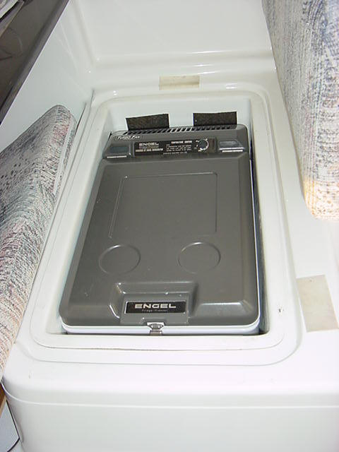

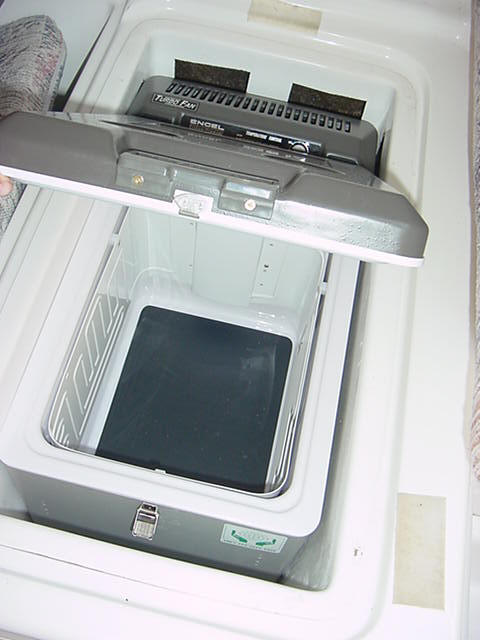

I have an Engel frig, and I believe it's a 36 quart size. I'm guessing it's the same size as yours. I installed mine in the aft dinette seat space. I removed the stock fiberglass ice chest insert bin and set the frig down on the water ballast tank top. I cut out blocks of styro foam to create a flat surface that aligns with the top of the water ballast tank. I cut holes to receive the padded feet of the frig. I also added extra rigid foam sheets, about 2 inch thick, around the food box portion of the frig, to give it a little better insulation. I had to unscrew the exterior handles, so that it would fit into the dinette locker space. I had to cut out a little on the rim of the dinette seat, to allow for reaching in. I glued a 3/4 inch thick piece of flexible foam to the underside of the dinette seat lid, and we then put the seat cushion on the lid, in its usual location. This allows us to sit directly on the frig lid, and it works out great. Things just fit there. We looked at the Waeco unit, and it's dimensions were just a little taller. I don't think it would have fit. I did install a plastic louver vent under the dinette, aligning it with the compressor motor. I put a second plastic louver vent in the head, also lining up with the compressor. This allows for some flow through ventilation. Not sure it was necessary, but it was easy to do and might help. My house batteries (2 6 volt golf cart batteries in series) are located in the battery box just aft of the galley. It's a chore, but I was able to fish the wires across to that side by going under the head and across the water ballast tanks and under the king berth liner. I used a pair of 12 guage tinned wires, and connected directly to the house battery, with an inline fuse holder on the hot side. We have been using a 65 watt solar panel, mounted on the sliding hatch cover. With our heavy duty house battery, this has worked out well enough in keeping the frig going. If we're anchored out for several days without running the outboard, and with decent sunshine, it almost keeps up. I notice a slow decline in battery reading on my digital voltmeter, but it does work out nicely. For this year, I've replaced the 65 watt panel with two 50 watt panels, and I'm hoping that will do an even better job in keeping the batteries topped off. We try to freeze foods before the start of a trip, and that helps keep the frig cool. We set the unit to maintain a temp of around 39 to 40 degrees. We also carry a small ice chest and we put our pop and beer in it. If the ice melts, nothing spoils or suffers from contact with melt water. We're very happy with this setup. I expect you will be as well.

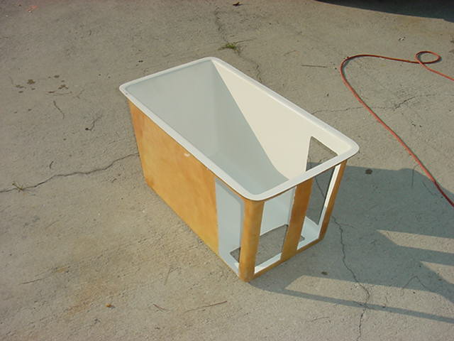

I have the Engle 35 refrigerator ... works off of DC and AC... I removed the handles and the feet. Then I cutout some of the cooler insert to allow it to ventilate and added more fiberglass roving to help support the extra weight. Over the years I have owned it, it doen't generate much heat at all.
