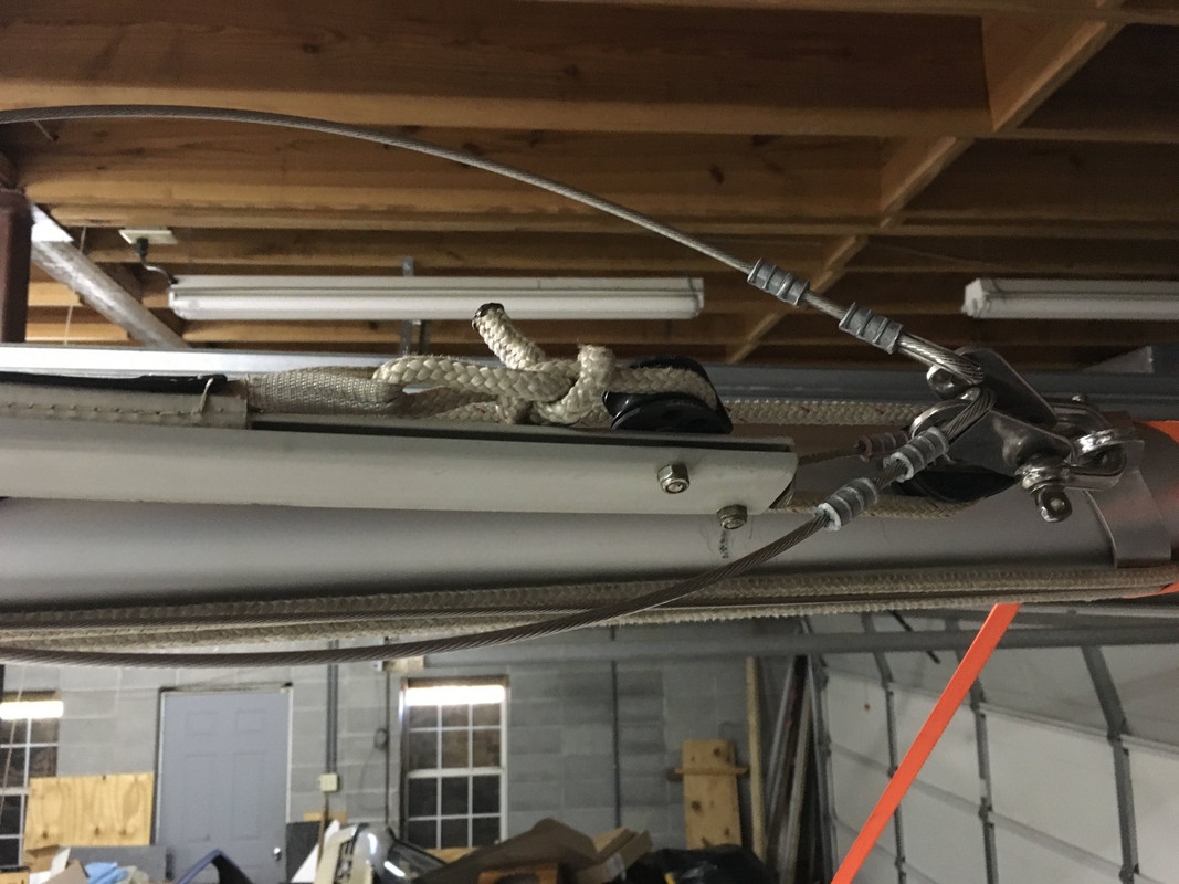

You can see in the following picture my stay is about 8 inches short. However I now understand how the furler works and it is a simple elegant device. The turn buckle is cranked right down so there is some room to expand. However I now have a Johnson quick release Lever 14-205 (thanks Stingy Sailor youtube)which I'm excited to try tomorrow.
Top of mast normal setup needs safety wire!
Probably going to order a new stay from BWY however there is some options in a town near by with a sail loft and sailboat manufacturer and apparently they will do rigging.
Been reading a bunch of stuff and know I read the length of fore-stay but can't find it any where. Anyone have that number for the 2004 26M :macm:

Jim B Mack wrote:Probably going to order a new stay from BWY however there is some options in a town near by with a sail loft and sailboat manufacturer and apparently they will do rigging.
Either that forestay is shorter than standard, or the hound was moved up the mast, but the standard setup doesn't have that large gap. It looks like someone, maybe the original owner, shortened it to allow a Johnson lever, but it went missing. Or something like that. But don't assume the existing forestay is the standard OEM length, which is what BWY will sell you unless you tell them otherwise.

Notice the different crimps between your forestay and shrouds. Looks like maybe a different forestay has been installed.
Don't have easy access to directly measure my forestay, but from the hound slot to bottom of mast base plate is 23'-8-1/4". This is the center of the radius at the bottom end of the hound slot to the plate on the bottom of the mast - not the plate that pins to the deck.
The Furler pin to hound slot measures 26' - 11". This is the pin that attaches to the anchor roller bracket.
Using these, you should be able to check Tomfoolery's theory that the hound might be higher than normal; and verify whether the Furler and forestay are the standard length or not.
My Genoa drags across the bow pulpit, which looks standard based on the various videos I've seen of the M. Maybe your PO decided to raise the foresail to get it off the pulpit? Anyway, here's a data point to give you a clue to find the right haystack, so you can start looking for the needle.
Before you put it back with the furling drum high, I'd get the group to weigh-in on the idea. When you're in a blow, you have to pull really hard on my Furler to start the Genoa furling. I have had to go on deck in a big wind to hand start the furl. If it wasn't secured directly to the anchor roller bracket, I'm not sure that it would work in heavy weather, as it barely does now.
Disclaimer: I did not buy my boat new, so before buying a forestay, make your own measurements with the rig set to your preference.
