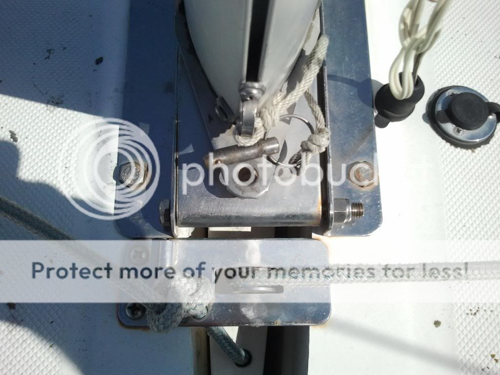

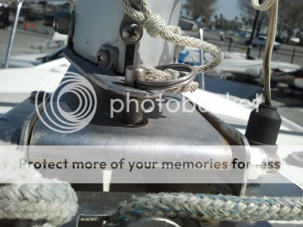

The dealer in the SF Bay that sold me the boat setup a pin system. It looks like he did the following:
1) "Flattened" the flange that the vang normally attaches to.
2) Drilled a hole in the mast baseplate below it (the part that doesn't rotate) to align with the flange in 1) above.
3) Insert pin into holes drilled and the mast is "pinned".
