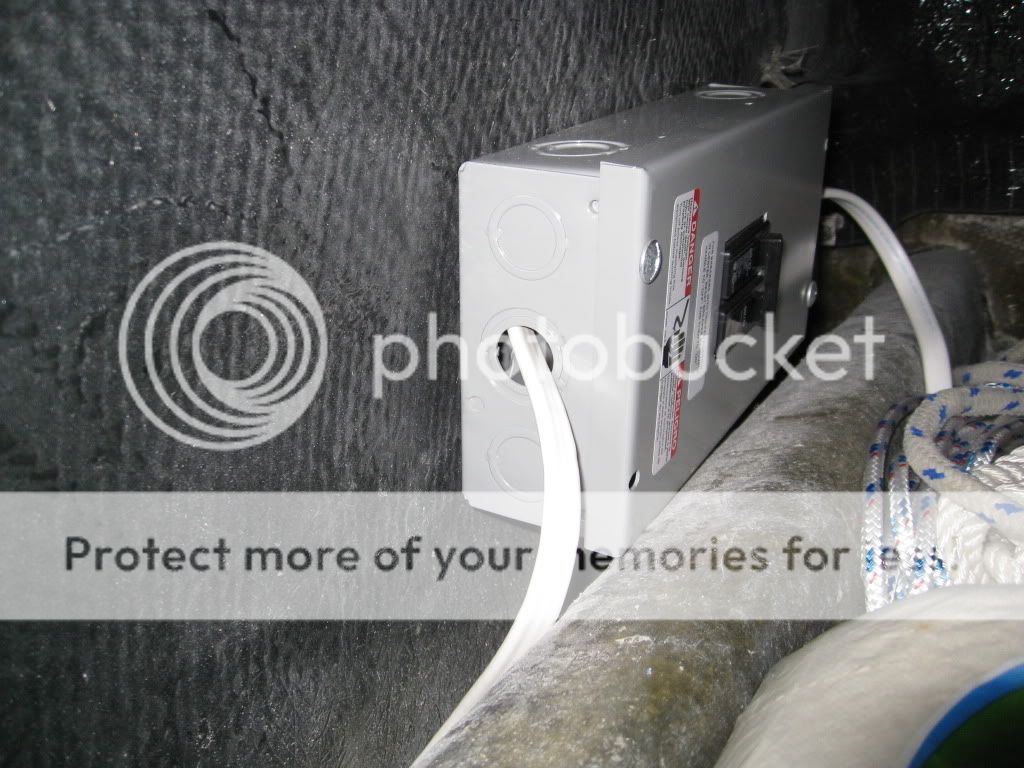

When I bought the M in December I had my dealer Boating Atlanta install shore power. I have an opinion on the installation and my dealer seems to have the opposite opinion, so I would be interested in hearing what members of the board think as an unbiased 3rd opinion. The breaker box is installed inside the locker at the bottom of the stairs. Is this similar to what others are getting when having shore power installed by a dealer?

i dont have shore power. But that installation looks kinda crappy. Looks too low (can get wet easier), nothing securing the wire to the breaker(chafe issue), nothing holding the wires near the box. Doesn't look like marine AC wire to me. The breaker box doesnt look marine rated.
I don't like it. I would look up in the ABYC book on how to do it properly. This doesn't look textbook. Not that I am an expert (far from it), but I would question the installation (have a pro look at it) and have it done properly.
The electrical system, especially AC, is nothing to take lightly. You can cut corners on many things. But the electrical system is not one of them!

That is not a professional install. It appears that they used solid copper wire instead of stranded wire, there is no grommet on the wire in/out of the breaker box and I really doubt that the box is weather proof, let alone water proof. Probably work just fine in a garage, but I would not want it in my boat. I think you have a good reason NOT to accept that type of install!

I am an Electrician Construction worker. No Offense, but that service is Bad and would never pass inspection. The wiring into the box is not secure.
I would assume that the Marina where you dock your boat has a Ground Fault receptical circuit close by.
Hopefully if you plug into a Ground Fault protected plug, your chance of getting shocked is reduced, but I have seen Ground Fault circuits which have failed.

I agree, it looks pretty crappy and more suitable to home wiring. Although even at that, there are no grommets etc. I'd say it's a step above an extension cord into the boat, that is there is a home based circuit breaker.

:o Danger, Danger, Will Robinson, sorry Mark, not to joke about a potentially deadly electrical problem BUT - I was nearly electrocuted by a similar installation done by my uncle - every poster above is correct, that is a very poor install, looks like it was done by a fly by nighter. Have it checked and redone by a certified electrician and document everything and tell that boat dealer that if they don't refund your money you will report them to the state and be calling your attorney. They should be reported anyway so they don't do this to someone else and they should be forced to recall any similar installs they've done in the past. :!: :x

Fuse on the bilge ...
That's #$%$$& "#$##&$
If you get water on the bilge, the shore power wire will be submerse. (The one before the fuse)
If you are motoring and heel the boat the water will go exactly there.
Then you arrive to your marina and BANG!
If the shore power ground fails someone can get killed ...
The material looks for home interior purpose only...

That is a bad setup, even if it was on land. On the water, you should not have a box like that. It is just not safe.
My question is how is the box attached or is it attached at all? It seems to be resting on the outside of the hull. Hopefully they did not attach it thru the hull.

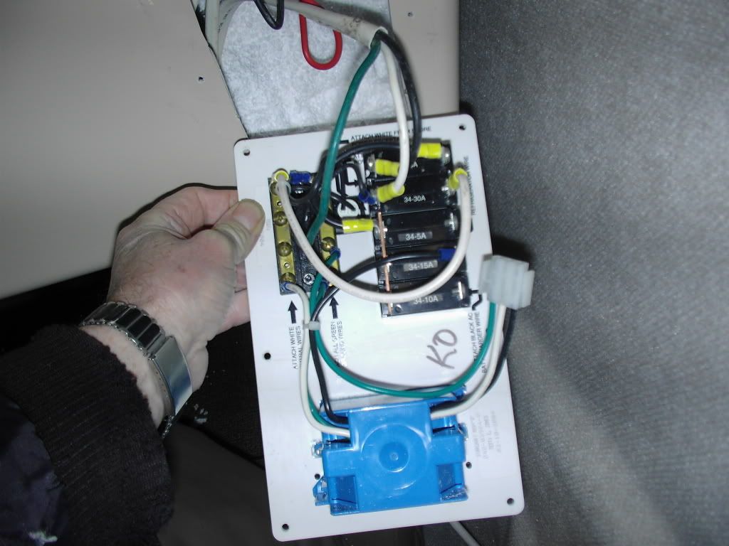

On your 120v outlet the wiring sheave has been cut back to far exposing the wiring itself the sheave should go all the way into the outlet box so as the self clamping device to "secure the wiring " is clamping the wiring sheave & not the wiring insulation as John said bad work as an electrician I'm sure he knows what he's talking about :o

Thanks for all the responses and confirming my opinion on the install, at this point the dealer is refusing to do anything about it and I am not sure where to take it from here. I think maybe I will file a complaint thru the BBB and see if that get any results.
tompolak - The breaker box is mounted with one bolt on the inside of the locker near base of the ladder, not against the hull.

Why are you running that 120 Volt Neutral through that breaker???
IMHO you done a nice electrical install except for that.......... that IMHO is dangerous .

This set-up runs the hot side & the nuetral side through their own seperate breakers giving you protection against reversed polarity :idea:

Wired wrong, and is dangerous. Wiring should be secure, and that box is not designed for wet locations or to be placed anywhere that it could potentially become submerged. Most marinas have 30 amp service, and I noticed that you have only a 20 amp main. Typically you'd have a 30 amp main, and 1 or more 15 amp branches. If you should use an AC unit at the same time as a coffee maker you may find yourself in the dark. Did they at least use GFI outlets? I'd consider contacting an attorney or small claims court as this would not pass a building inspection, let alone boating regulations.
