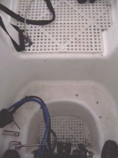

I used the snap-together Dri-Dek Tiles on my cockpit floor. I took a left over scrap piece and cut it to fit the motor well. It keeps out leaves, small twigs, acorns, etc. Anything that passes through the tiles seems to also be able to pass through the drain hole. Available from WM or order direct from the manufacturer at http://www.dri-dek.com/
The manufacturer has a minimum order.
Please excuse the dirty deck in the picture. The Maid did not come in this week.

Bransher wrote:Please excuse the dirty deck in the picture. The Maid did not come in this week.
That's dirty?? I would hate to hear what you think of mine.
Bransher
Posts: 217
Joined: Fri Sep 22, 2006 2:07 pm
Location: Central Florida - 07 26M w/50 hp Suzuki.
Post by Bransher »
When I took the picture yesterday, the boat was in the dark shed and the flash did not go off. I enhanced the dark picture in Paint Shop Pro to brighten it up so you could see the tiles. The enhancing had a side effect of whitening the dirt and crud and made everything look so much cleaner.
When I wrote my comment, I still had the mental picture of how it really looked. :)
