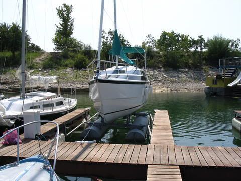

We use a 6000# Galvalift (floating lift). Much easier than bottom paint.
