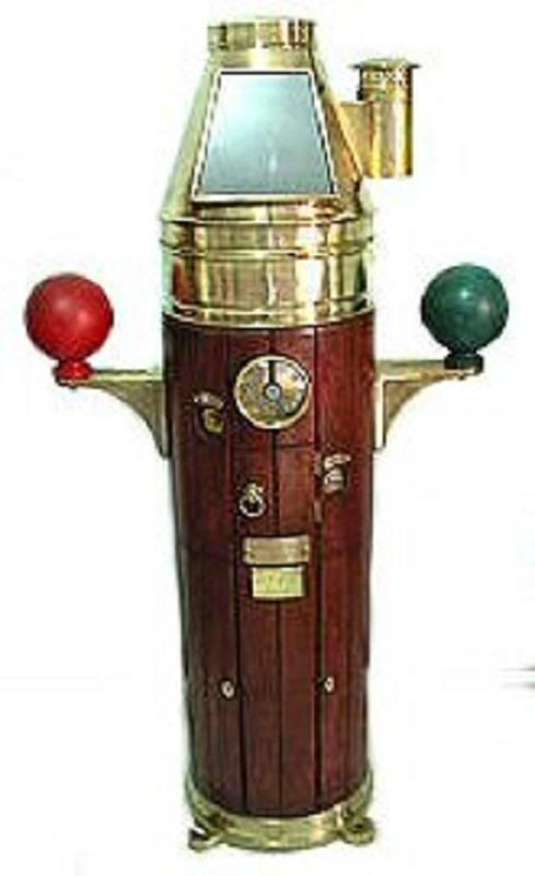

Here is a classic binnacle. It is a stand and enclosure for a ships compass. Note the iron balls mounted on slides on each side. The balls could be replaced with different sizes and slid along the rails to correct for magnetic distortions caused by iron gear onboard and the earths imperfect magnetic fields. Also note the oil lamp mounted on the side, often burning whale oil (insert mother-in-law joke here). Typically the binnacle would be mounted directly ahead of the pedestal.

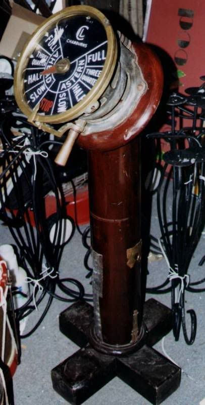

Here is a telegraph, used to communicate with the engine room, mounted to the side of the pedestal where the pilot could read it easily.
