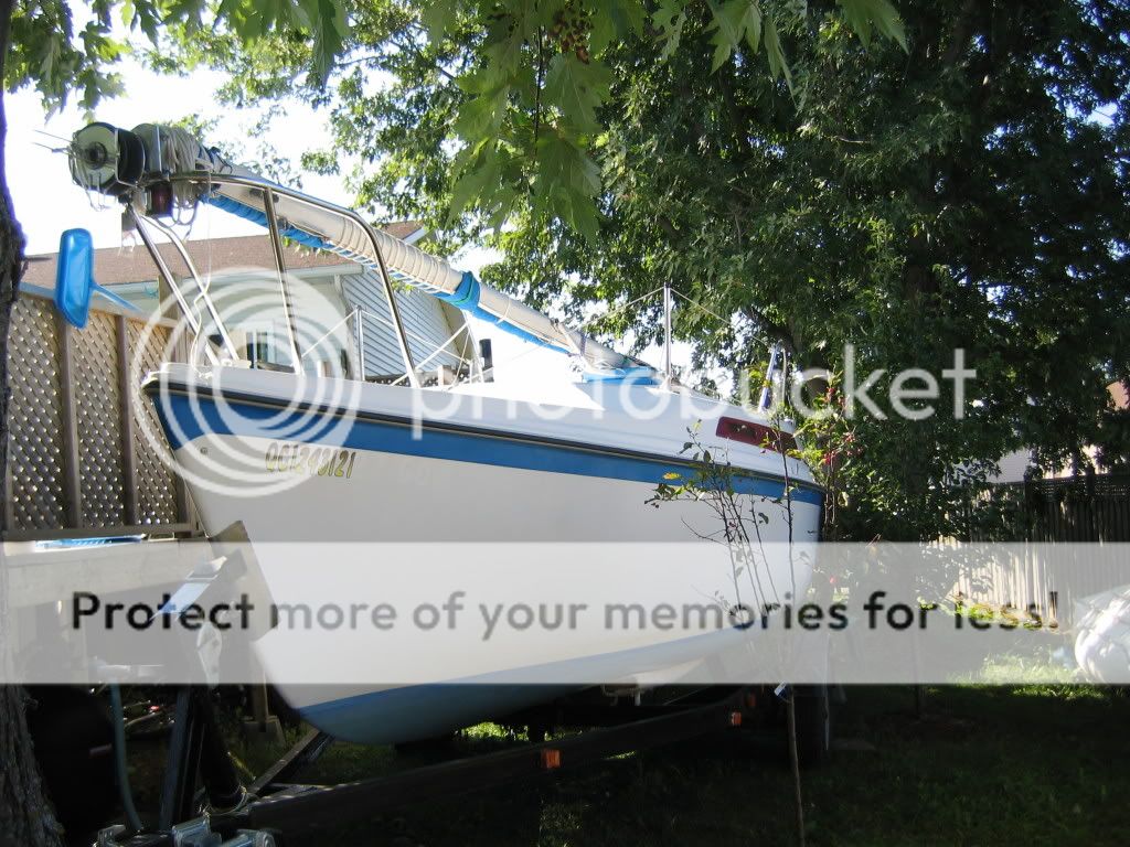

Hi team,
I am in thinking mode on how I will cover up my McGregor 25 for the winter time. The Boat is now located in by backyard and I need to figure out a good protection to prevent the 12 feet of snow smashing it (Montreal is bad sometime in winter).
I was thinking to fabric a wooden structure to create a good slope on top of the boat. Covering up with a thick polythene (plastic cover) to prevent water ingression and then cover up again with a more rigid blue tarple (not really water but strong).
I could not find a good forum on this topic other then bringing the boat in Florida. So if you have already information (picture mean thousand word) or reference that could help, I will appreciate.

Couldn't you just leave the mast running from the crutch to the bow pulpit and stretch a tarp over it from end to end, using bungees to keep it snug and tight?

Hi Jonhny,
The slope will not be high enought to allow the snow to roll on the side. Also with the ramp on the Sail boat side, the snow will accumulate between the mast and the rail on the tarp.
I saw information on special post support like this one.
This is really the top notch for winter covering on sailboat but I got the feeling that the cost will be pretty high but it is nice to see "http://www.topshop.on.ca/photogallery.html".
This could be an alternative also. http://www.boatcovers.ca/PDF%20files/Bo ... 007pdf.pdf
I am travelling right now but I soon I get back home in end of October, I will need to get active on that.

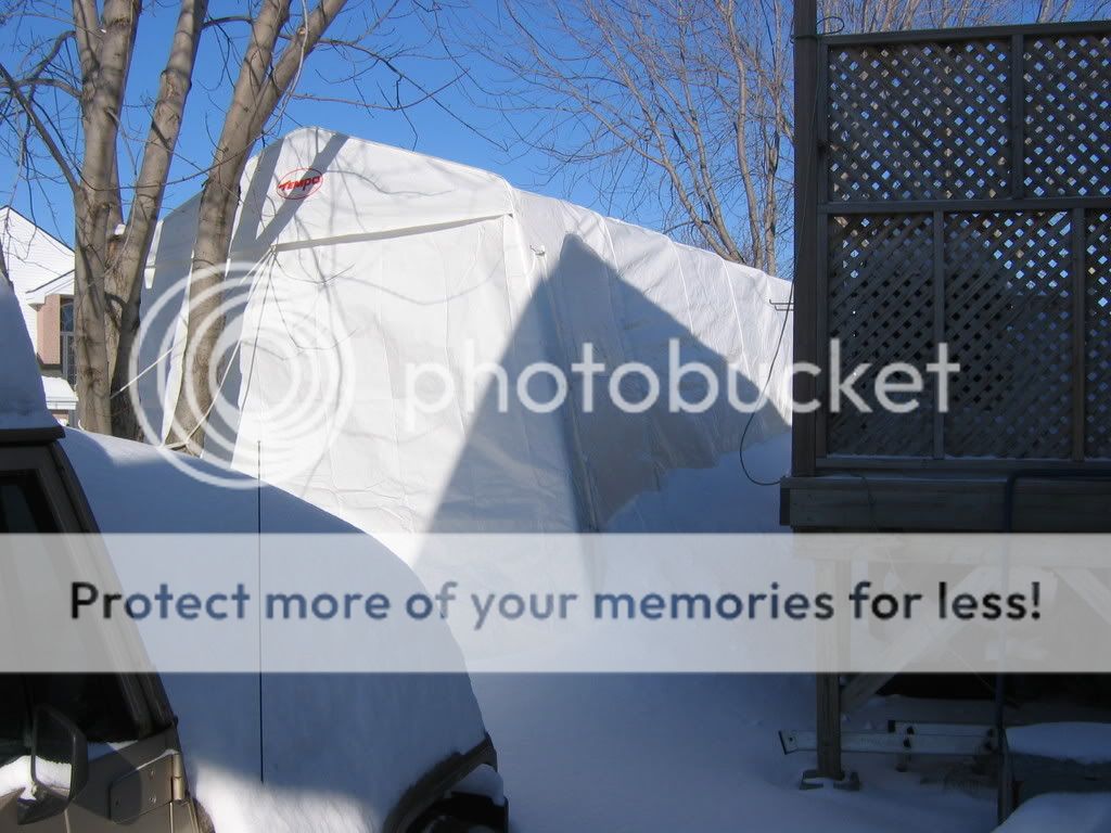

Hi Markaram,
Due to a rush situation (I had to leave due business) I found a fix for my problem by investing into a big car shelter (call "tempo"). It was expensive (1200.00$) but I simply trailer the Sailboat into it and close the door. I was able to get access a few time. The dimension is 11 ft wide by 9.5 feet high and 32 ft long. I have a micro climate inside.
On your tubing concept, I am curious. Do you have some pictures?

Hi Marc,
looks great...
that portable garage and you
can work on the boat when the weather
is favourable.

I have one of these too, but not for the boat. A dome-shaped roof that still needs to be cleared of heavy snow. And I have a 'micro climate inside' inside mine as well...grass grows in the winter-time!...found a fix for my problem by investing into a big car shelter (call "tempo").
