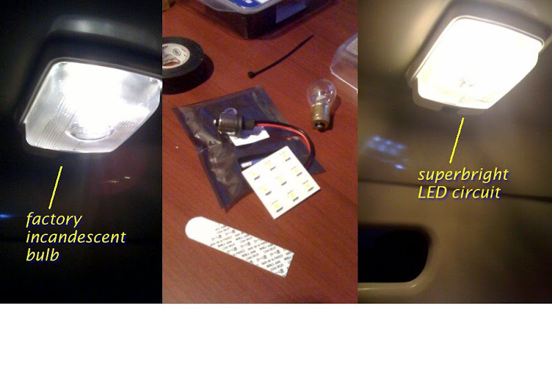

Thank you all! I followed your suggestions and have replaced the two primary light fixture incandescent bulbs with the warm white LED boards. WOW! I really like them and they are cool to the touch which will really help cabin temperature in the hot humid dog days of summer! Thanks for pointing us at these!
Left, original factory lighting. Middle shows LED with original bulb. Right, new cool and low power LED lighting!
... Doug

Hey Doug where did you get your LEDs ? They really look nice. I order four from a China trading company. Not one of them worked! But did get refund for bulbs and shipping. I like the plug and play/use idea of your lights rather than trying to mess with wiring.

I got them at www.superbrightlights.com. They were not cheap ($21 each) which is why I only got two of them. They look great! Warm coloring and bright!

Same bulbs many of us have posted about earlier in this thread. I have four in my boat. Great brightness and great color, not harsh white like many LED's.
1156-PCB-WWHP9, $21.95 each
They simply plug into the standard bayonet base like changing a bulb. I then put a layer of insulating material on the back of the PCB board and just cable tied them to the base. Once in, the plastic lens from the light just snaps back on. Each took a couple minutes to install.

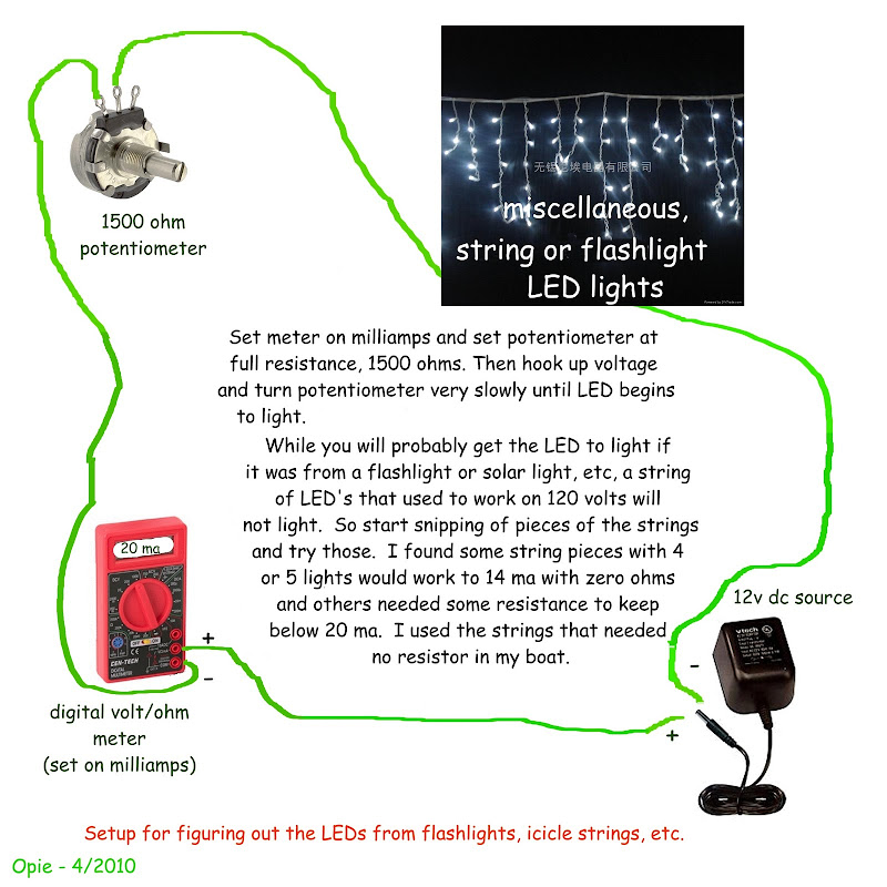

It may be of interest to those that like to tinker with stuff that working with random LEDs in a do-it-yourself manner is not as hard as it may seem. There are wonderful LED lighting products out there and they are getting cheaper all the time. But if you would like to play around with bargain LEDs or LED lights that are found in flashlights or holiday lights, etc, here are some tips below. Some comments:
- Most flashlight LED lights or portable LED lights will need to have wires soldered onto them. If you are not comfortable with solder then those lights will not be useful to you. Same thing goes with LEDs that are part of circuit boards or electronic devices. You will need to unsolder and resolder wires. I salvage all sorts of LEDs by soldering. I have a flashlight 9-LED module as my cabin lights in two places.

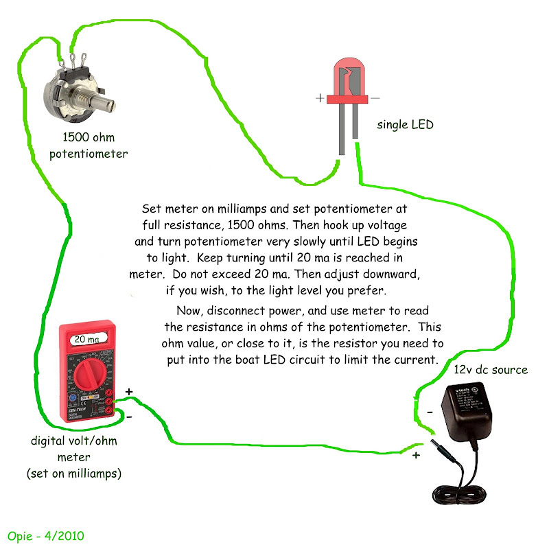

- individual LEDs will need resistors to work without burning up due to high amps. But, strings of LEDs usually drop enough voltage over themselves that they do not need resistors to work. That is what I found when I bought a long string of LED icicle holiday lights from Ace hardware in January for $5. 150 LEDs altogether for that low price. A real bargain if you can take them apart as I mention below. The funny thing with that string of icicle lights was that there was no transformer or resistor in the entire string. Those smart engineers who designed it used the dropping-voltage characteristic of the many LEDs to exactly limit the amps to the correct level without needing dropping resistors or transformers. When I evaluated the LEDs in groups and indivdually, there were several types of LEDs in the package. Some dropped more voltage than others and some needed resistors to work on my bench and some self-limited the current to 14 ma.
- I will leave out all the LED theory. That is found all over the net. And although I am a electrical engineer by education and trade, I do not use a calculator to figure out circuits and resistor values when doing stuff like this. I find it is better to test stuff with a meter. And in that way the do-it-yourselfer can enjoy the game without going back to school to learn electronics.
Here is my suggested method of figuring out LEDs to use on your boat. After you figure out certain LEDs or strings of LEDs or flashlight LEDs, then you can use the same method below to hook up combinations of your findings in series or parallel to make the best lights for you. For example, I used two of the 9-LED flashlight modules in parallel and put them inside a glass candy jar lid and epoxied the bottom to make my mast-top anchor light. The 9-LEds were in parallel and with the 3 AAA batteries as originally packaged it drew 85 ma (about 9 ma per LED because they are in parallel.) When you have parallel LEDs in your original device, the milliamps add together to form a larger total. When LEDs are in series, all LEDs receive the same milliamp value. That fact takes some thinking and looking closely at the LED wiriing.
- Well, I think I have already exceeded the complexity of discussion that I intended to be for new do-it-yourselfers only. Sorry. I'll leave the rest for comments or contributions to this thread. (Notes: Meter is $3.99 from Harbor Freight, potentiometer is $3 from Radio Shack, 12v source can by your boat battery or other type of 12vdc adapter. I find working in the house on testing circuits to be easier than in the boat.)
