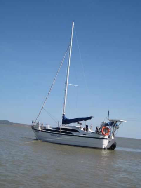

Picture is of "trust me" after a wild night where the rocking got so bad due to being side on to the swell,I thought the mast and rigging would come down, the swell was now on the nose and the wind broadside.
So got up and set it up and it worked a treat, we were still pitching fairly bacly but thats not really as much a problem when trying to sleep as roling from one side of the rear bunk to the other, especially when another bloke is there :o no boy boy stuff on my boat.

The wind was coming from a similar direction to what it is in the photo but the swell which was fairly violent was coming onto the bow, we were in a sheltered inlet but a cat owner had told us it was not good (I knew better :x ).
When we anchored we had 8m of water but during the night due to swinging and tide we ended up with just over a metre, outside it was blowing over 25knots and a 4-5knot current from the 7m tides.
While we had shelter from the wind it was still strong enough to point the mac into it most of the time but by putting the bridle on it pointed it into the swell and stopped it dancing, we did have both anchors out at 90 deg which usually holds it reasonably steady but with the scope needed for 8m and the change of tide it allowed it to swing a fair bit.
Thankfully I had picked up on the use of a bridle here prior and along with many other tips it was invaluable especially in a tricky area like the Kimberlies, we had to anchor in dozens of different circumstances made much worse by the tides and narrow areas trying to get shelter.
