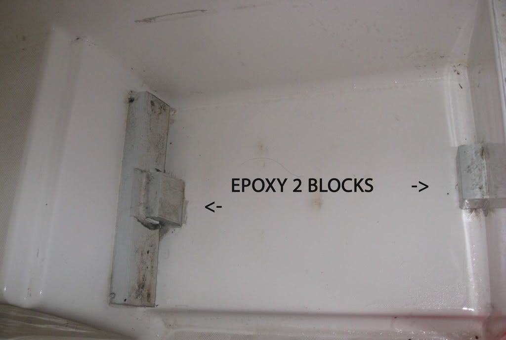

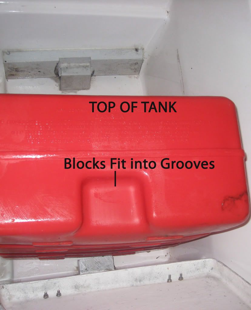

My 12 gallons fuel tank has grooves on each side. I cut two pieces of PT wood that fit perfectly in each groove and epoxied them on opposite sides of fuel locker. When fuel tank is lowered down inside the fuel locker it covers epoxied wood completely, takes whole width of fuel locker and looks good :wink:

@dxg4848,
I just looked at the picture of my tank and it too has notches on the bottom. This a great idea maybe complemented with 2 or 4 blocks glued to the fuel locker lid to hold it down. Thank you. :)

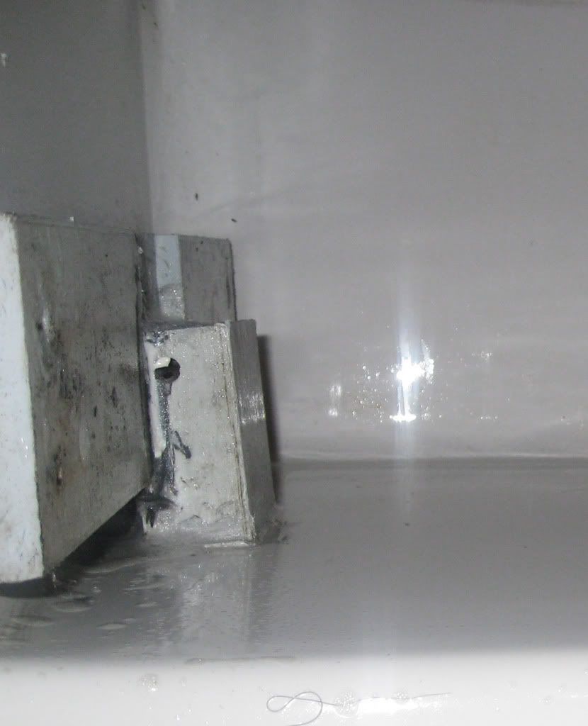

Not sure if your tank is the same as older ones but this is what I did 7+ years still holding up..........
From previous post:
OK, I was able to snap some pictures of what I did for securing the fuel tanks. The longer 2X4 is really just a spacer so the tank does not slide forward. I used PC7 epoxy to secure and caulked the edges just to make it more appealing. I also drilled a hole into the the blocks so I could run a line over the top of the tanks in case I needed more securing. This setup still allows for removal of a tank if needed. and a clean look when finished.
After I figured out what I wanted to do it really only took about 30 min. and less then $15 for epoxy and caulk.
I have had the boat over about 35 degrees with full tanks and there was no movement.

Mine came with black straps and flat pad-eyes. I like Matt's solution better. Very clever!
