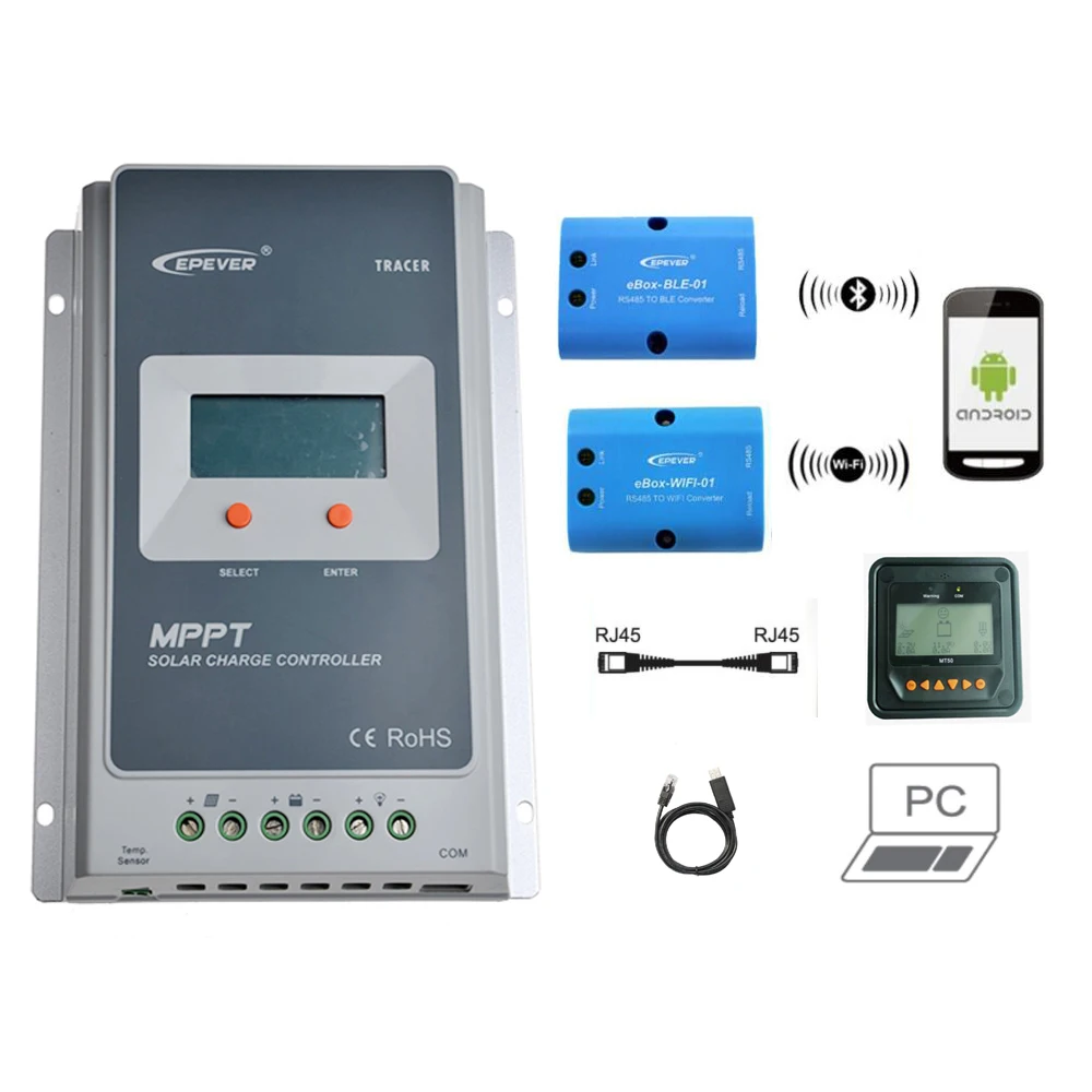

Tracer is a chinese model, but has lots of reviews and MPPT models with a remote and temp sensor for under $100. They have a bluetooth dongle too if you want to use your phone.
The display/remote has a lot of features. It shows you the amps volts coming in and the converted amps & volts going to the battery. So you can see a 100w panels gives something like 18v & 4.5A in and that its converting it to maybe 6A @ 13.5V to the battery. Another 1.5A for free vs PWM.
It also displays volts/amps/watts/watthours both input and output & program battery bank size and view battery percent similar to a battery monitor.
