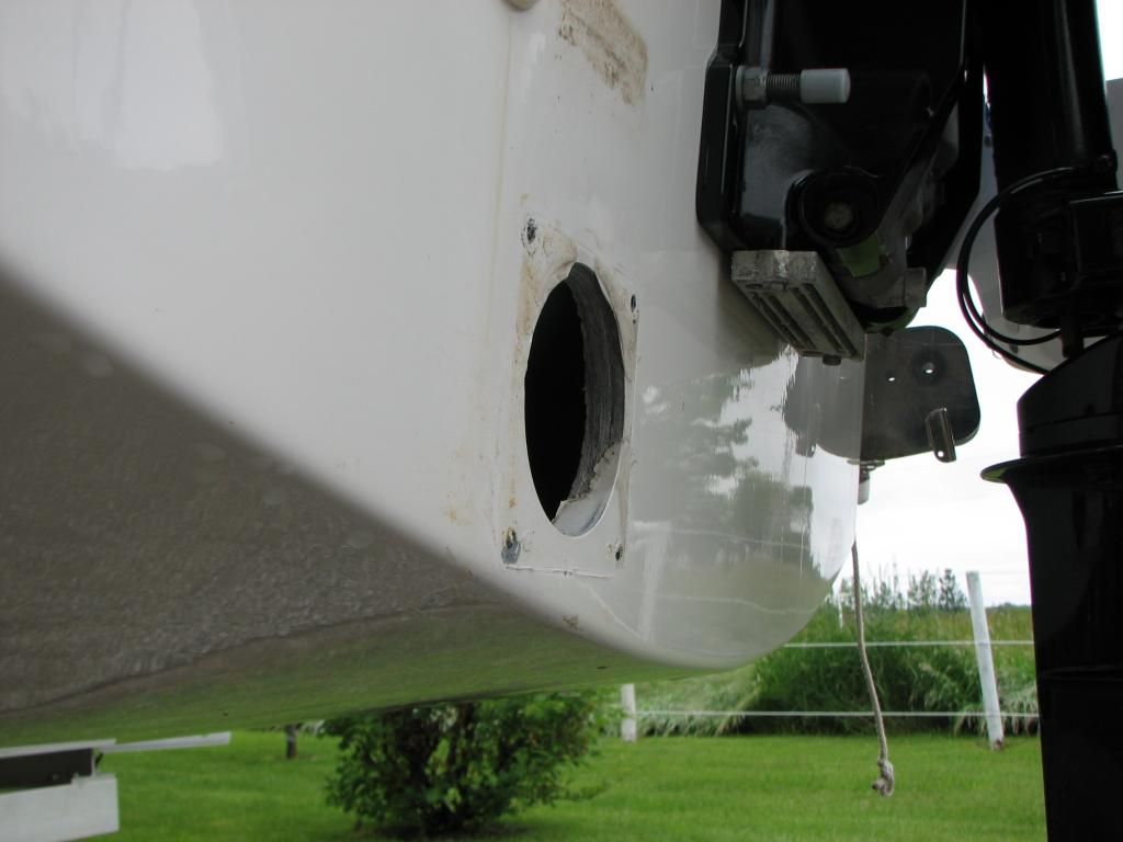

Unscrewing the screws was somewhat tough - make sure the head fits the screw perfectly. I had to clean the heads with a sharp tool first. There were deposits of coagulated dirt, salt and god knows what else. Once I got a good grip, I was able to get them moving even by hand. One of them did require a small battery powered screwdriver.
That was the first part.
The second part was sticking putty knives into the crevices on the side of the valve body, in order to separate it from the transom.
Patience worked, and the silicone (3M 5200) gave way after 30 mins.
Third part - removing all the residue from the transom wall and the hole. Razor blade and a sharp, flexibel scalpel did it.
At the end, I sanded both the hole and the wall with a relatively fine sandpaper.
I was not able to find 3M in EU at a decent price, so had to order a tube from the US.
Once it gets here, I will get to attaching the replacement valve to the boat.
I will reuse the screws, since I was not able to find the same kind locally.
