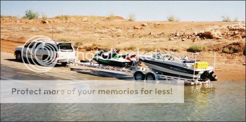

There's a company in NW Ohio that builds all kinds of boat trailers. They build only steel trailers, but do a lot of custom work. Haven't purchased from them, but have several friends with powerboats using their trailers and they've been very happy with them. You can get a quote from their web site.
http://www.loadmastertrailerco.com/index.htm
Here's one of their somewhat unusual creations.
