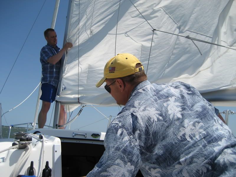

Dive,Divecoz wrote: Jim
YEA!!!! I can put that Carabiner in the parts box.. Now about your lazy jacks ? I dont suppose you have a link or a picture? I am leaving soon and I want good dependable but economical...
Here you can see the small carabiners ($1.79 for 2 or 4 at WalMart if I remember correctly) at the aft end of my boom. I was using two but in this picture one is broke so I am only using one and it is snapped to my poor man's outhaul (just tied the end of the foot of the sail to the end of the boom). You can also see my poor man's topping lift tied to the end of the boom.
The main lines of the LJ system go up to pulleys that are hanging down off the mast and then down the front end of the boom where they are snapped into padeyes with the same red carabiners. The vertical parts of the LJ are tied to the main line, taken under the boom through a padeye and then up to the other side and tied. I do have a small piece of duct tape on the main line to keep the knots from sliding downhill.
You can see the second set of carabiners in this pic just next to the boom vang. And you can see the "vertical" part of the LJ system coming out of my neck. The knot just aft of that is simply a Boy Scout "Taut Line Hitch" that I use to tighten/loosen the LJ system if it needs a little adjustment.
When I am putting the boat to bed I unsnap front and rear carabiners, pull the whole system to the mast and then secure it all under the sail cover.
Hope that helps. Definitely very inexpensive. And it works fine. Occasionally a baten hangs up in the LJ on the way up. Just lower the sail a little, pull on the leech (and ensure I am straight into the wind) and then right back up. Makes single-handing a breeze.
Good luck with your trip. Wish I could go along.
