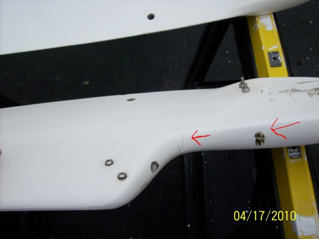

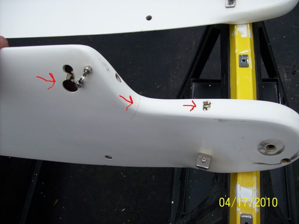

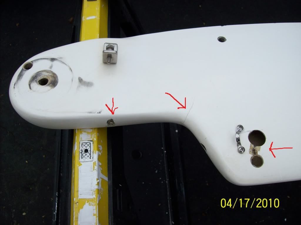

I went out and washed and waxed the boat getting it ready to go in for the season. I grabbed the rudders from the shed cleaned them up and they appear to be a little worse then I remember them to be at the end of last season. When I took them off I noticed what appeared to be "stress cracks" in some areas but not a major concern. When I looked more closely at them it appears that it is a continuous crack on both sides. (I know the rudders are a little beat up.) It slill may be a stress crack that is only on the surface gel coat.
The Idasailor rudders were on my wish list but I figured I would wait another year. I bit the bullet and just ordered a set. I was thinking of using these as a backup set.
Do they have any value? Are they worth repairing? Is the cracking "normal" wear.

That looks like pretty normal gel coat cracking Matt. I wouldnt worry about it. Always good to have a backup plan of course. 8)

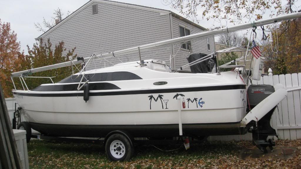

Here's a pic of mine on the boat

This picture is of an oversized (custom-made) IDA rudder. Joel will no longer make these (to the best of my knowledge.) These rudders are too big for the boat as demonstrated by multiple failures (snapping off just below the head.) The standard IDA rudder is very close to the same size as stock. I currently use stock rudders. The cracks shown in your pictures are most likely gelcoat only (non-structural.) Of course, impossbile to tell for sure without x-ray vision. One of my rudders has a simiilar crack. I"m not concnerned. I won't speculate about how well the standard IDAs will hold up, but I will say that they are solid plastic. The stock fiberglass rudders which are hollow inside should still be stronger than plastic. That said, I don't recall hearing of any breakage of either OEM or IDA without grounding (except for my large IDAs.) Not knocing the IDAs. I was warned by Joel that this size was on the extreme side and hasn't been tested, so I was taking a chance. I gambled and lost. My suggestion would be to keep the OEM rudders aboard as a backup, just in case.

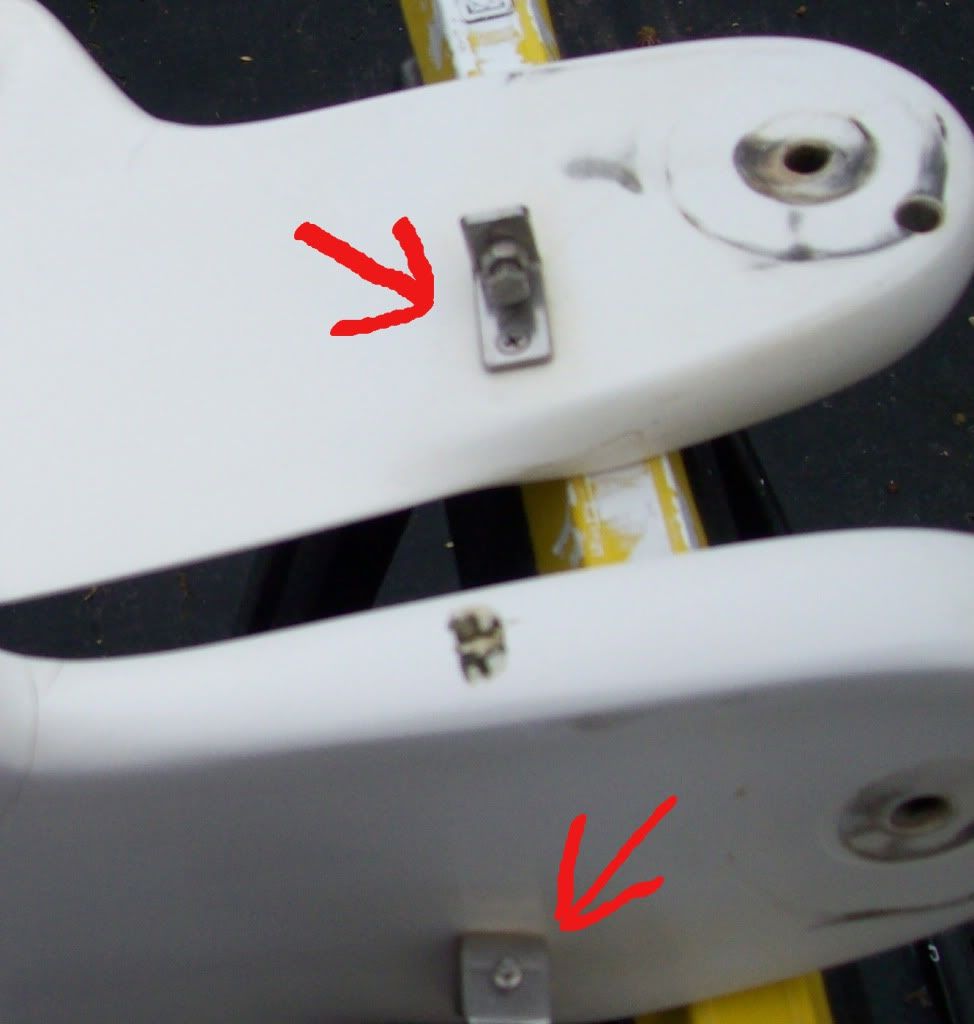

My stock rudders have a bracket for a stop on them (see pic) do I need to take this off and transfer to the new rudders or are the rudders stronger and I do not need it?

After further inspection there seems to be 2 pre drilled dimples where the brackets go so I am assuming I transfer brackets over to new rudders

Yeah, that makes sense, my :macx: IDA rudders don't have that, but then the two are different critters.
