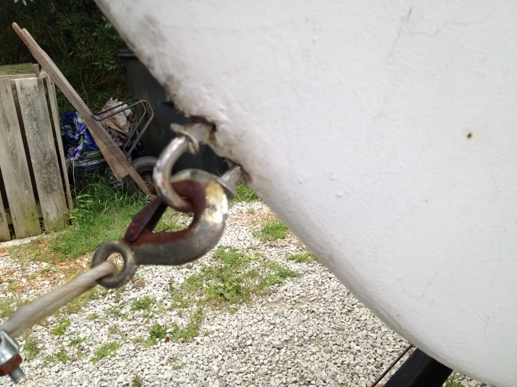

Hello all, and thanks again for all previous advice.
My elderly (but new to me) M25 has a 'D'-ring at the bow which has pulled out partially (see picture)Image. At the bow inside the cabin there's what appears to be a 'false wall' that keeps me from accessing the area where the ring should be attached; there's an opening at the top of it, but no way to reach over it sufficiently to access the area. Will I have to cut it away to access the area, and if I did, would I be able to tighten the ring in in any way?

I have the same problem with my M25, though not as severe. My plan this weekend, (or as soon as I get to it), it to cut a hole in the panel above the vberth for access and the cover it with a round hatch. Then I'll have access in the future if needed. I got mine from Ebay, but I think West Marine as well as Defenders have them. Robert
Re: Bow 'D'-ring issue
Posted: Tue Aug 14, 2012 5:51 am
by THE CUSCUS
Macgregor used scrap wood as a backing plate for the bow rings, so I'm sure your's is rotted out like all the rest. The circular hatch is a good idea to get in there. Search this site, there is plenty of discussion on how to and what to use as backing (the piece of pipe, split down the center gets my vote for the quickest/easiest fix).

In addition to what CUSCUS says, I would suggest adding as large a metal (Aluminum) backing plate as possible. Fair Winds and Full Sails....

Freedom77 wrote:In addition to what CUSCUS says, I would suggest adding as large a metal (Aluminum) backing plate as possible. Fair Winds and Full Sails....
This is the right way to fix it. (quote above)
I had the same problem on my D boat. Cut the bulkhead out to get access. Added a section of thick wall aluminum pipe, that I had cut in half lengthwise. I made it about a foot long to spread the load from the bow eye. glued it in place with plenty Marine Tex. I also filled in the original hole with the Marine Tex and re-drilled them, for a tight fit.
I had a spare cover, from one one of the storage areas, that I used to cover the area, where the bulkhead was cut out. I cut a panel to the right shape and fit it in place. It all came out looking great.
And...... the repair is so strong, the bow eye could probably hold the total weight of the boat, without pulling out.
