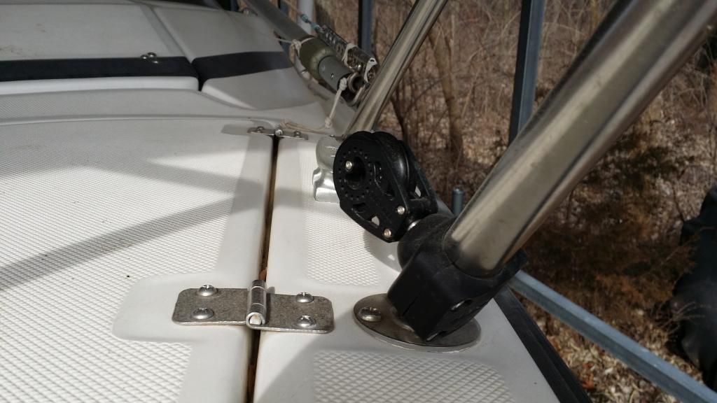

Azzarac
Posts: 215
Re: genoa furling line routing change with johnson lever
Post by Azzarac »
OK, as promised, a photo of my Harken clamp on block.
I tried to find the original receipt after looking it up on Amazon:
http://www.amazon.com/Harken-Furling-Sy ... +stanchion
They want $52.27 for their's but I am pretty sure I bought it from a shop in Lenexa, KS for $10-15 bucks.
Good luck with your mod. Hope this helps.
I used the clamp-on bulls-eye type fairleads like the Spinlock WL/1 further back on another boat, for shallow angle changes of the furling line. Cheaper than sheave types at about $20, and for shallow angles of bend, not enough friction to be noticeable. But a ball bearing block like the one in the picture above is best for that last turn.
I have small ball bearing blocks clipped to my lifeline stanchions with shackles now (but with the original stand-up block near the furler), but it's not so good as if the line gets slack, the blocks and line can get tangled and jam. Too much of a good thing (ball bearing blocks) is not necessarily a good thing. :wink: One of these days, I'll change them out for the WL/1's, for both the furler, and the spinnaker tack line.
Post by Falcon6086 »
I also used the harken clamp on blocks on the stantions, I actually bought 2 and put 1 further back on the stantion to help run the furling line and it works great. but i found that I feel i need to move the hounds up father than 8 inches? did anyone else find they needed to do that?
But those little blocks work well as they swivel and tilt to meet the angles needed to keep the line from chaffing
