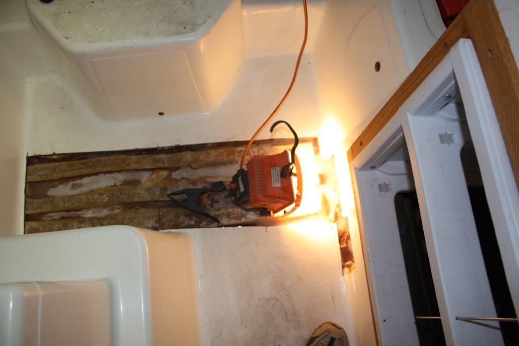

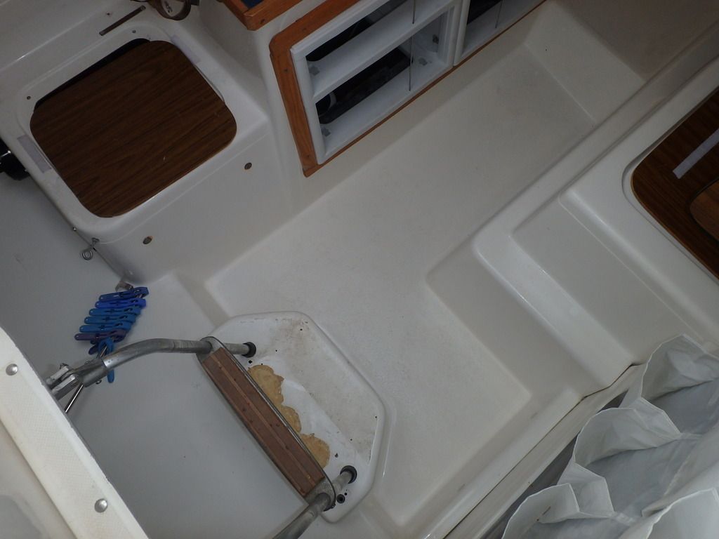

We developed a leak from our ballast after trailering to the coast and hitting some rough bridge repair work. Bugger of a place to get to. About 4 boat bucks to get it fixed.
After
After

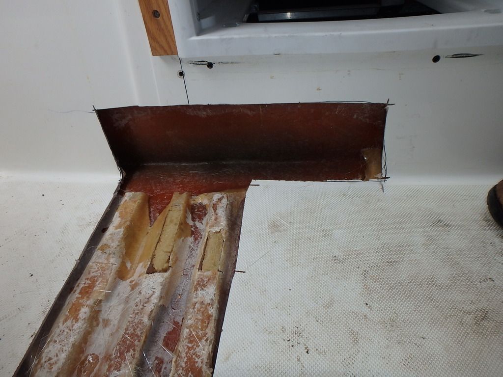

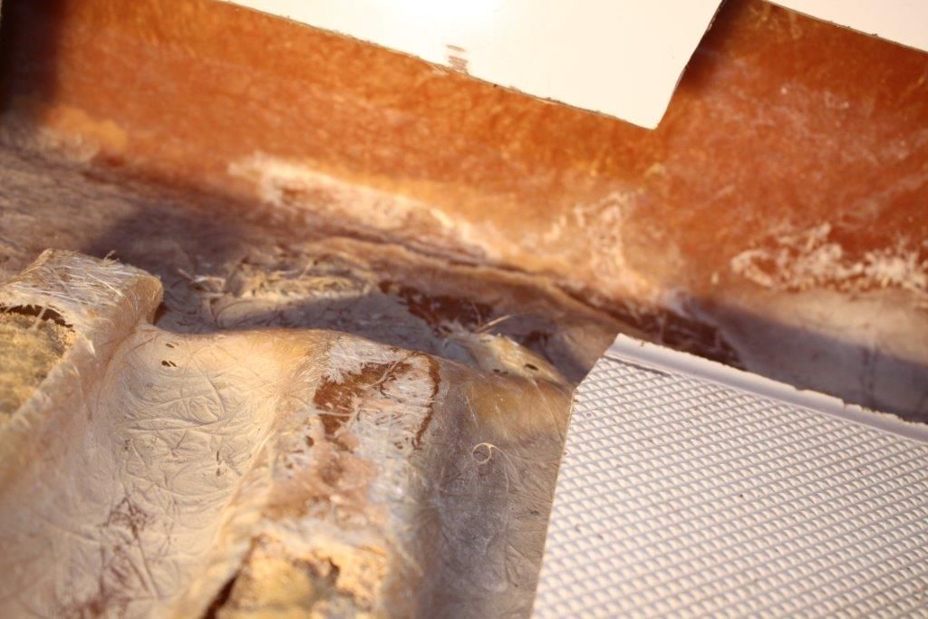

Re: Ballast Water Leaking into Bilge
The crack was right by the galley/battery box area but the water was going under the floor and pooling on the starboard side. There are fibreglass reinforcement channels formed over foam that made finding it very difficult.
They did a nice job cosmetically finishing that. Do you have pics of the actual repair? Is it a design flaw or a manufacturing defect? The ballast tanks in these boats a supposed to be the strongest parts
This is the only shot I have of the repair, which they said was really quite straight forward once they found it. I don't believe it was a manufacturing defect. We hit a couple of poorly marked pavement transitions that slammed us pretty good. I'm pretty sure that's what did it. We are on an M aluminum trailer with long bunks. it had 2 bunks, it now has 4
