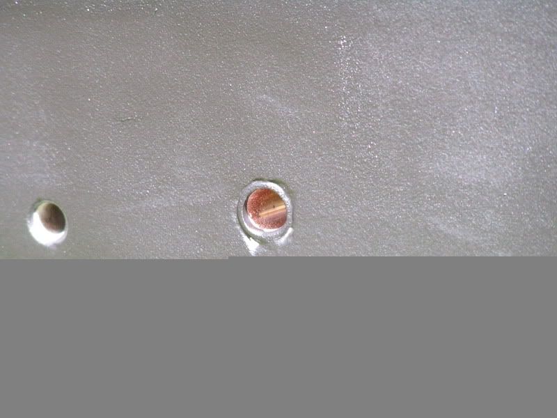

I did something similar to my keel, used a 1/2" copper fitting to make a bushing and epoxied it in place. Seems to reduce the slop and I have had no problem after two seasons of use.
I hope the image shows(my first try)
Looks like you got the format right, but the image isnt on photobucket any more....

I put my center board back in today. After reading about the pivot hole wearing, I looked for something to extend its life. I found that a 1/2 inch copper water pipe fits nicely in the centerboard hole and around the pivot pin. Admittedly, it is not the best bushing in the world but as easy as it is to drop the board and replace it, I have a hundred year supply in my junk box. :macx:

Catigale wrote:Looks like you got the format right, but the image isnt on photobucket any more....
Well, the picture is indeed still there, just the name is not correct in his posting above. Here's the right pic, I think:

wtelliott
Posts: 22
Joined: Tue Aug 02, 2005 7:57 am
Location: Ishpeming, MI / '01 26X with 50HP Honda
Post by wtelliott »
My error, I had two photos on photobucket depicting the bushing in my board and deleted the wrong one. Thanks guys.
