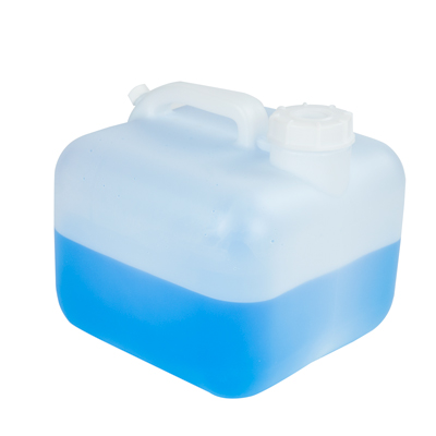

Not much because I use the smaller cans:
https://www.usplastic.com/catalog/item. ... emid=35803
I try to buy all my plastic needs from Mr. Tam's company - I have used them for many many years.
I just can't seem to handle the big 4 gallon jobs in my little inflatable kayak - they make the kayak feel like it's gonna get a hole when the tank is placed in the bottom! I can spread out about 4 of the tanks above along the bottom of my little kayak without stretching the bottom so far it scares me. :? The rounded corners are easy on the rubber bottom of the dingy too.
Here in SoCal it's mostly island hopping and water is always something you can go ashore and squirt a few gallons into these cans. Out in the Bermuda Triangle where Mr. Sumner sails I think bigger tanks and a better dingy would be a good idea! :|
The tanks I use fit inside the galley just like the old flexible tank - so I use the stock pump that came with 'boat'. I just changed the hose that feeds the pump faucet with a hose that fits my tanks - when a tank is empty I just yank it out and put a new full tank from under the dinette where the daggerboard is and slide the full tank into the galley. It's really easy and quick - for just the wife and I we only need to change tanks after several days. For the shower I just put one 2.5 gallon tank into the shower heater and thats enough hot water for 2 showers and a day of dish and hand washing.
The small tanks do not make a real big difference on the balance of the boat - I suppose if you were moving big tanks it might make a slight difference.
