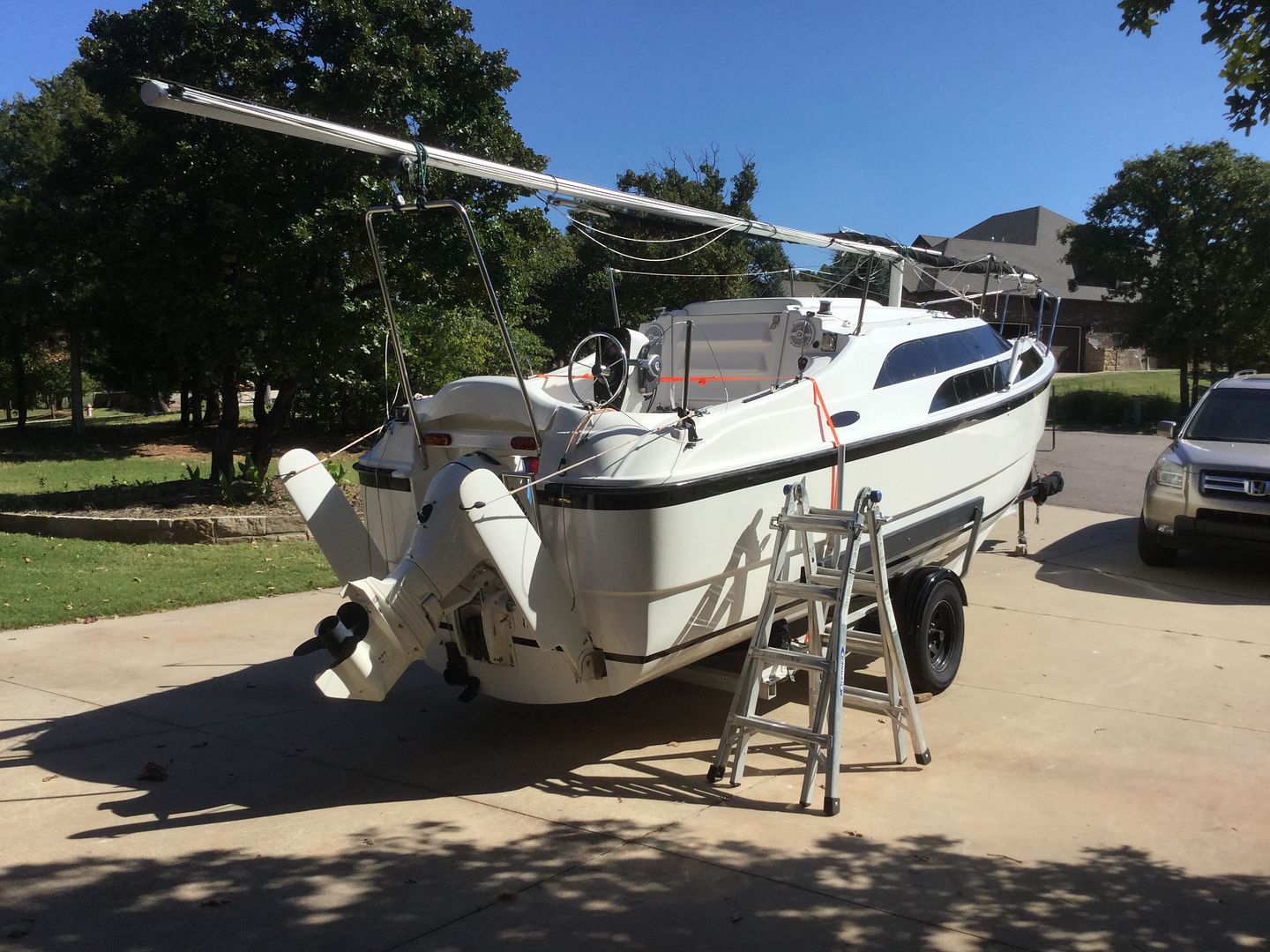

I used a length of pvc downspout and some led lights. I cut the pipe to fit just above the outboard. The assembly is removed for putting the boat in.
