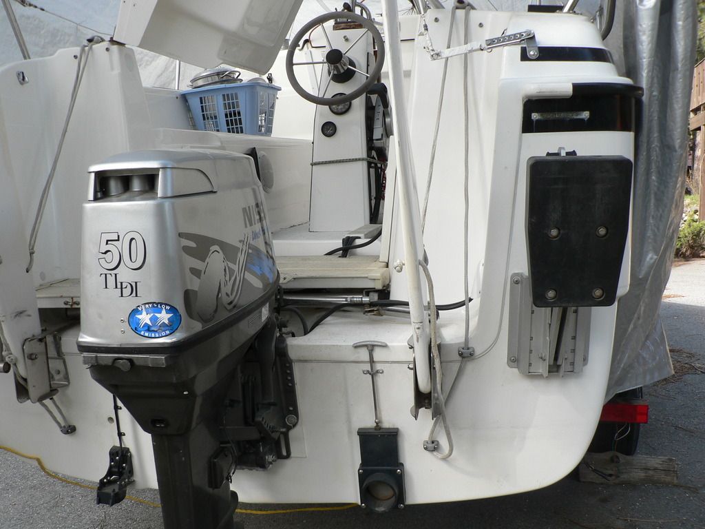

Installing a motor mount on an X is fairly straightforward. I believe mine is a Fulton. When I trailer with the kicker mounted, I pull the mount all the way up. When I'm motoring with the big engine, or sailing, I have to lower the mount partway, so that I can tilt the kicker up enough to keep its prop from dragging in the water. I started out using a longshaft 3.5 2 stroke as a kicker, but switched to a 2.5 4 stroke with regular shaft length. It's worked fine, and its 28 pound weight is manageable for manually transferring on and off the mount, without having to resort to a rope and pulley system.

I had Todd at BWY install the mount, but I don't believe the liner posed problems. I'm pretty sure the removable vertical panel at the rear of the king berth gives direct access to the interior of the hull. My kicker is a 2.5 hp 4 stroke Suzuki and I've been really happy with it. Starts right away, runs smoothly, has a reverse gear, and seems to be a well designed motor. I especially like the twist throttle on the steering handle. My old Nissan 2 stroke had a throttle control lever on the cowling, which was inconvenient. I primarily use the kicker to run around in the dinghy, and secondarily, while trolling for salmon in the Mac. At 28 lbs, it's not too heavy for me to transfer to the dinghy and back onto the mount. I virtually never trail the dinghy with the motor attached to it, and so am transferring it to and from the mount fairly often. It can be a tricky operation on bouncy water, and I always worry about dropping it, especially when returning it to the mount. It pushes my 9.5 foot inflatable at a decent speed, but not on plane. It can move the Mac at 4 to 5 knots in calm conditions, but struggles in big chop and headwind. As far as an emergency backup motor goes, I've always considered it of marginal value, better than nothing but not by much. It would get me somewhere in flat conditions, but I'd have to regularly refill the internal fuel tank. In rough conditions it wouldn't be worth bothering with, but then, I'd probably be sailing. It would come in handy getting me around once I reached protected waters and getting into a dock.
