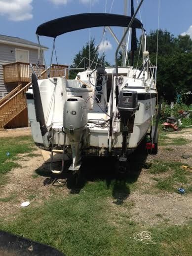

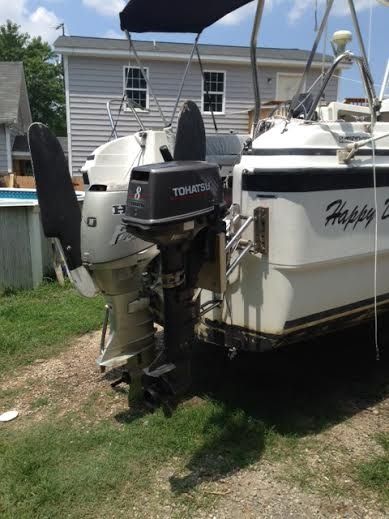

Why not keep your 50, and as I have done mount a kicker bracket? I have an 8hp Tohatsu Long Shaft (from my Vn23) mounted on it... have already lake tested the setup and can get decent hull speed with the 8hp. Drop the two rudders and just motor on, no lifting. If I do have an engine failure it takes a few seconds to dump the 2 stroke oil in the gas tank, give her a shake, and fire up the tohatsu.
