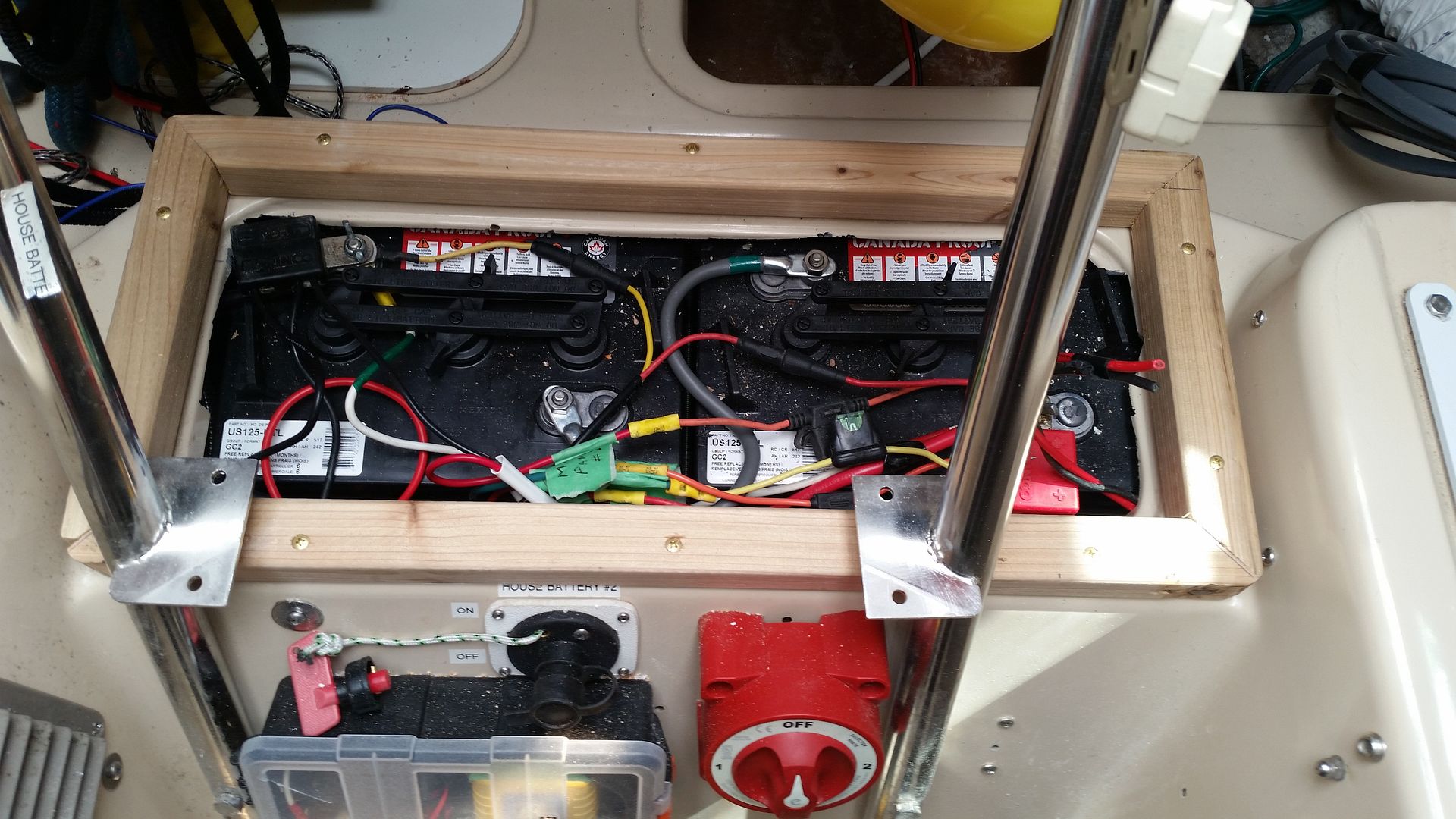

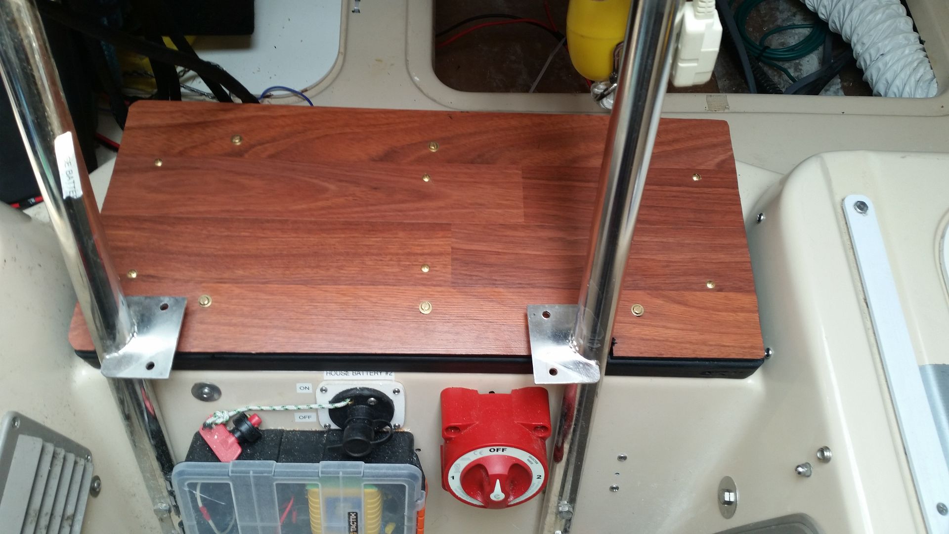

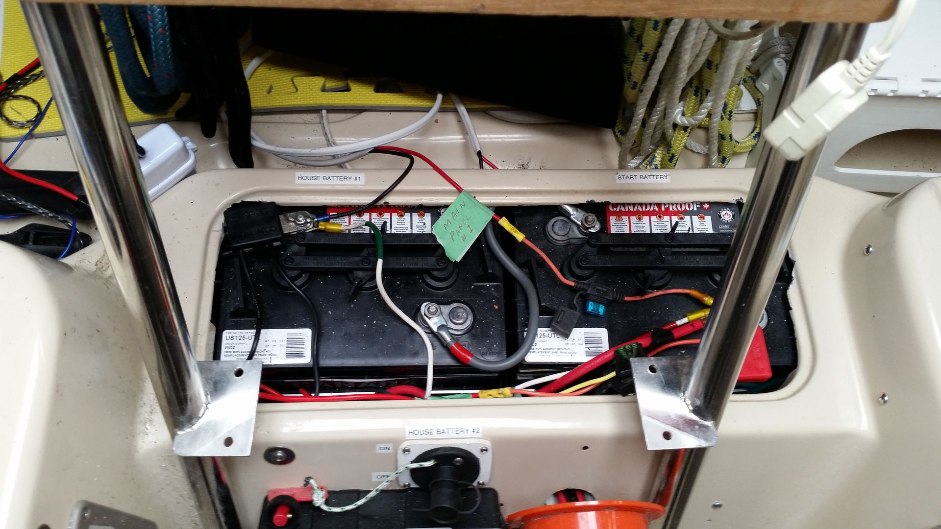

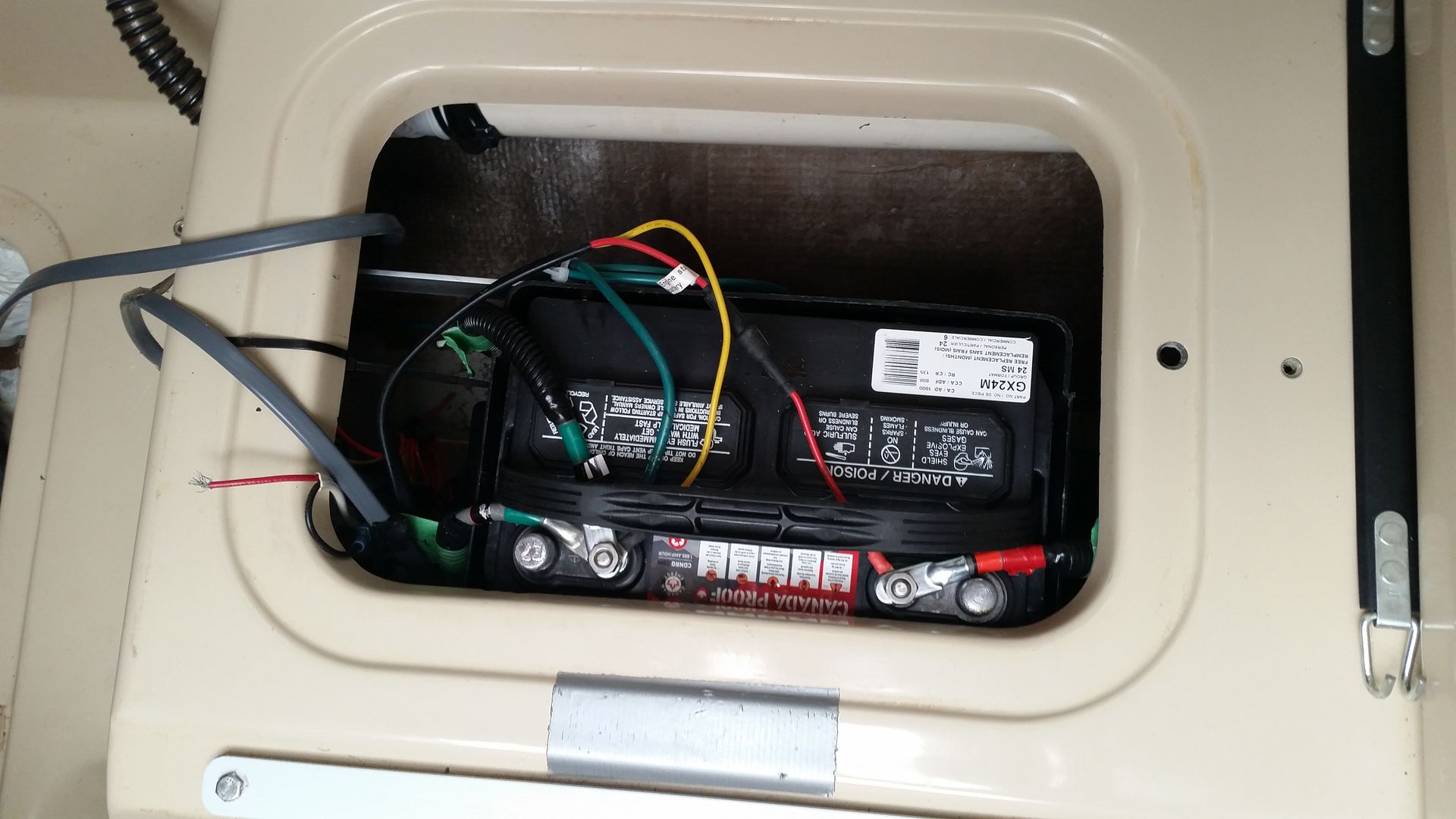

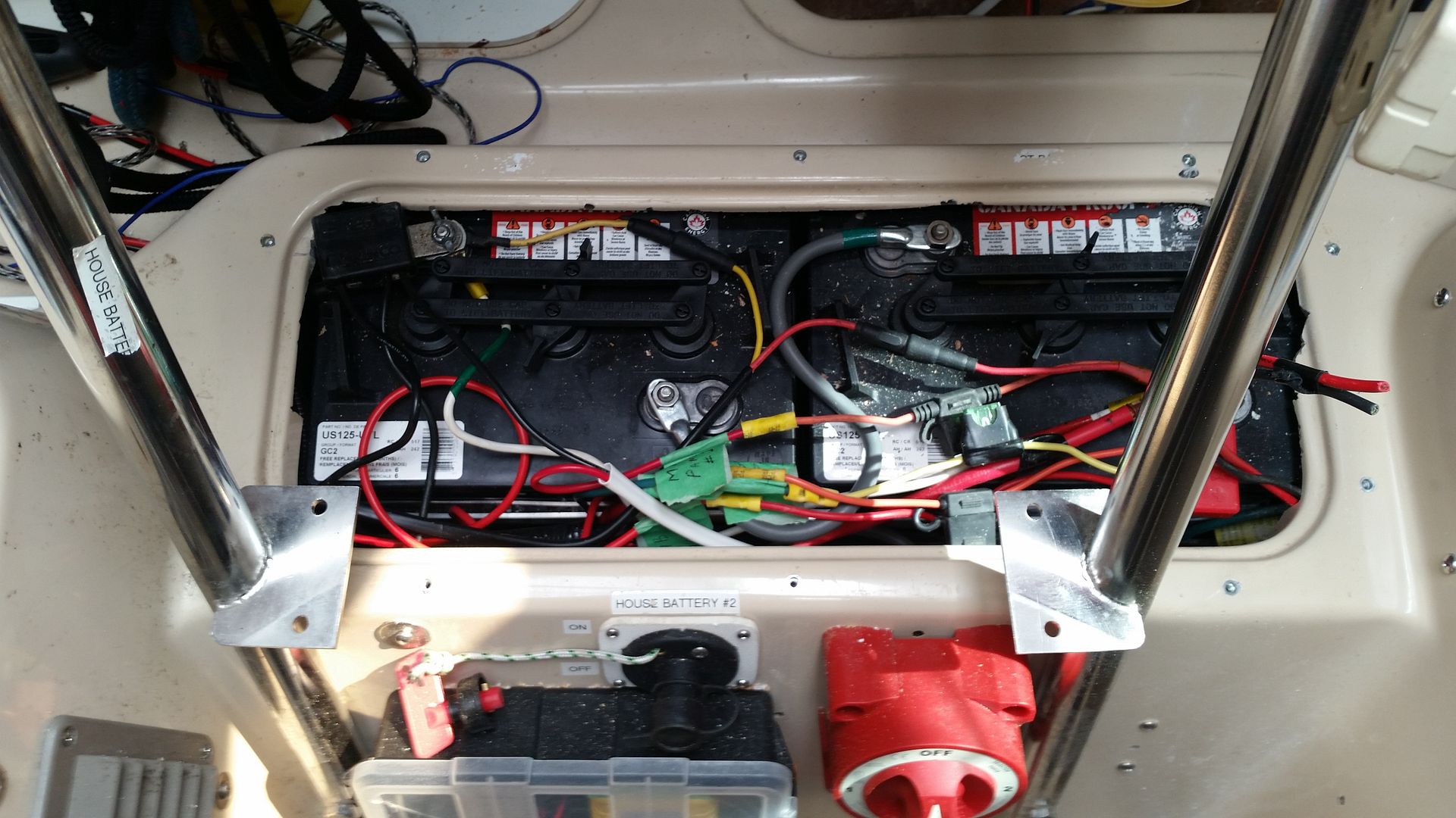

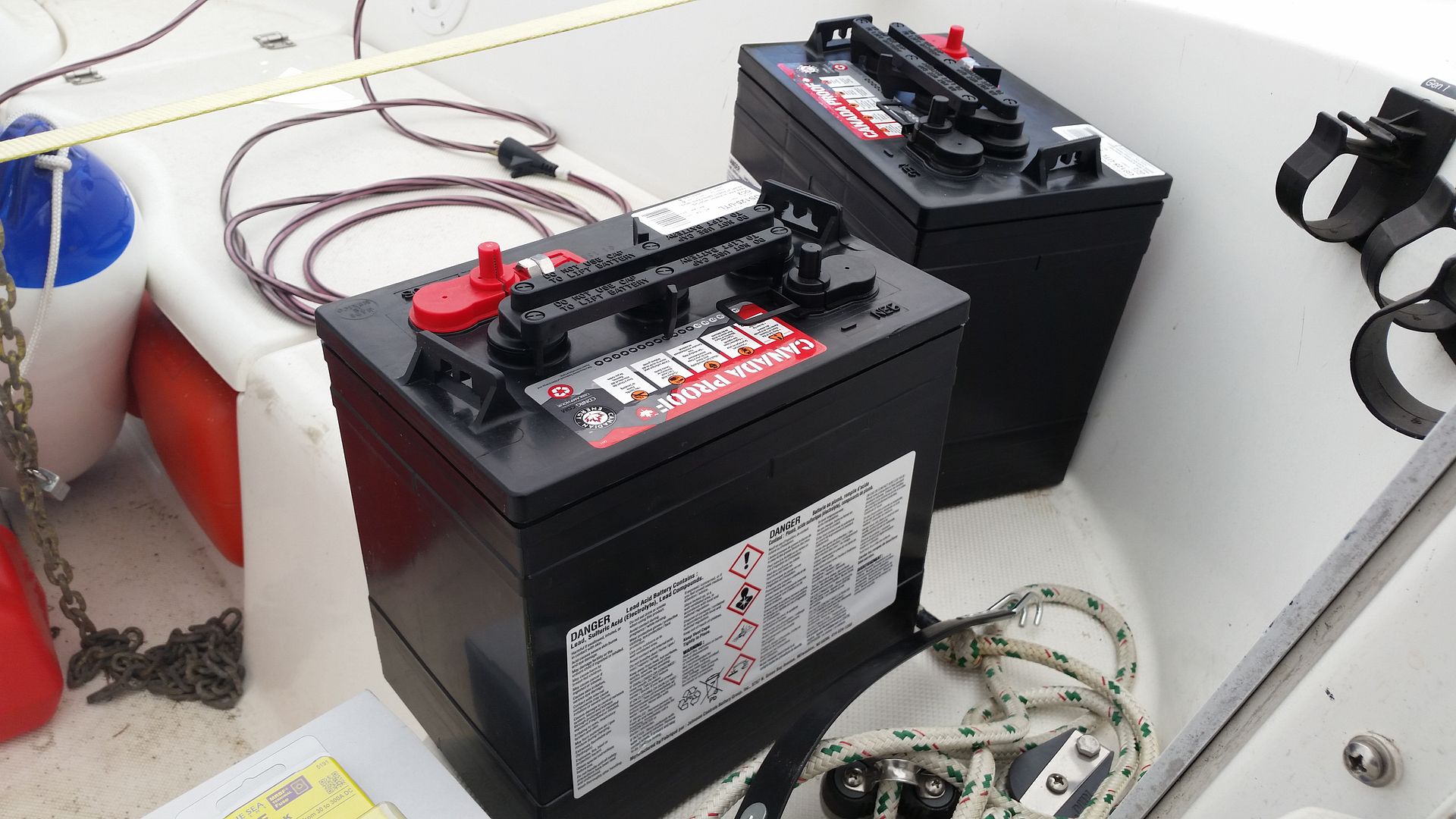

Well my 12volt house & start batteries gave up the ghost after 8yrs
so exchanged my 12vlt house batt to 2 x 6vlt golf batts
so now the two golf cart batts fit into the same spot the 2 old batts were
had too cut away bottom lip of battery box lid opening to allow for the taller golf cart batts
http://i844.photobucket.com/albums/ab1/ ... ni9zxv.jpg
http://i844.photobucket.com/albums/ab1/ ... am0jcy.jpg

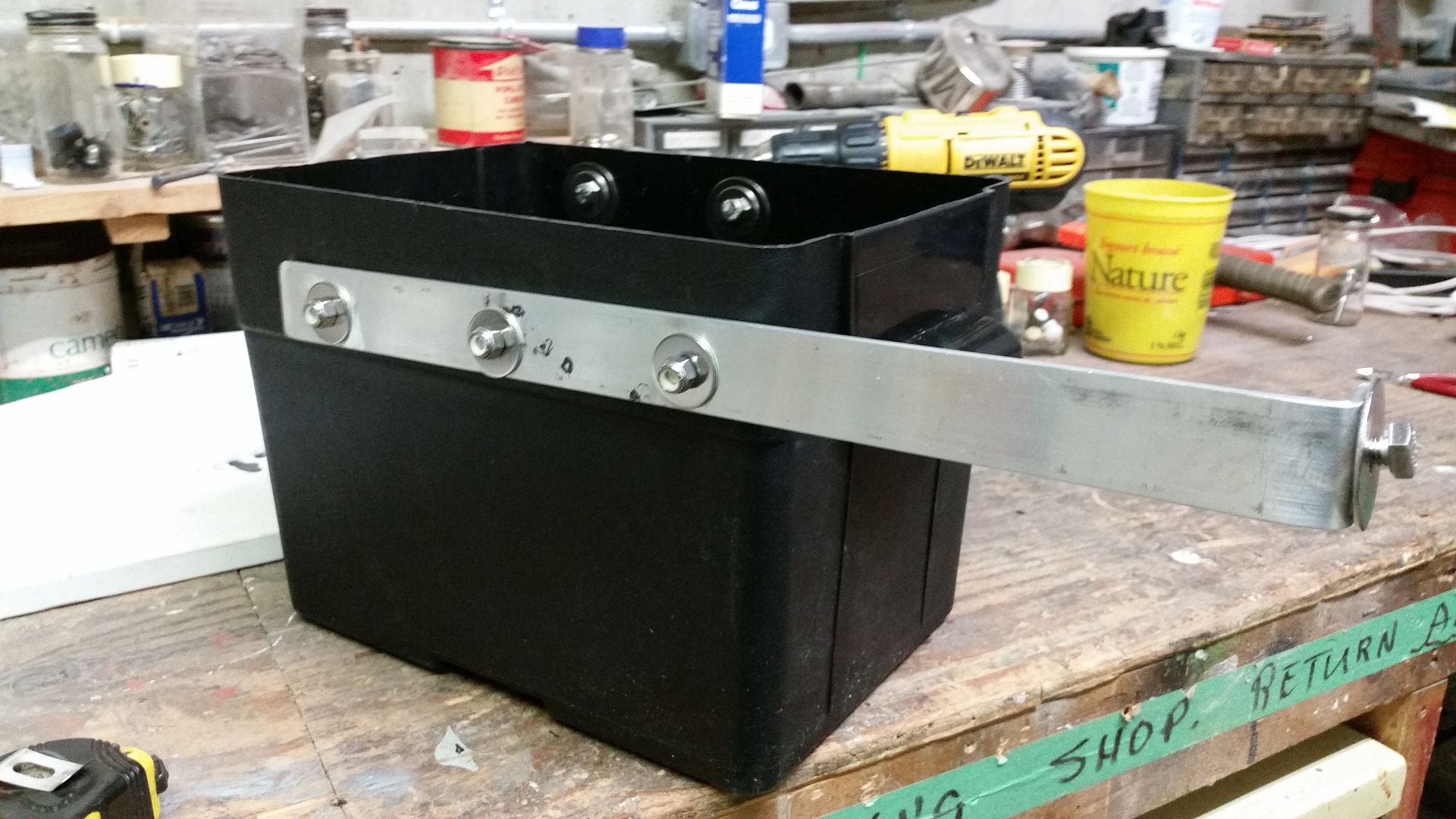

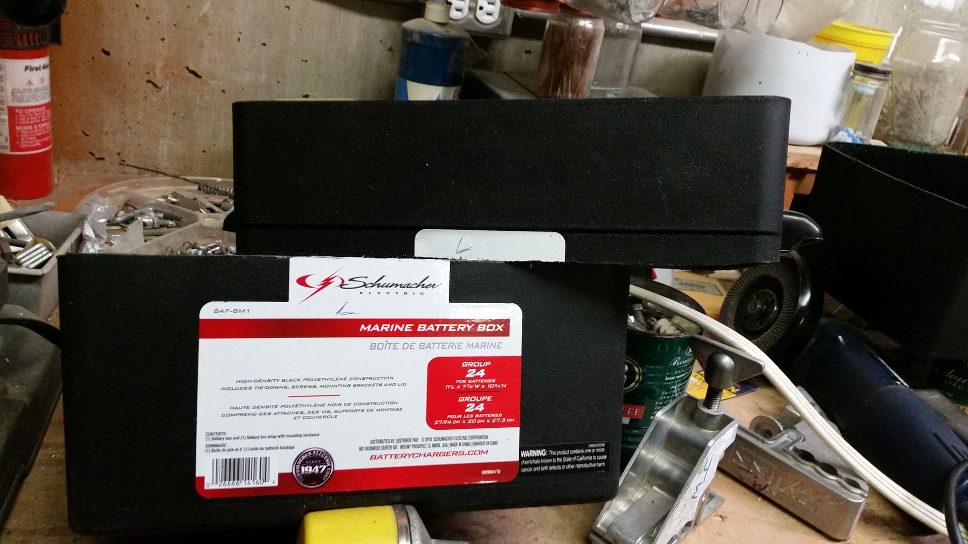

cut off top 1/3rd off new battery boxes to get rid of the battery box handles " not required " needed the space to fit these were the only battery boxes I could find that were the perfect fit from "Walmart" go figure !
http://i844.photobucket.com/albums/ab1/ ... njmkn1.jpg
now need to raise the height of the battery box
http://i844.photobucket.com/albums/ab1/ ... bsm4ji.jpg

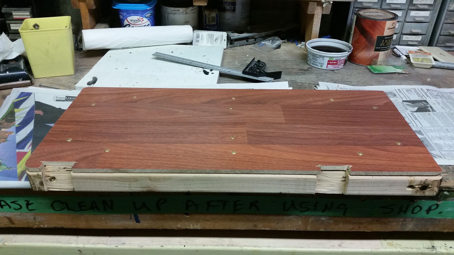

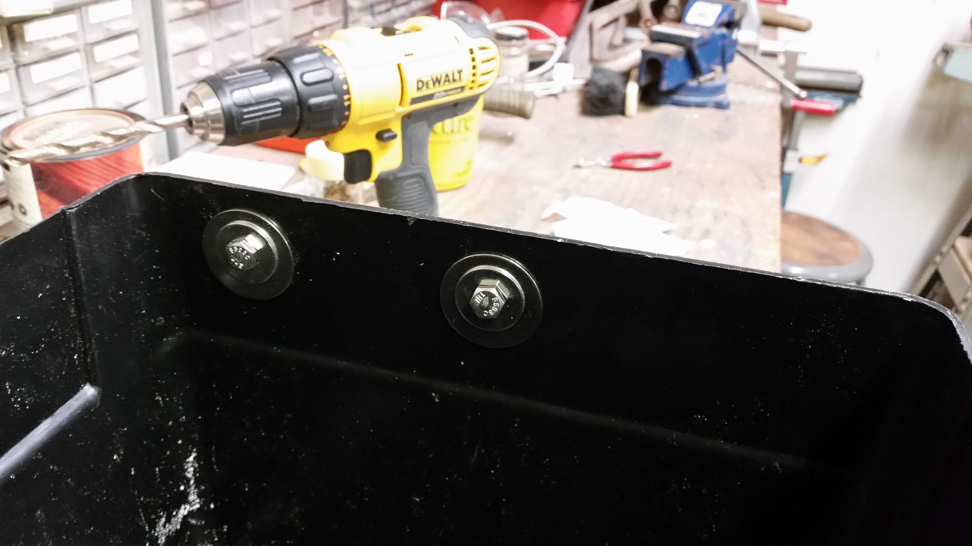

so made a cedar frame from 1 1/2" X 1 1/2"
http://i844.photobucket.com/albums/ab1/ ... 6jwqeh.jpg
Installed rivit nuts
http://i844.photobucket.com/albums/ab1/ ... k5rs5l.jpg
http://i844.photobucket.com/albums/ab1/ ... umyjjj.jpg

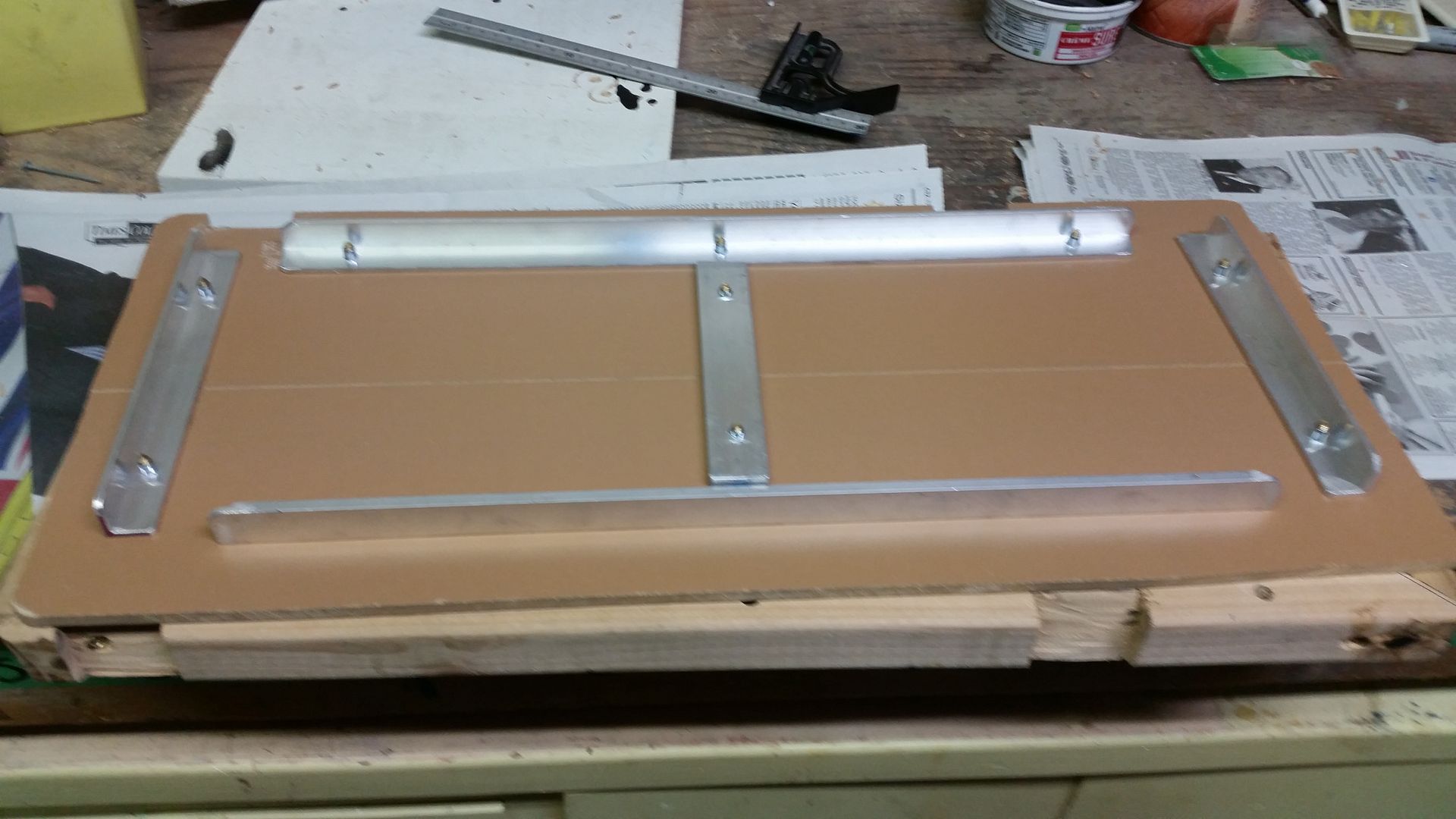

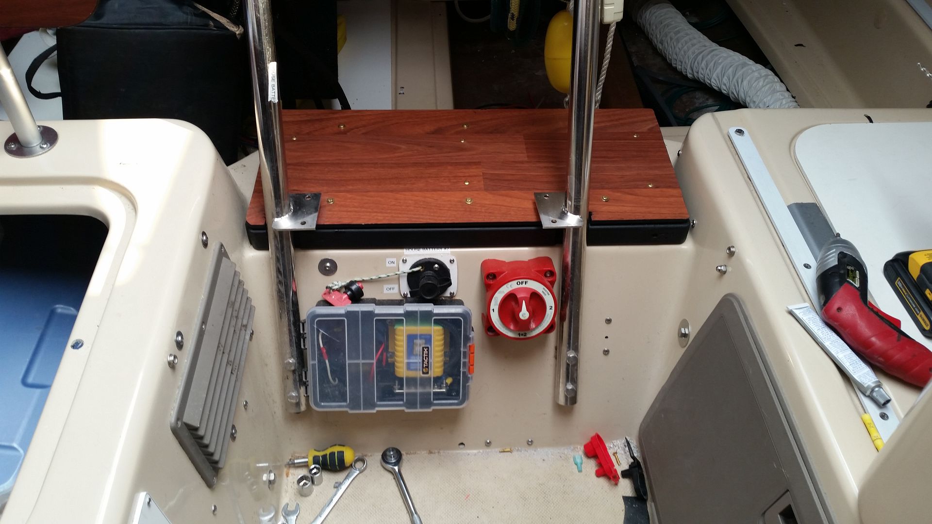

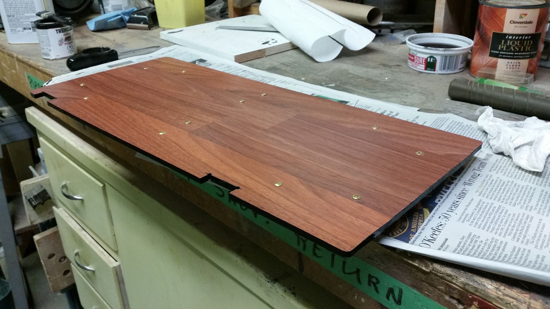

make new battery box lid
http://i844.photobucket.com/albums/ab1/ ... rg9l4d.jpg
http://i844.photobucket.com/albums/ab1/ ... x6ow0b.jpg
paint edge trim black for 3 - D effect
http://i844.photobucket.com/albums/ab1/ ... lmacne.jpg

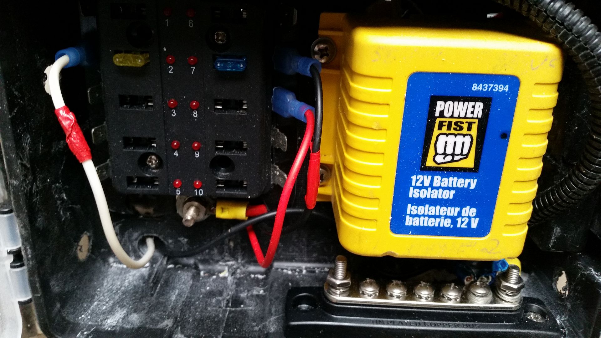

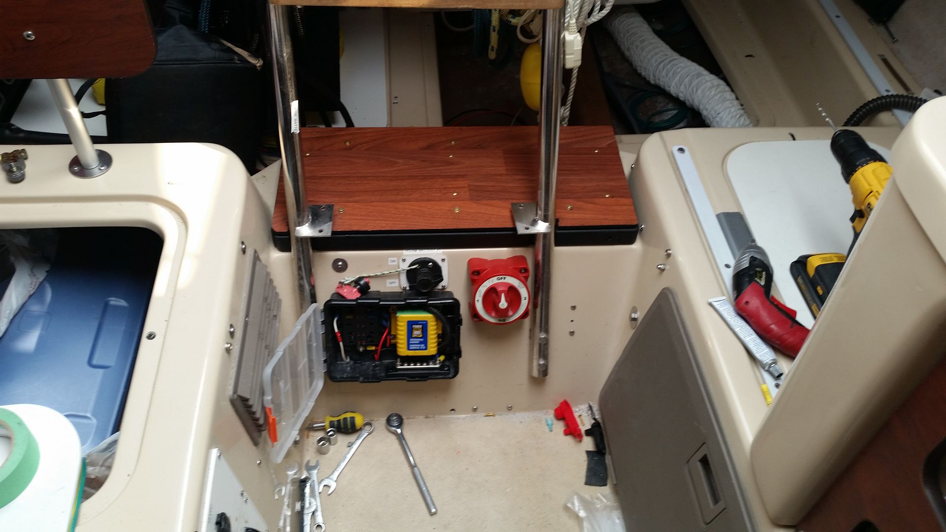

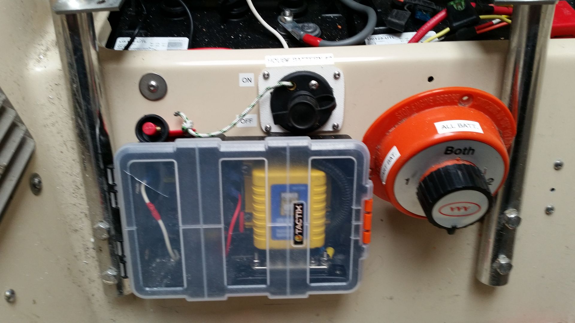

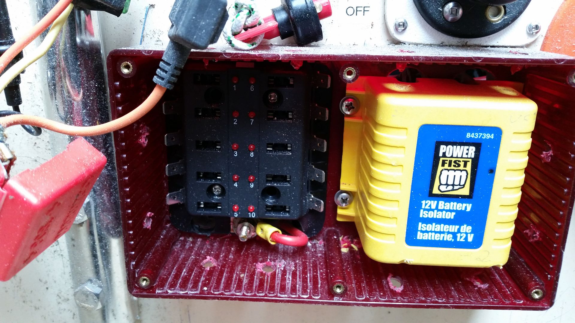

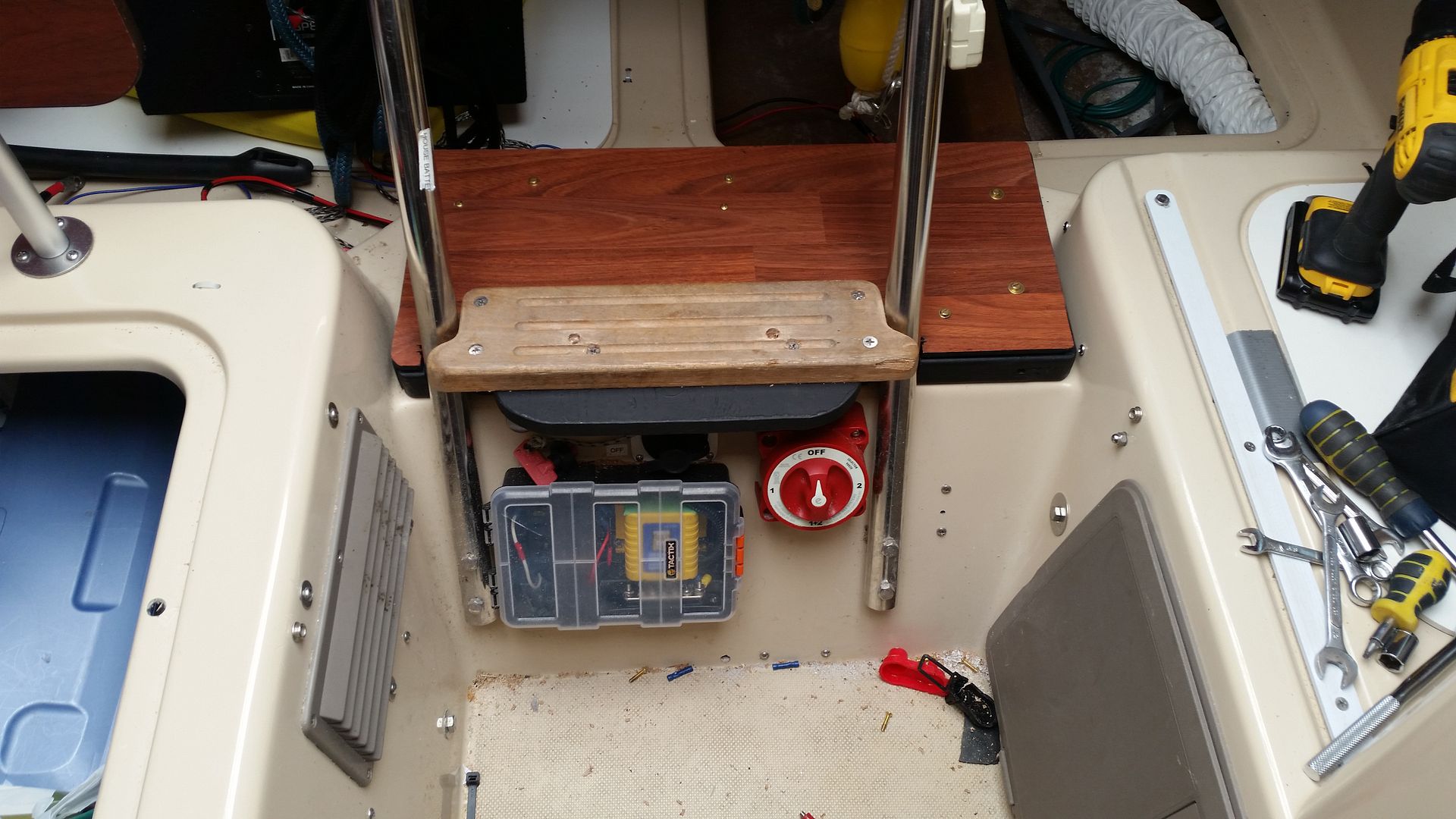

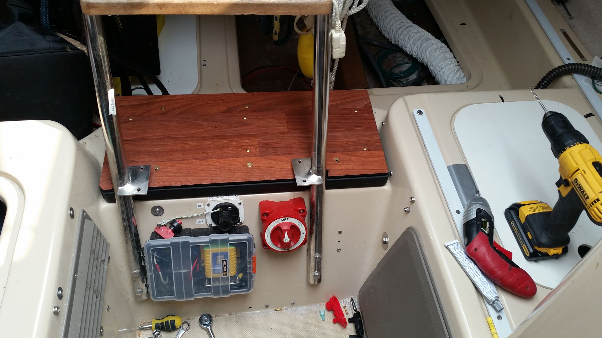

Painted cedar frame & while the paints drying changed this fuse panel box
http://i844.photobucket.com/albums/ab1/ ... caezew.jpg
to this one I made with a swing opening door as to a screw on one
http://i844.photobucket.com/albums/ab1/ ... izdci2.jpg
http://i844.photobucket.com/albums/ab1/ ... e6iedg.jpg
http://i844.photobucket.com/albums/ab1/ ... 078vwt.jpg

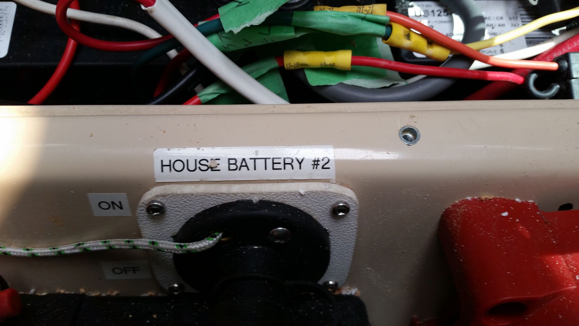

new battery switch also

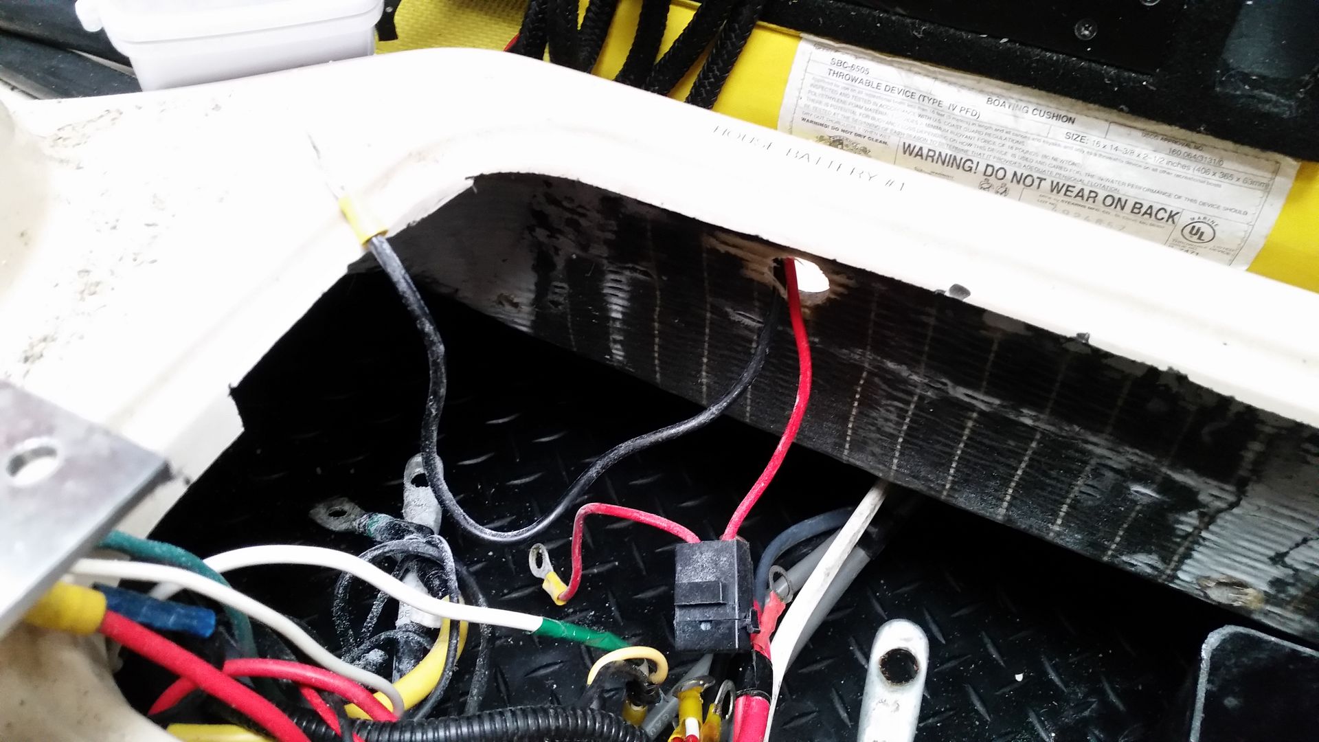

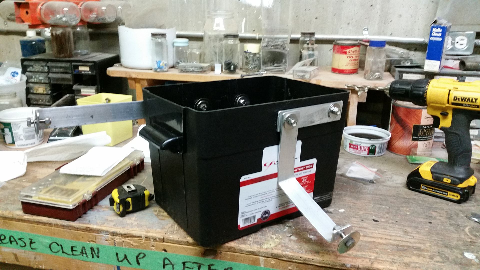

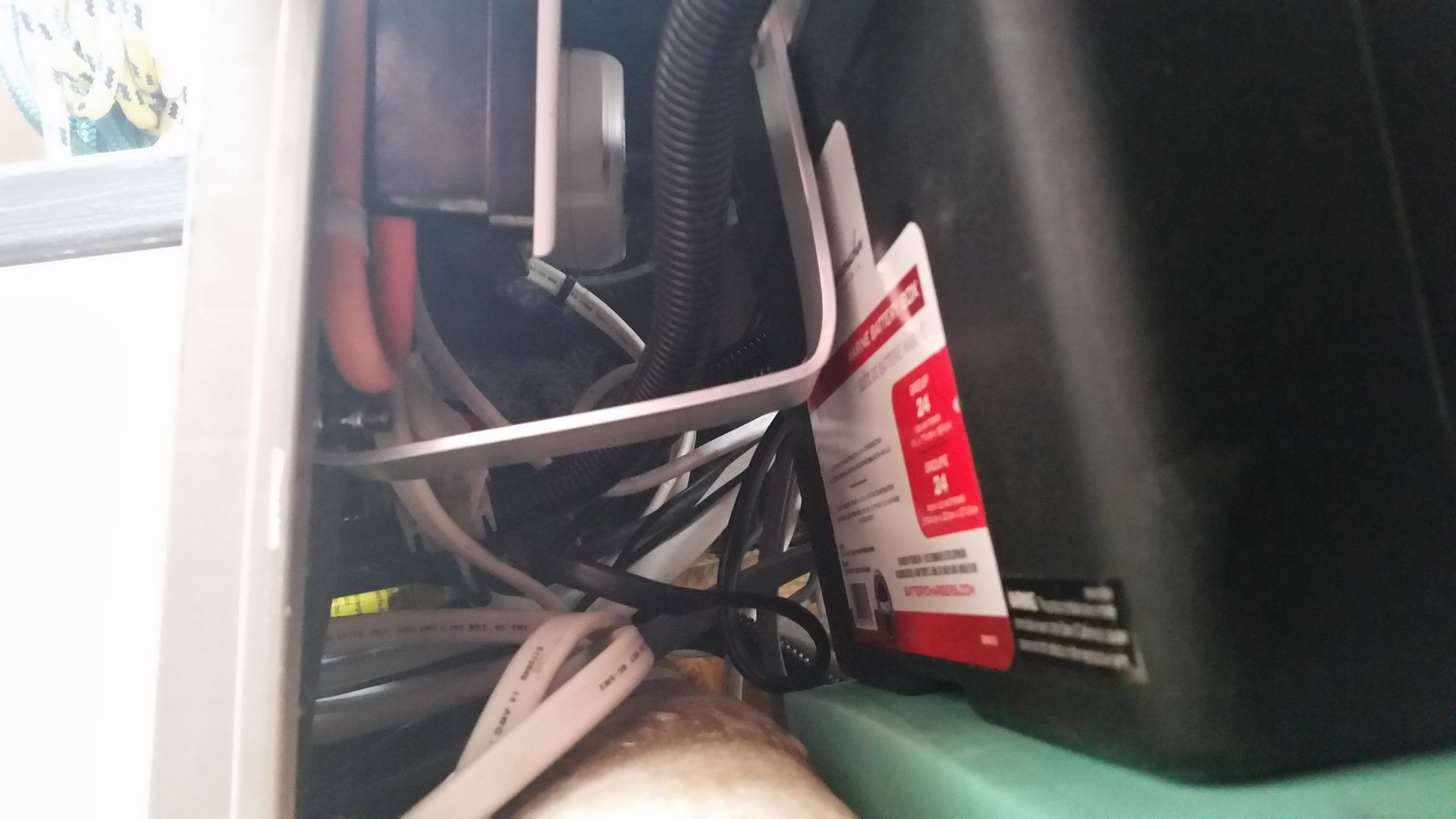

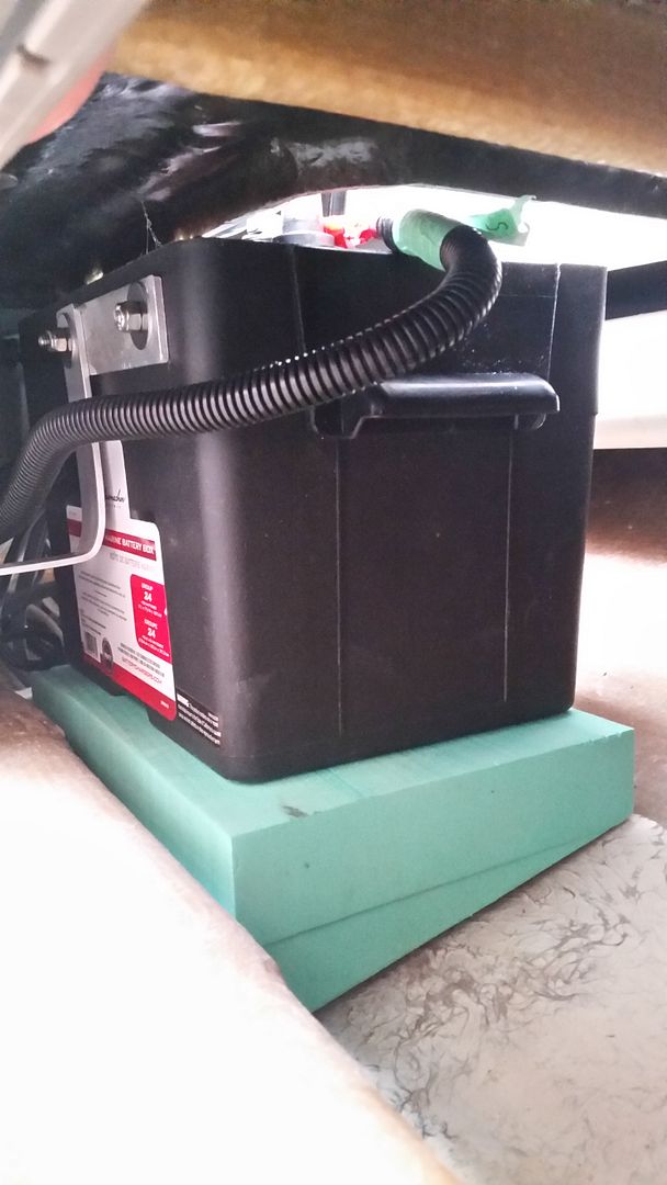

will post pic,s of final install, in the mean time I,m making a new battery box mod to relocate the new starting batt under the aft Port side seat & of course this all requires re-routing a lot of wiring & battery cables :x but luckily when I install wiring I always leave an extra 2ft of wire or so , except for the battery cable,s for the start Batt ! . So that will have to b resolved once the start batt is installed :)

Nice mod but I have never liked wet cells in a tippy boat, too much sulfuric acid to leak out, especially with all your head sails :P
Give me some nice big AGMs 8)

All is not lost the condo building has a tool/work shop down stairs in the underground parking lot besides the bicycle/kayak storage room :P
well I,m off back down there now to finish off my start batt box brkt,s & then off to the boat to install more pic,s to come later

2 questions about the battery isolators ( I think I saw one in the photos).
What happens if you battery on each side are mis- balanced, IE one is at 90% and the other is at 40%? Does most of the charge go in to the lowest one? Or is it split 50/50 even though one battery can't accept it? or is the whole system drops down the the "limiting factor" of the slowest charging( ie fullest) battery?
Also, I read that a isolator can have a .6volt drop from one side to the other. Are you able to measure this or are you otherwise concerned about it?
I am temped to have 2 separate systems 1 for starting and 1 for house load. And a pair of jumper cables should I ever need to connect them.
sailboatmike
Posts: 1597
Location: Australia
Re: Battery up-grade
Post by sailboatmike »
You need one of those fancy intelligent isolation switches that charges the start battery first and then switches over to the secondary battery, was looking at one myself just the other day but seriously doubt I will get that mod done in the short term, many other pressing things need to be done to get the boat better to sail before I worry about that stuff.
