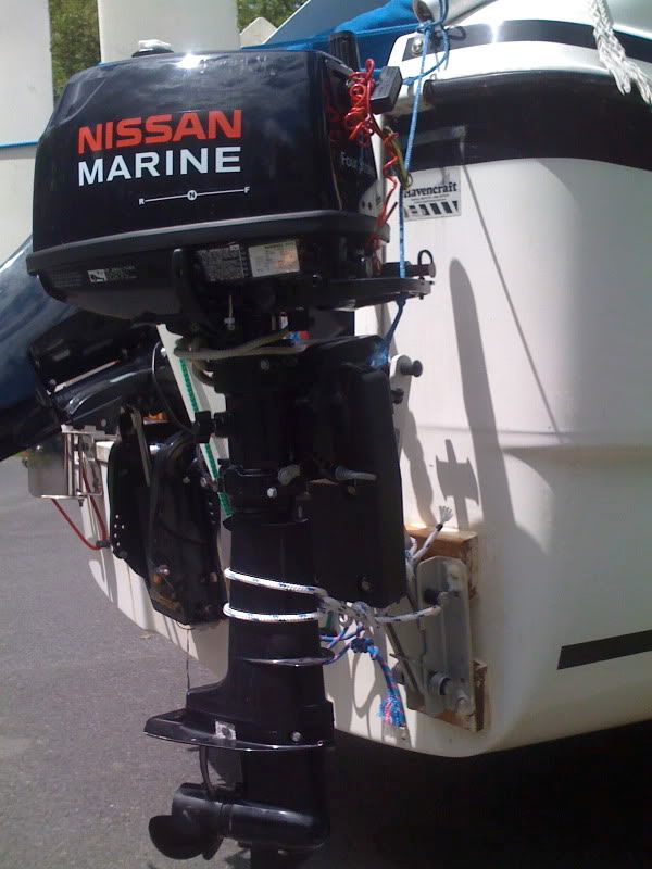

raycarlson wrote:looks nice,hows the steering with 9.9 at full throttle, does it take both rudders down to keep it from wanting to turn to the right? is the 9.9 at 25inch motor, i thought only the 6hp came in 25inch size.

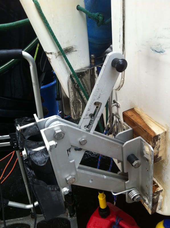

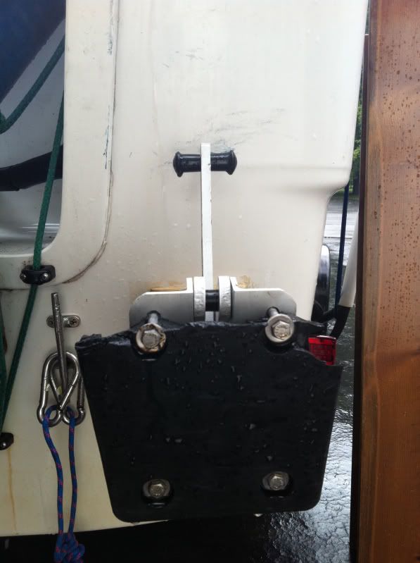

Boy, you got me. This is my first ever outboard. It is a "short shaft". The mount has 14" of travel, which when up with
motor tilted back, the prop clears the water surface by a good 6 inches, and fully submerges past "cavitation" plate when down.
Steering? Haven't tried it yet. Just installed yesterday. My purpose was to have an accessible mount to store the dinghy
motor. The fact it will work as emergency backup is just the cherry on top.
Sumner wrote:Looks nice. How are you controlling the throttle and the forward, neutral, reverse. Have you installed remote controls? I'd still like to do that,
Throttle tension is adjustable. It will hold when let go of (same with direction, which can be locked). Steering will be with one or both rudders. Again, this is just a backup, emergency scenario.
