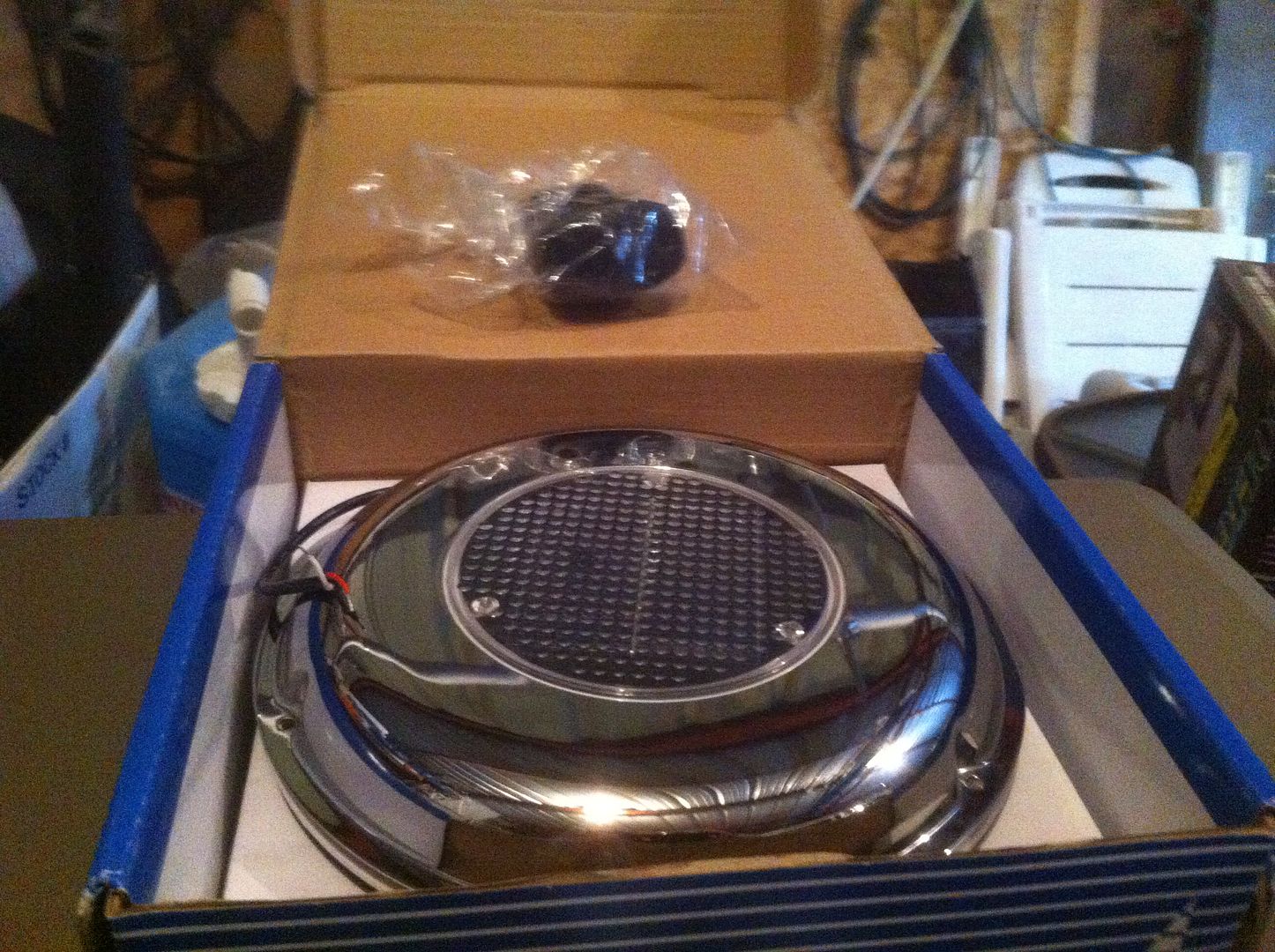

I have one of these 12v/ solar vents too yet to be installed

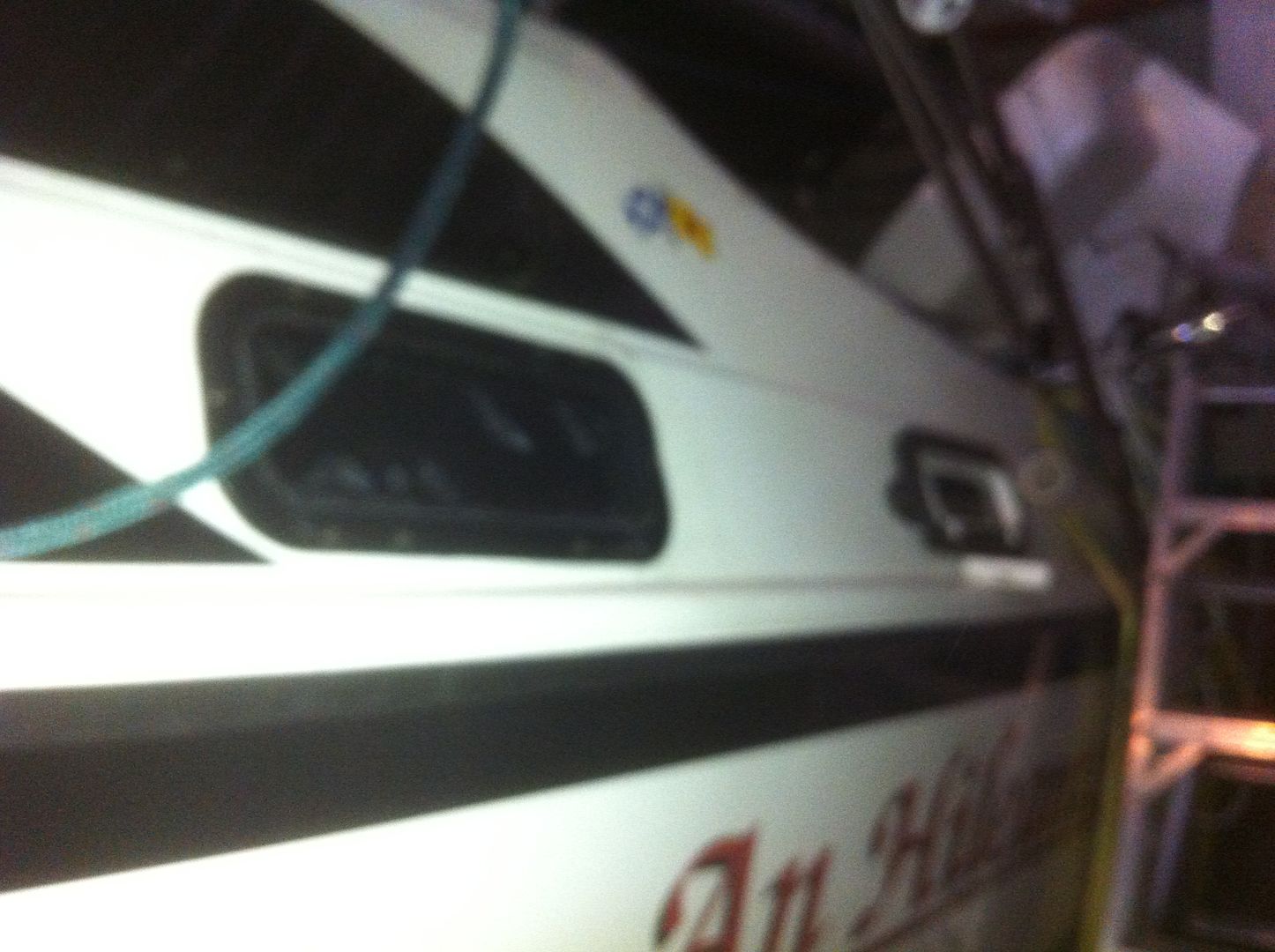

entrance hatch with opening port light
http://i844.photobucket.com/albums/ab1/ ... 89743a.jpg
http://i844.photobucket.com/albums/ab1/ ... e76fbb.jpg
