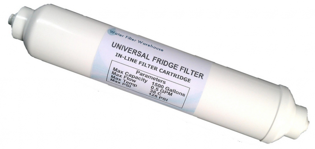

The standard single stage under sink filters that you can get here are carbon filters. They will get rid both of Chlorine and organic compounds. They look like this:

FinallySailing
Posts: 281
Joined: Fri Jul 02, 2010 2:37 am
Re: Water Bladder Plastic Taste
Post by FinallySailing »
Ah, and as my Admiral tells me, she knows them from North America as fridge filters :) .
