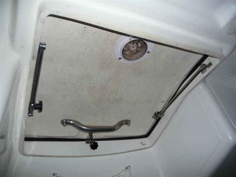

The first hatch positioning strut I added was a help, but not completely satisfactory alone.

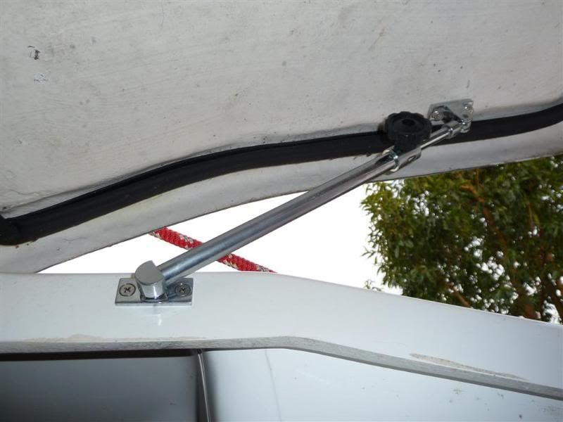

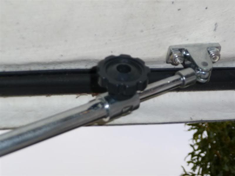

:arrow: I eventally installed a sliding strut fixture on each edge of the hatch, two different kinds. One is a tubular telescoping slider with a threaded collar that controls friction, to allow it to be opened to any extent, and held in place. Has two tubes, one inside the other, and the collar tightens the end of the outer tube to provide the friction. This collar can be adjusted, but it does not work as a positive lock very well, since it only adds more or less friction.
The setting I prefer is with just enough friction to hold the hatch at any given position, but not enough to keep if from being moved by hand pressure. Once I found it this precise setting I prefer to leave it alone, and use a different strut to actually lock the hatch's position.

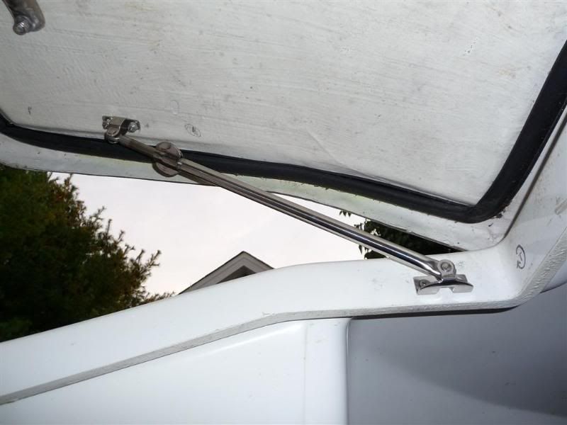

:arrow: The other strut, on the opposite side, is also telescoping, but a looser slider, with a side knob that can positively lock the hatch at any setting, but not as effective at controlled friction. It is better at just locked, or loose.
:arrow: Using both together, the hatch behaves very satisfactorily, being able to be opened just a crack, or anywhere to all the way open almost vertical, withoug flopping backwards all the way, and then be locked in place if desired. There is minimal twist on the hatch when pushed because the two struts tend to balance the resisitance.
:arrow: It is somewhat tricky to get the ajusters mounting location determined, because each strut has a minimum and max length to consider, and the location of attachment on the hatch and on the coaming can determine whether the hatch opens enough.
:arrow: One other feature is that the hatch can be hyperextended past its tubes extension limit, pulling the struts from their tubes, but this will only happen when the friction strut's collar is completely loosed from its threads, and then the hatch can be laid back onto the deck. I just don't ever find it needed to do this, but it can be done.
:idea: The underside of the hatch has a substantial stainless steel handle, both for operating the hatch, and for a hand-hold when lying on your back in the vee berth. Makes it somewhat easier to slide in and out, or lean up a bit, using this overhead handle. It also is easier to pull the hatch shut tight against the weatherstrip when tightening the stock fasterner down.
