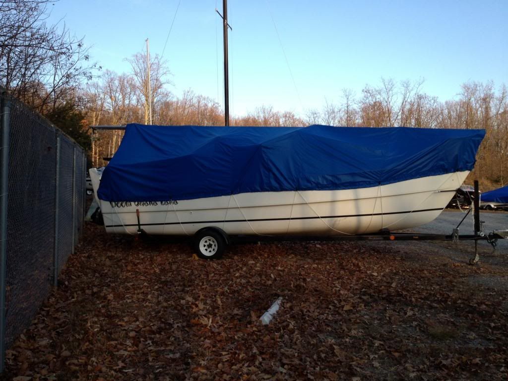

Decided to take the plunge and order a full winter cover from The Sail Warehouse specifically made for a 26X :macx: . Price was $795.00 plus shipping. Easy to put on single-handed, all I had to add was some split tennis balls for the spreader ends and stanchions and the tie down lines. So far it’s working great. We recently had a wind storm in the DC area of 50-60 mph gusts; I checked her afterwards and couldn't tell that it had moved at all! :)
Leif
Port side
Starboard side
