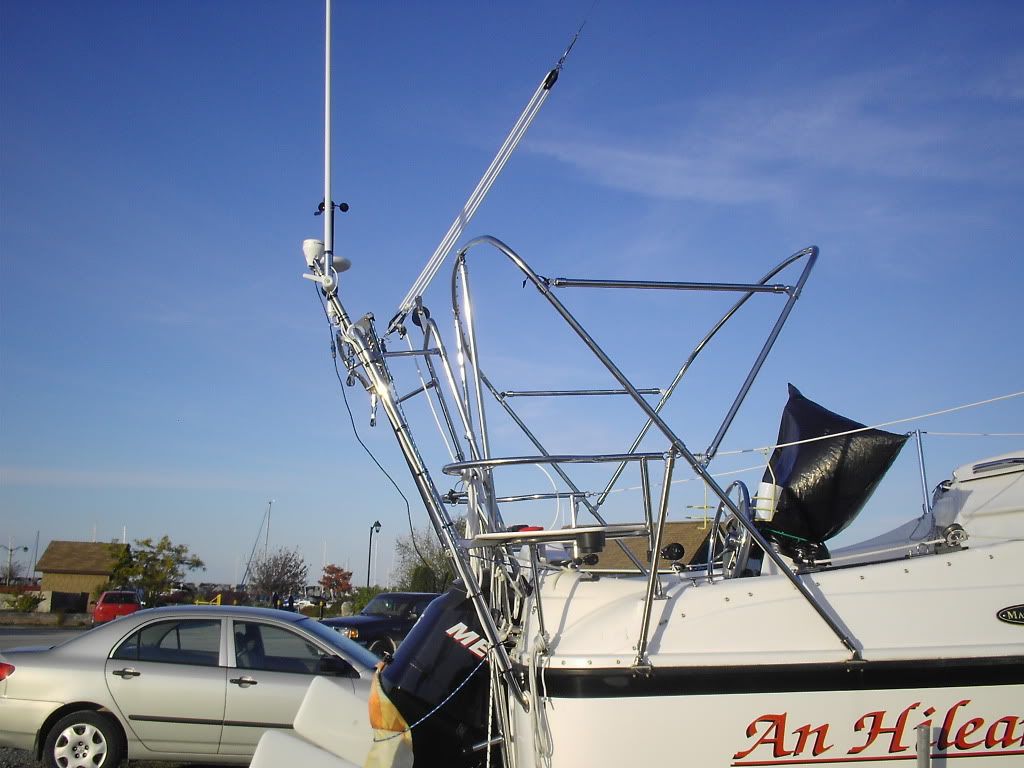

These r mods that should not b taken lightly I studied rigging for 2 yrs so as I could learn how to do this & the cost was not cheap $$$$ even as I only had to pay for the material as I designed the cutter rig & done all my own labour I still had to purchase a second set of :macx: spreaders upper,s r 36" lower,s :macm: r 44" a 3rd set of masthead shrouds a second set of spreader mast brkt.s
two more mast hounds three more forestay,s & furlers plus two 7ft cabin roof top genny tracks numerous extra cheek & car blocks lot more running rigging think eight sets of running sheet lines 4 head sail halyards , original hank on forestay which came as a spare when the boat was bought new is now used as a floating back stay which is mounted on a traveler on a rear arch & the top is mounted on a swivel brkt on the masthead plus a 4ft bowsprit
U can go with a smaller cutter rig by just going with a 3/4 Jib on an inner stay or a smaller storm jib

NiceAft wrote:Won’t backstay placement at the stantion nearest the mast be too accute of an angle to prevent forward movement of the mast?
Ray I think it would b sufficient if u r just using it for a jib or storm jib for heading up-wind the top of the running back stays would b attached to the mast at the same location as the forestay then run down to a block on the mid-ship stantion & then run to an aft cleat at ur desired location
Now if u wanted to use the running back stays for also running a spinnaker then mount them at the masthead & back to the aft stantions on both sides & cleats could b mounted on the genny tracks if u so desired & as u r only using one of the running back stays at any time it doe,s not interfere with the rotating mast & both running back stays could b applied running downwind with a spinnaker one being tight the other just being a bit snug
My system being on a traveler duplicates a running back stay system but converts it into a single back stay system with a single back stay control system so with my system also being a masthead system I have the best of all three worlds :wink:

Mark
U r wrong I still have the standard mac mast but my back stay is attached to a traveler that is mounted on an arch approx 5ft above the aft cockpit thus it doe,s not interfere with the mainsail :wink:
Hope this resolves any miss under standings !
